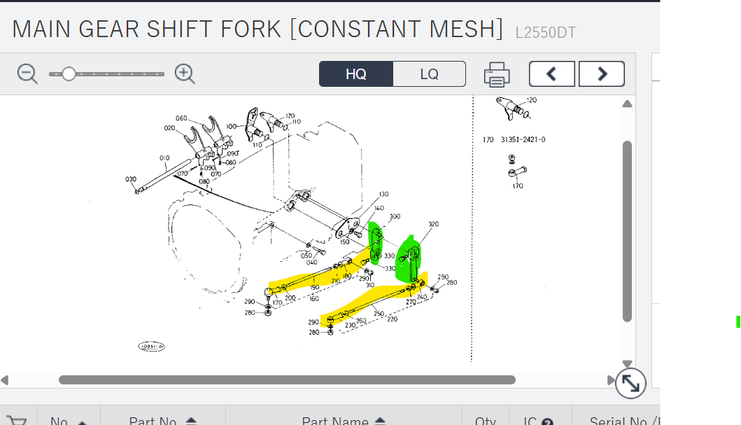

I would pull all three shift linkages and see if you can shift the transmission manually.

As NIW is saying it may be in the linkage before you split it again.

I had some time today after work to look at the tractor. I pulled the trans cover and checked the shift forks for trans and PTO. Everything seems good there, counter shafts spin by hand when not in gear, forks are intact and move as they should. I also double checked the linkages, they seem good (can still engage / disengage by hand with linkages disconnected). Spinning the clutch through the access hole when in gear, I noticed the back tires jostled ever so slightly and it sounds as though gears aren't fully engaged in the rear / axle, so I'm thinking my problem may be in the rear housing. I'm wondering if removing the 3-point lift arm / control valve assembly would provide access to see what going on back there?
