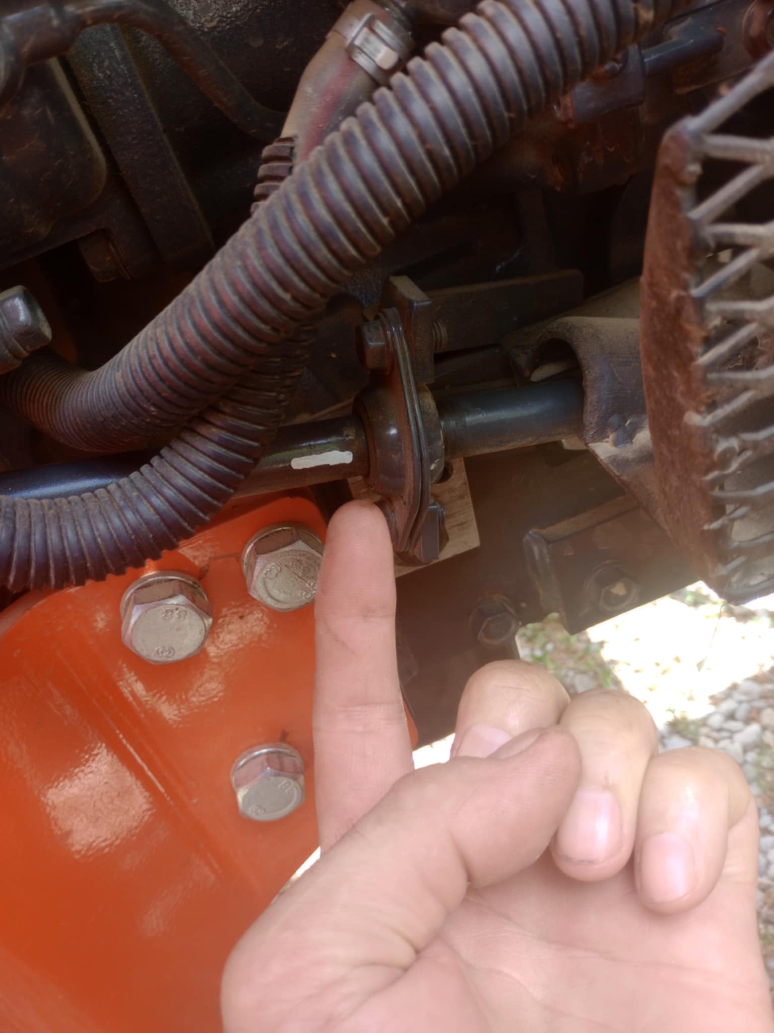

I located a grease nipple on my L2502 that's not listed in the owner's manual or the WSM manual. I have seen it on the parts diagram, and it's on 20+ models. I've also watched several YouTube videos on 50 hour maintenance, and no one mentions it. It's located on "part TC402-18260 Joint Universal". If you follow your steering wheel shaft to the front of your machine it's on the last u-joint. You'll have to bend over and look up or use a mirror. I've found that lowering the bucket and getting the front tires off the ground makes it easier to turn the steering wheel so you can get your grease gun on it. Also, I took a paint marker and made a reference mark on the steering shaft so when the mark's in position it's ready to grease. On the opposite side of the nipple it has a bleeder so you know when you have enough grease. I hope this is helpful & understandable. It's my first post.
