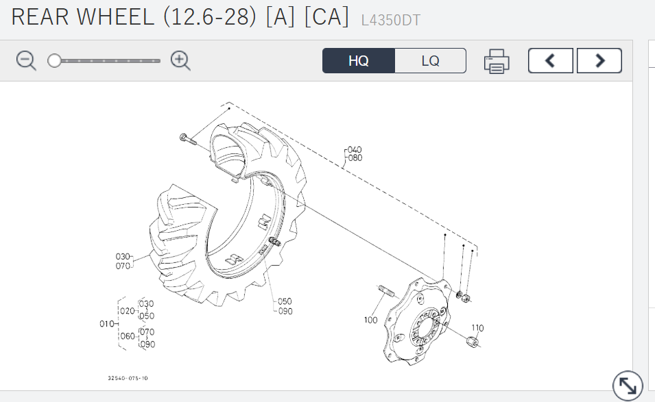

Does anyone know if these rear rim components will fit my L4350?
6 loop rim center
Center hole 4 5/16”
8 lug - 6” bolt pattern
11-28 6 loop rim
12.4-28 ag tires
I believe they will. But some extra reassurance never hurts. Thanks!
