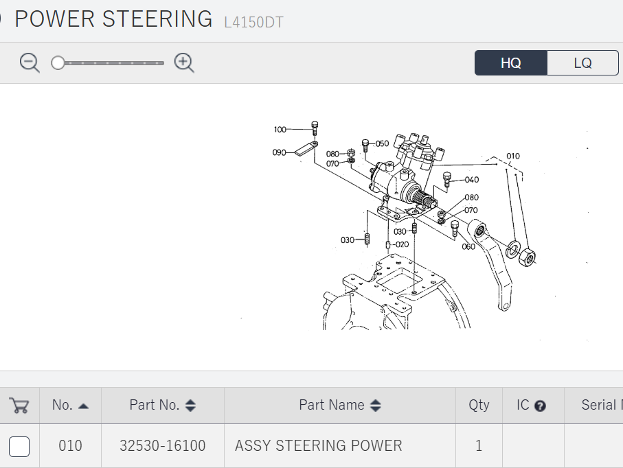

This is what I show for a L4150 steering unit. (3 pictures below)
Part Number: 32530-16100

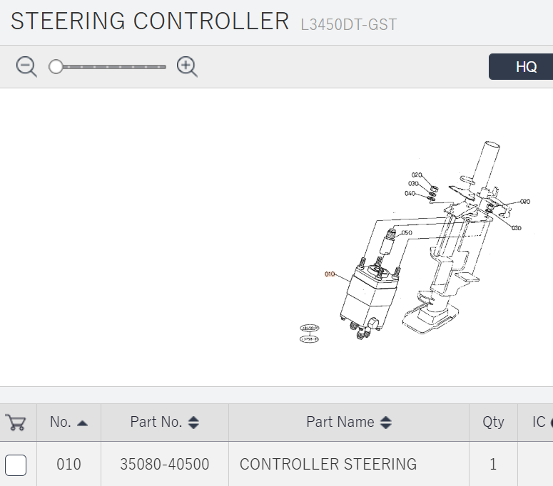

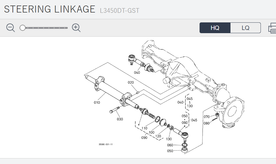

I've included for reference only, what a L3450 with Hydrostatic steering looks like (Last 2 pictures).
Double and triple check that is what your steering gear looks like.

FOR REFERANCE ONLY: L3450 Hydrostatic Steering
