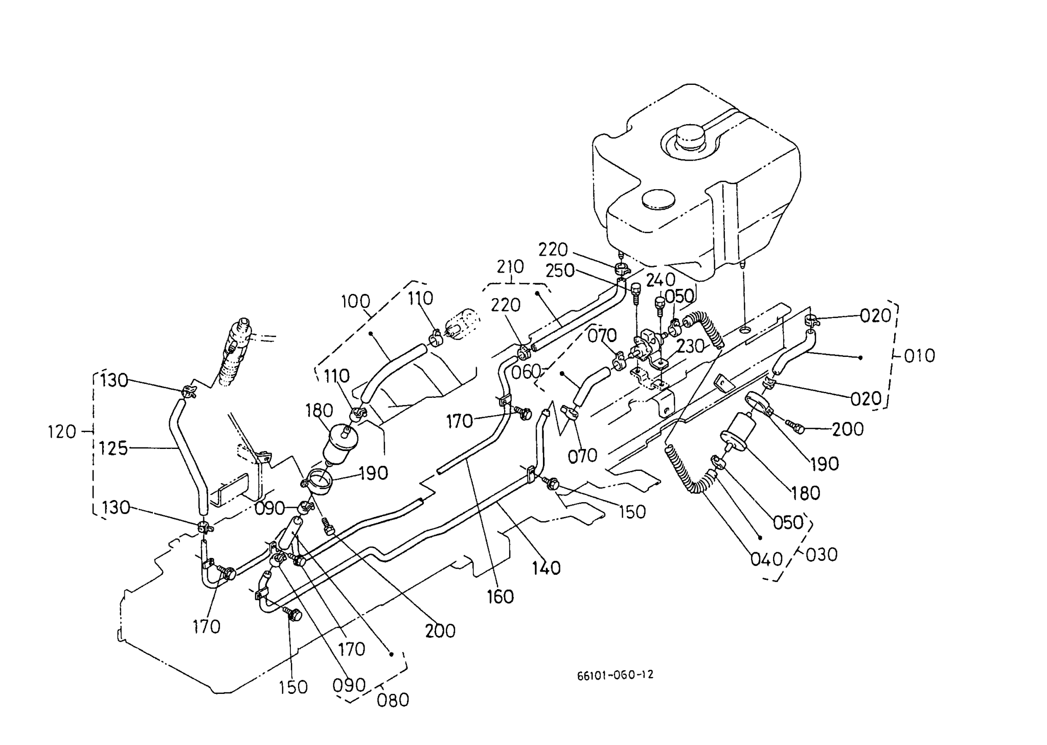

V Vinny New member Equipment G1900 Jun 30, 2025 1 0 1 UK Jul 6, 2025 #1 Where's the 2nd fuel filter located on my G1900? I've changed the obvious one under the hood but I've been told that there are two that need changing. Thanks all.
G GreensvilleJay Well-known member Equipment BX23-S,57 A-C D-14,58 A-C D-14, 57 A-C D-14,tiller,cults,Millcreek 25G spreader, Apr 2, 2019 12,920 5,647 113 Greensville,Ontario,Canada Jul 6, 2025 #2 curious was I , hope this helps... from kubota canada parts website...
