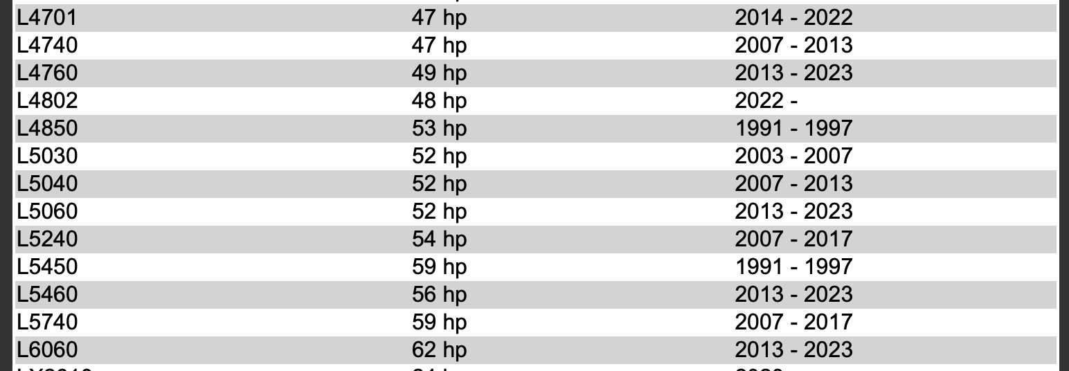

If you're looking older, then it's L or M. If you want HST, then I think older Ms (even newer Ms) don't have it. So, L it is.
I think your options are L5030, L5040, maybe L5060 (not sure about emissions), L5240, L5740, maybe L6060. It looks to me that the Lxx60 have EGR, so it's not full emissions but it's some.
I'd be surprised if most of them didn't have electronic controllers of some sort, they're all direct injected.
