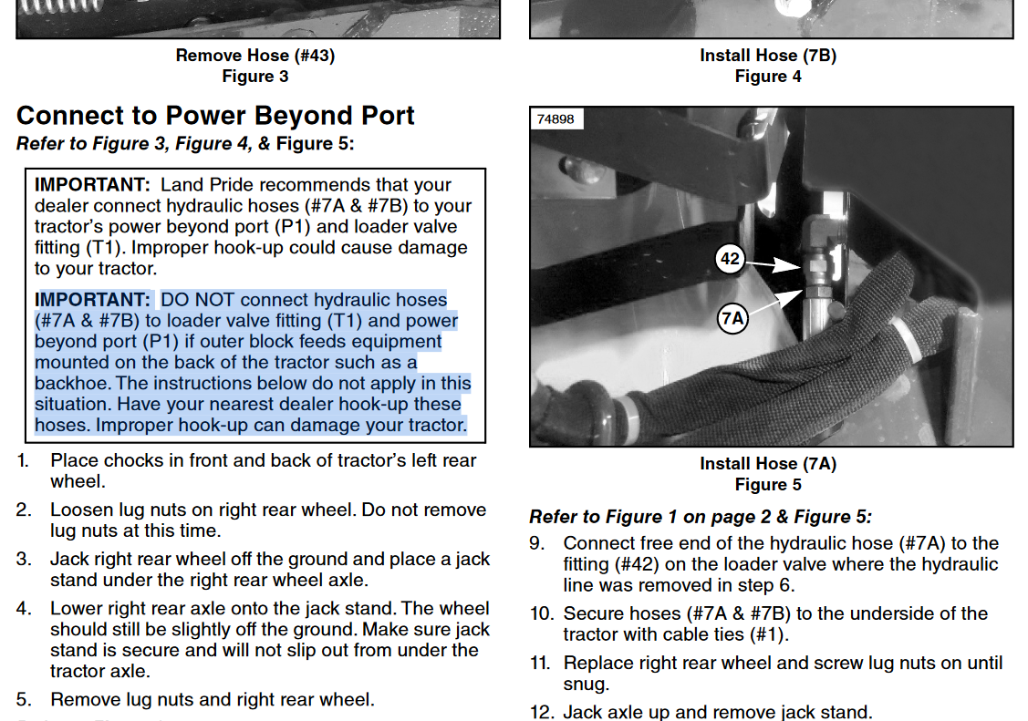

I asked about the backhoe because they specifically state in the instructions don't connect if the outer block feeds the backhoe. This may be more for the BX2380? Or maybe an aftermarket setup?

I will be the first to say that I don't understand hydraulic circuits, however, I am able to follow instructions, especially when the instructions are accompanied by very good color pictures. Installing the unit was a walk in the park, and couldn't have been any easier than following the instructions.

If you fully read and understand the Land Pride instructions, you would understand that the 3rd function valve is permanently mounted to the tractor and that when the loader is removed, you just disconnect the two couplings on the 3rd function valve and the hoses that go to the front of the loader stay on the loader. Another benefit of the 3rd function is that you don't have to deal with hooking up and removing an electrical connection with the associated issues of maintaining the electrical connection from failure. The electrical connection is permanent and you can use the third function valve for other purposes, such as operating the hydraulic cylinder that moves the hood of the snowblower chute up and down.
It doesn't matter to me which unit you choose, or if you never add a 3rd function or a diverter valve to your tractor. That is your personal choice in life to make. Just because you don't see the need to both close your grapple and at the same time curl it, doesn't mean that someone else might want that feature. We all make choices in life that fit our lifestyle. A 3rd function vs a diverter valve gives the operator greater choice at no additional expense.
