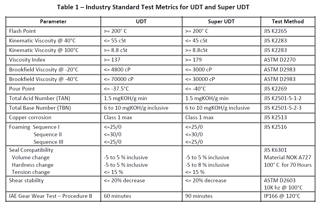

If you look at your owners manual it will tell you SUDT2 is "highly recommended" and regular UDT is "permitted for use". Nowhere does it say other UTTO products are "not permitted" because Kubota knows that's a bridge too far.
Hygard Low-vis (J20D) and SUDT2 are very similar oils at very similar price points.
Hygard (J20C) and UDT are very similar oils at very similar price points.
Post #78 in the thread linked below lists the actual properties of UDT and SUDT2 that I posted a while back . That thread is very long and should tell you all you need to know about how people feel and think on this subject
Personally I only have Kubota equipment so its easy to simply use SUDT2 and avoid all of the kerfuffle. If I had a large mixed fleet I would have to consider the pros and cons of alternatives. Apparently you have already done that with your mowers.

Here is a summary of the actual properties of UDT and SUDT2 I posted a while back - that thread is very long and should tell you all you need to know about how people feel and think on this subject

There is very little differrence in different brands of traditional UTTOs and that includes UDT.
SUDT2 is clearly different - I pointed you to the data but in case you could not find it in that thread here it is again.
Missing from that table is the ability of SUDT to absorb 1% by volume water without forming filter and valve clogging emulsions, sludge, of percipitates. That is something conventional formulations can not do.
