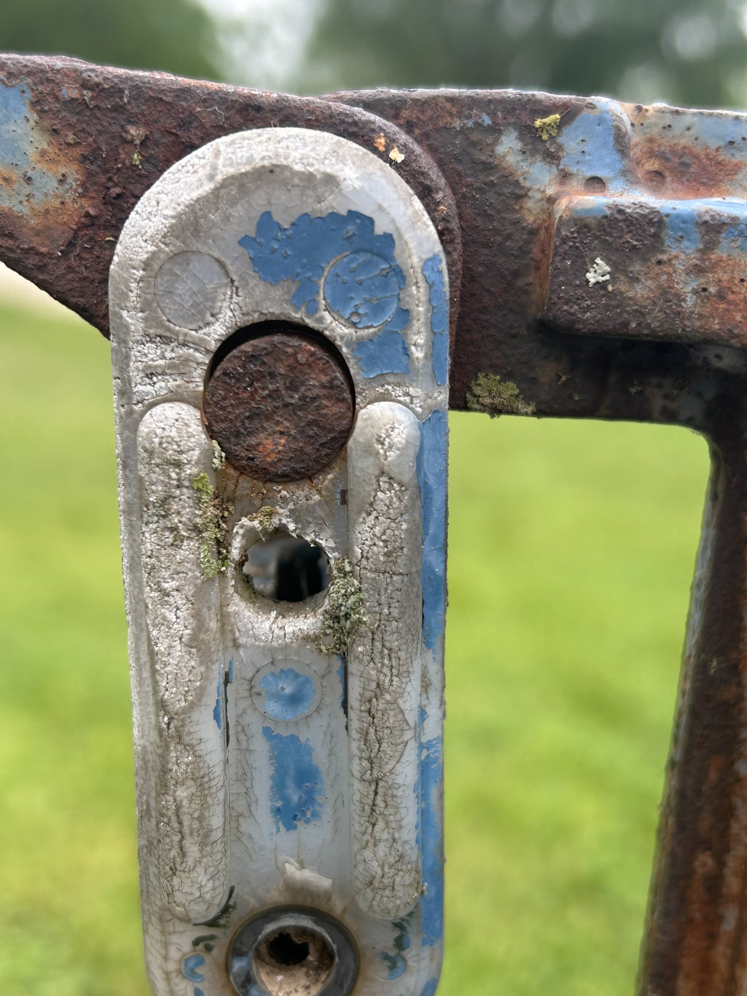

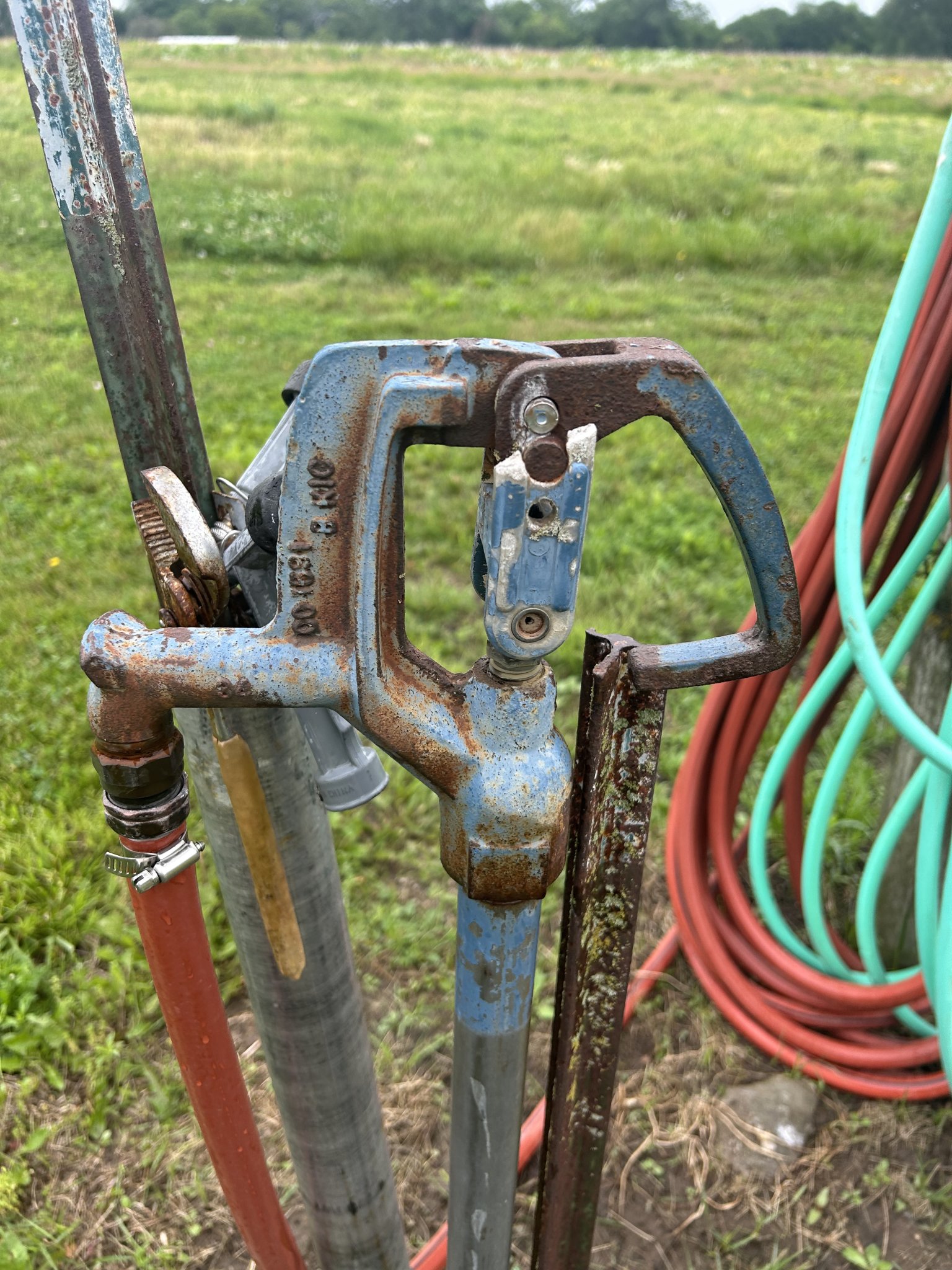

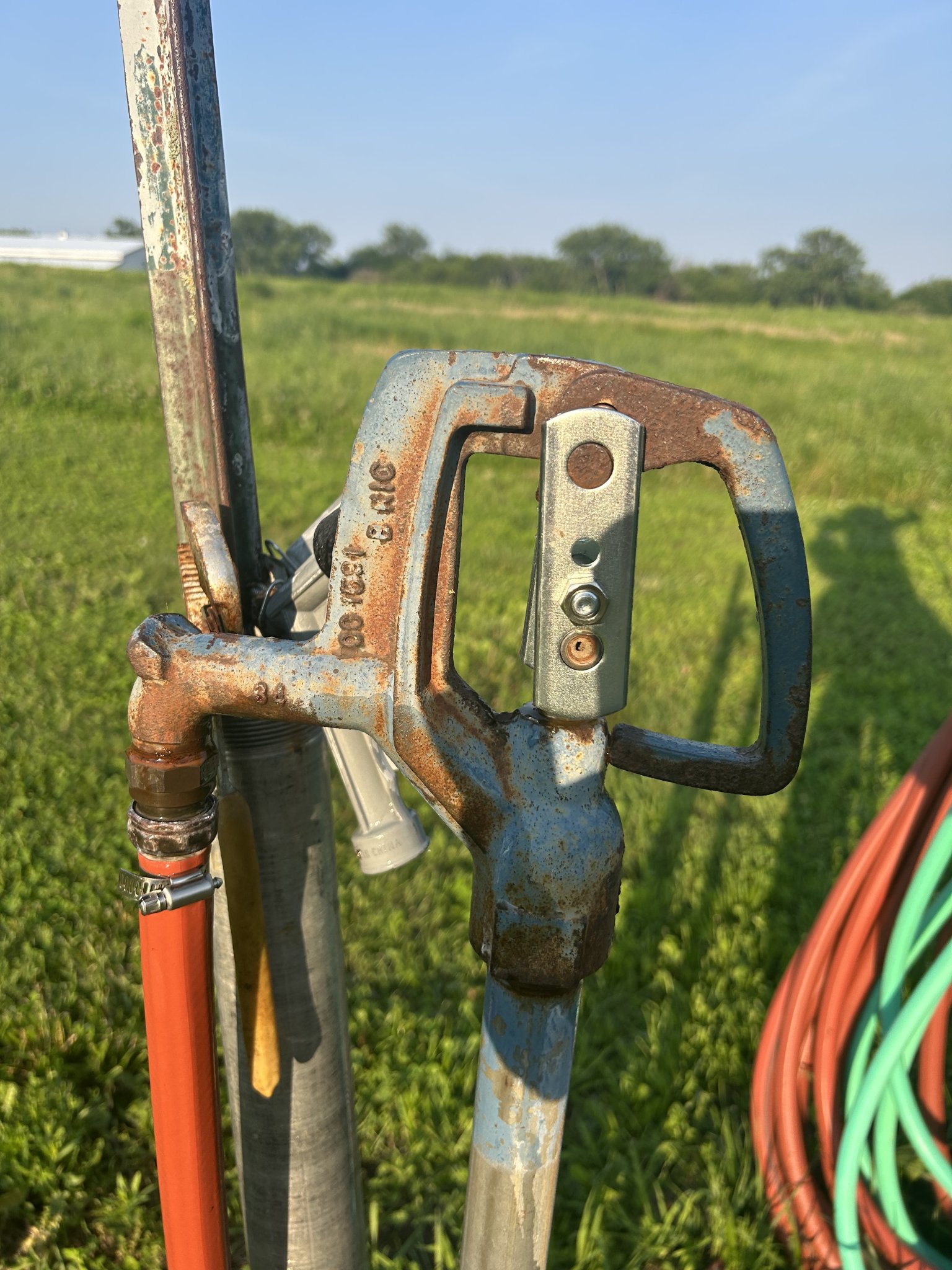

Hey Folks,
I'm looking for some advice on my water hydrant. The handle on the head is old and starting to break ( one side broken ). It still functions for now but needs some muscle to lift and close. One of these days it will be broken all together and I'll have an emergency on my hands.
Any advice on leaving the stem in the pipe and just replacing the head ( which I sure will be a bear to remove )? Or, should I replace everything once I have it apart? I'm not a plumber but can handle the basics.

I can't make out the brand, but some brands have all of the replacement parts. Some are made to replace parts without digging them up.

Without getting the same or exact compatible hydrant head, no not an option.
Looking at that top section of that hydrant, I can only imagine what condition the pipe and rod and the actual valve (which is at the bottom of the hydrant) are.
So replacing the entire hydrant is a much smarter option.

Depends on the brand.
I rebuilt mine (Merrill Mfg C1000) without digging twice over 30+ years, kits were available for cheap.
($11-$12?)
Unscrew the head, change a couple seals, o-rings, and a plunger, re-assemble & re-adjust.
But my neighbor had another brand and we could not find kits for it.
He had to dig up & replace it.

It’s a Woodford model K1C. They look to be one of the more common hydrants. I’ll look for parts and replace the whole thing if I must.

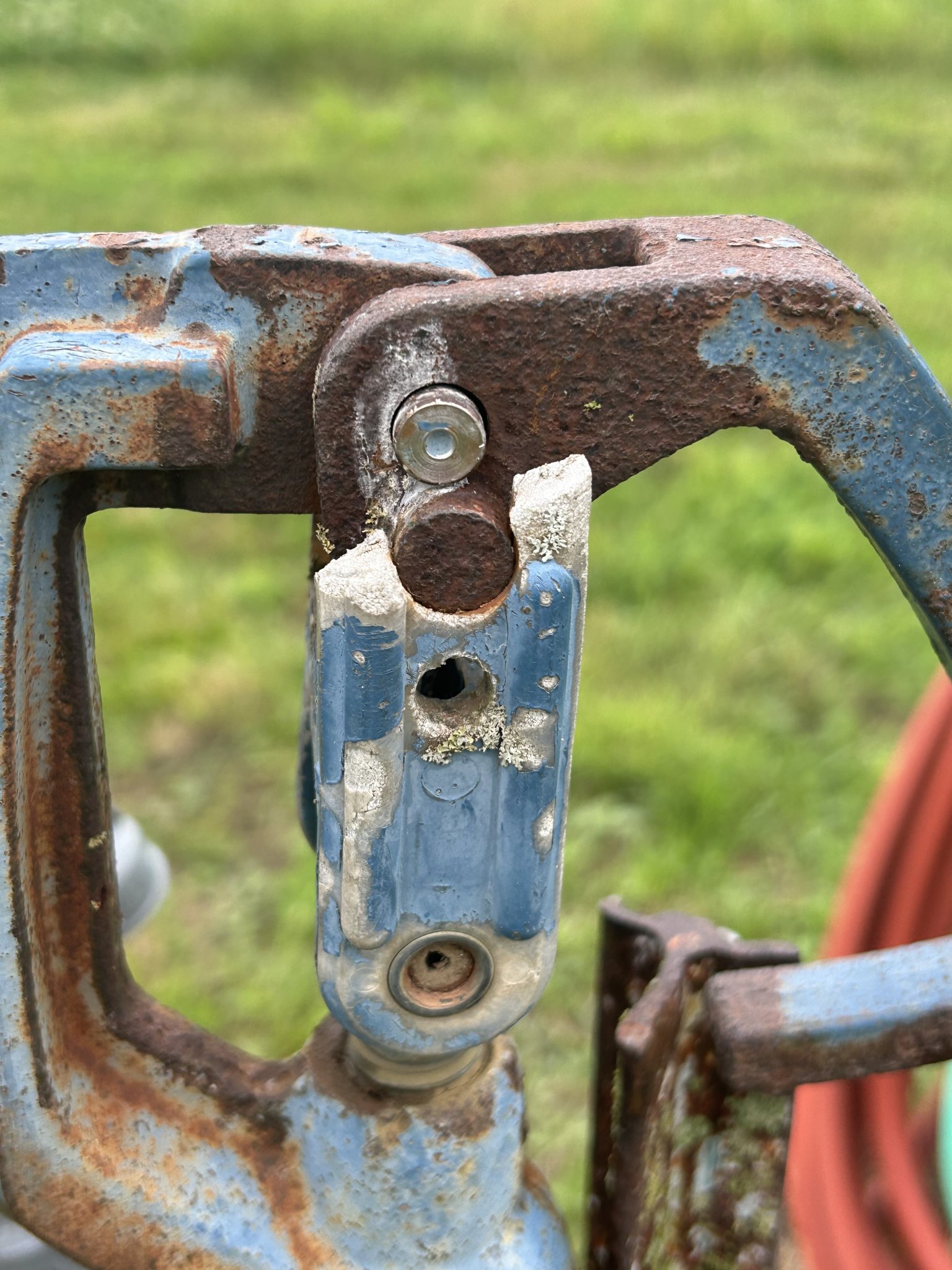

Replacing the whole thing would be best to insure many years of trouble free operation. However, being a frugal DIY guy I'd try a repair kit first. If that doesn't work it won't be a major cost.
The closeup picture leads me to believe that the real issue is corrosion of those links because of dissimilar metal. Iron and aluminum interface out in the weather? As others have mentioned, you can't be certain of the condition of the hidden parts. You mentioned that it's hard to operate. That is likely because something you can't see is in poor condition. Or it could be that the broken link and some "unpleasantness" where the rod comes through the top.
