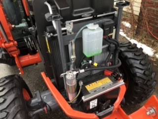

As long as the engine is cold, AND the radiator is full that is not currently a problem. I would get the level up to the lower mark when cold though.

Not fully warmed up but it was that way after about 10 minutes of use. I’ve seen new tractors get a coolant air lock when the dealer tops them, and they end up not being full.
I’ll check the rad when cold.
