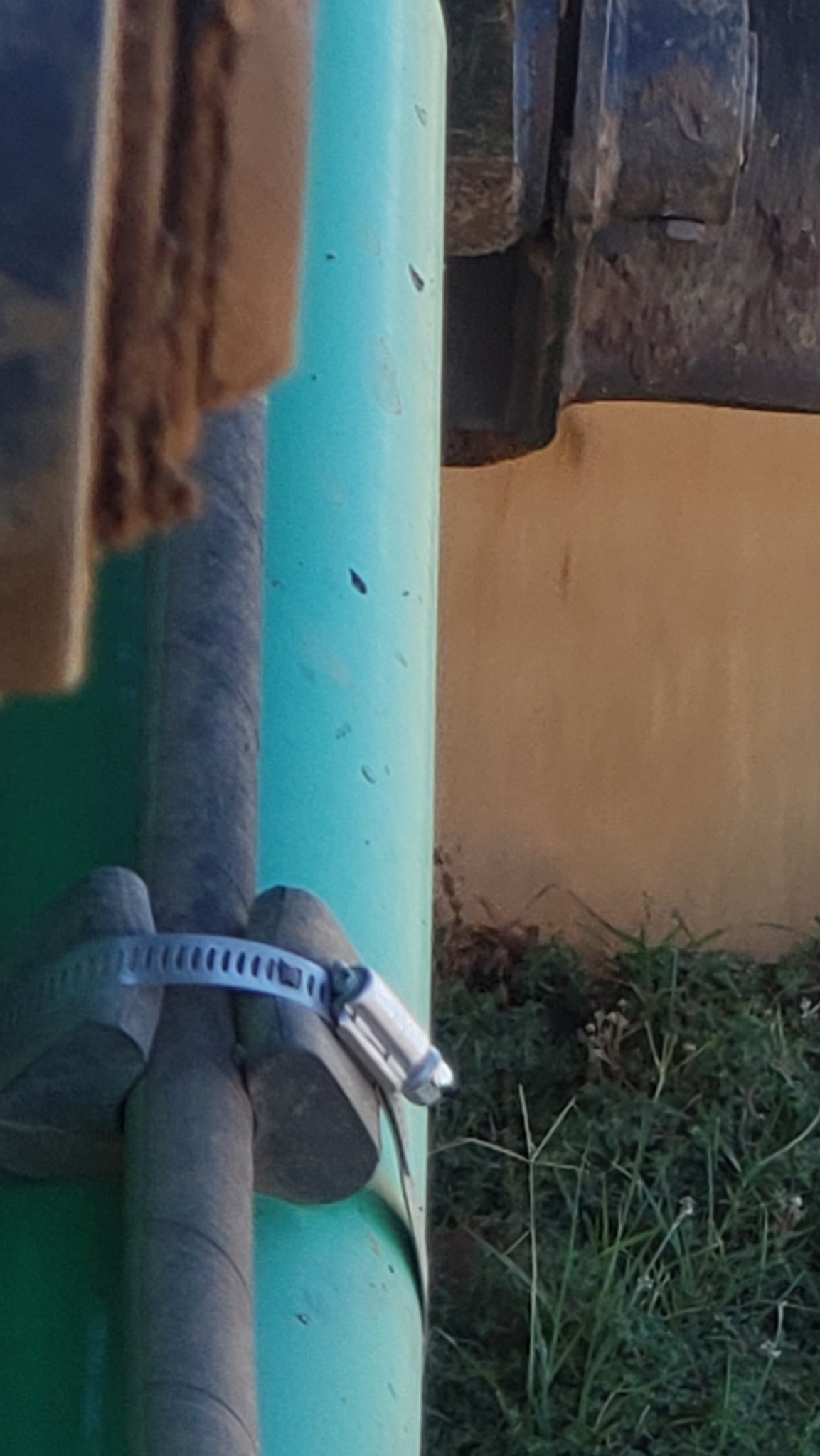

I'm taking delivery of an L4060 in a few days and I noticed zip ties from the factory securing hoses to cylinders.
While probably fine for a few years, I have seen a better way (photo attached) but unfortunately I cannot find the name of that rubber boot protecting the hose under the pipe clamp.
I'm hoping someone here knows the name of those and perhaps where to get them. Hopefully this helps others too, thanks!

I have never seen them.
Kinda looks "homemade" to me.
But there are lots of very knowledgable people here so if/when I am wrong, I'd also like to find out what they are called.

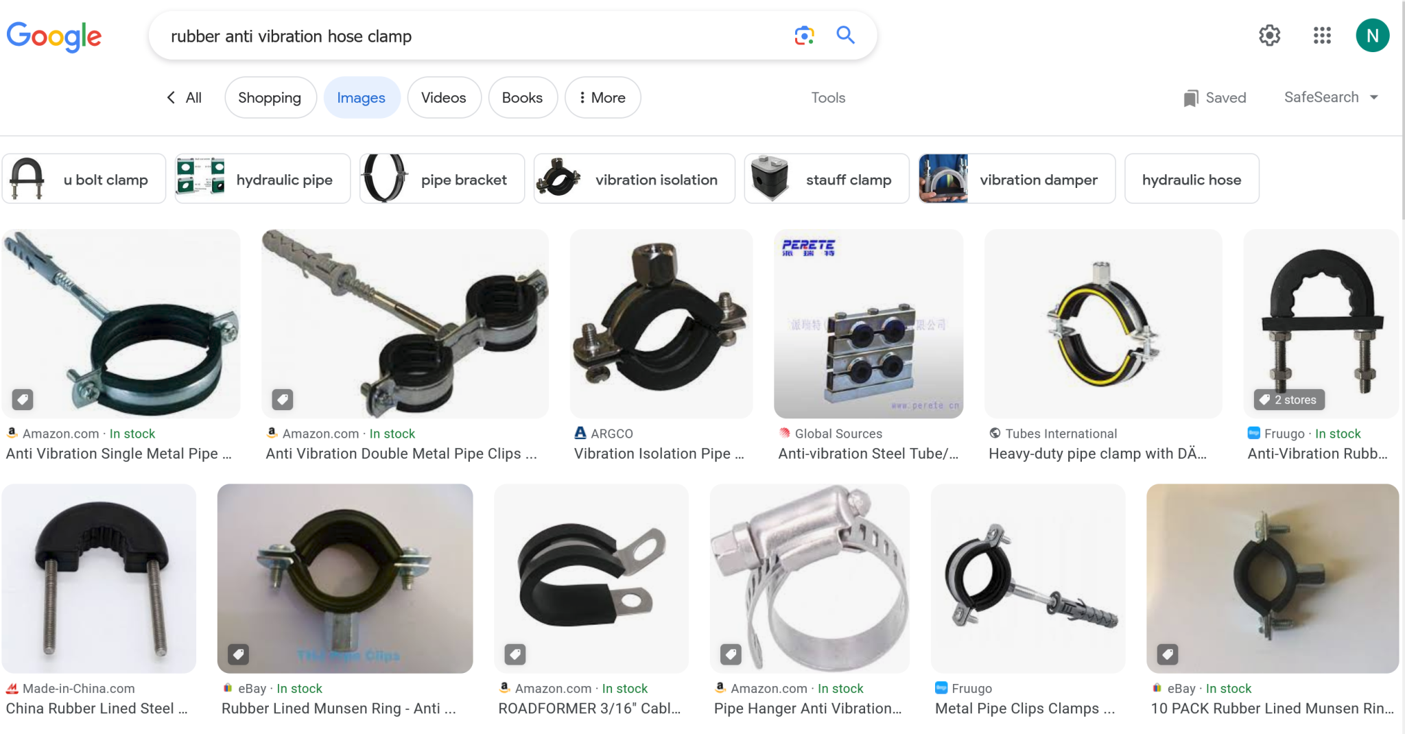

This was an interesting search.
I used "Rubber anti vibration hose clamp" and came up with a bunch of stuff.
Like @Runs With Scissors I think it might be home made.
The radiator clamp certainly won't protect the paint in your picture (if you care).
Some folks just split some rubber hose and it works just fine. Like maybe a piece around the hose and another for around the tractor cylinder (or whatever).

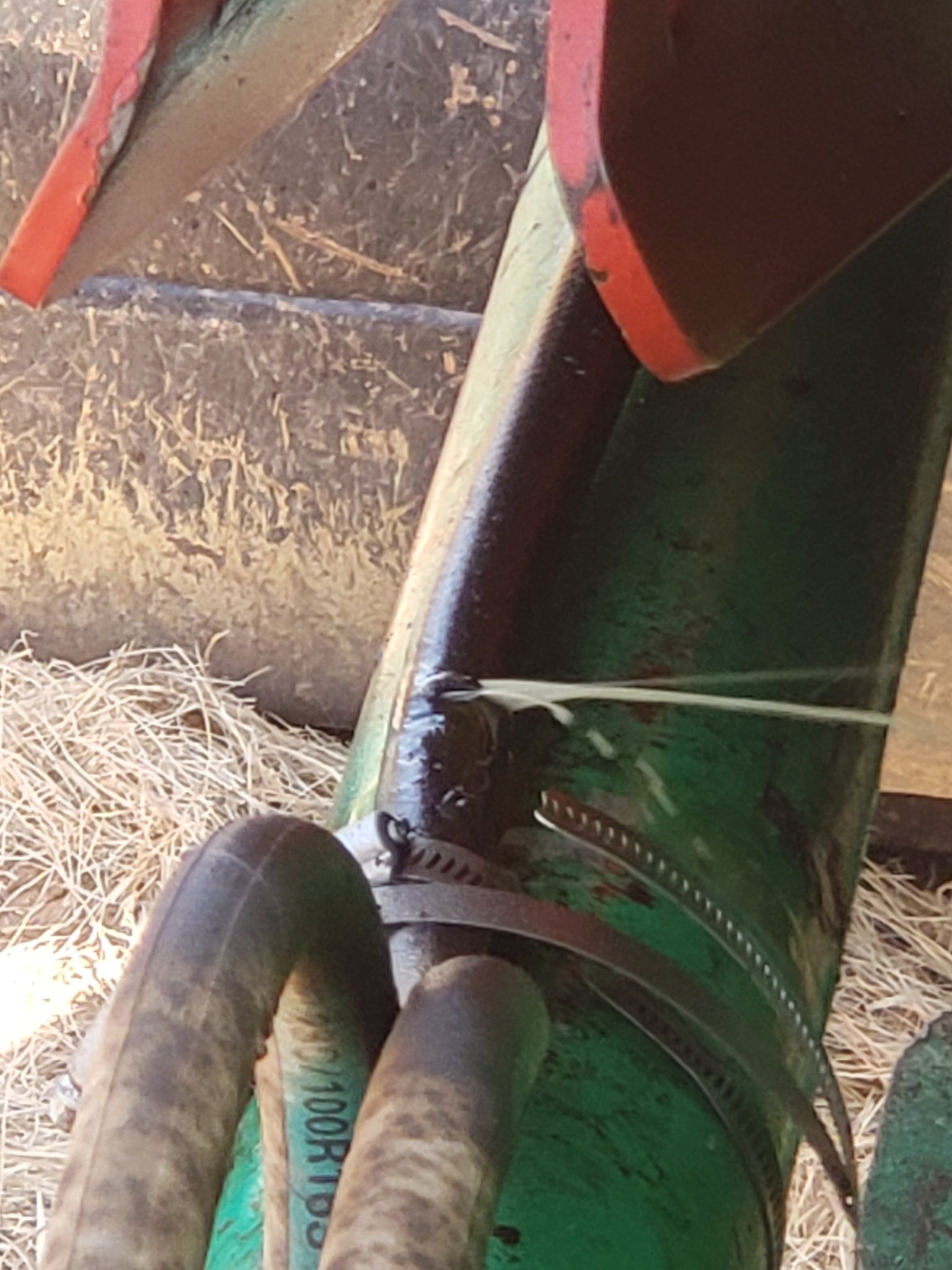

Right, the vinration and slight movement of the hose when its working is killer. I actually damaged the hose on the other side with normal use. It didn't have any protector for the hose clamp

Right, the vinration and slight movement of the hose when its working is killer. I actually damaged the hose on the other side with normal use. It didn't have any protector for the hose clamp View attachment 115500
I should clarify this was a rental machine that came this way. One side had that 'boot' and one side did not
Splitting hose is a good idea! I do care about the paint. I hear kubota paint leaves some to be desired

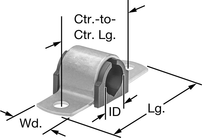

Closest I can think of would be using the cushion part of a 2-hole vibration dampening routing clamp.
