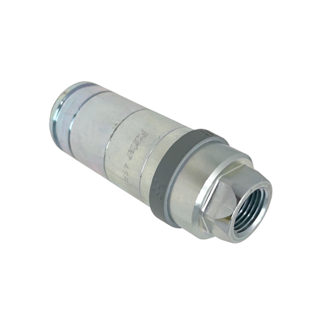

For agricultural couplers I like these - ISO 5675 compatible, sleeveless push/pull connect under pressure.
7,509
4,783
That sure looks good, but at my age, I ain't gonna replace all my couplers at $55+ tax+ship.
