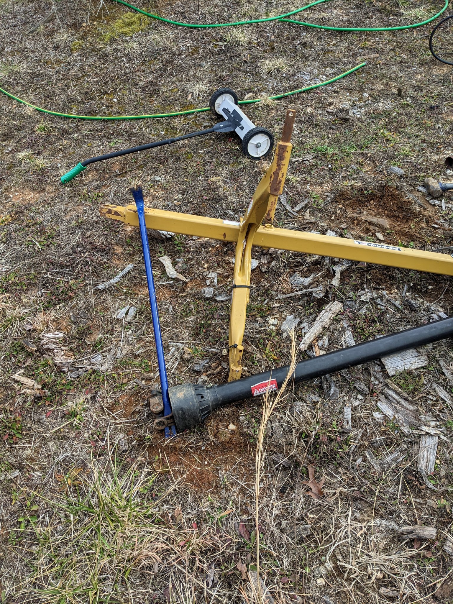

So, Eureka I figured out how to get the threaded auger shaft off. I finally had to wedge a crowbar into the pto shaft end then turned the shaft until it was against the top bar of the auger attachment like shown in the picture. Then I was able to hit the side of the auger bits with a sledge hammer and it finally broke free. What a pain in the ass and hopefully I didn't screw up my gear box. Desperate times. At least now I can just go get a new shaft for it. Stupid because it only needs the cutting edges, but the cutting edge replacements are almost as much as a new shaft anyway from what I've seen.
I'm sure there is much simpler and easier way to do this, but I had to get it done.
