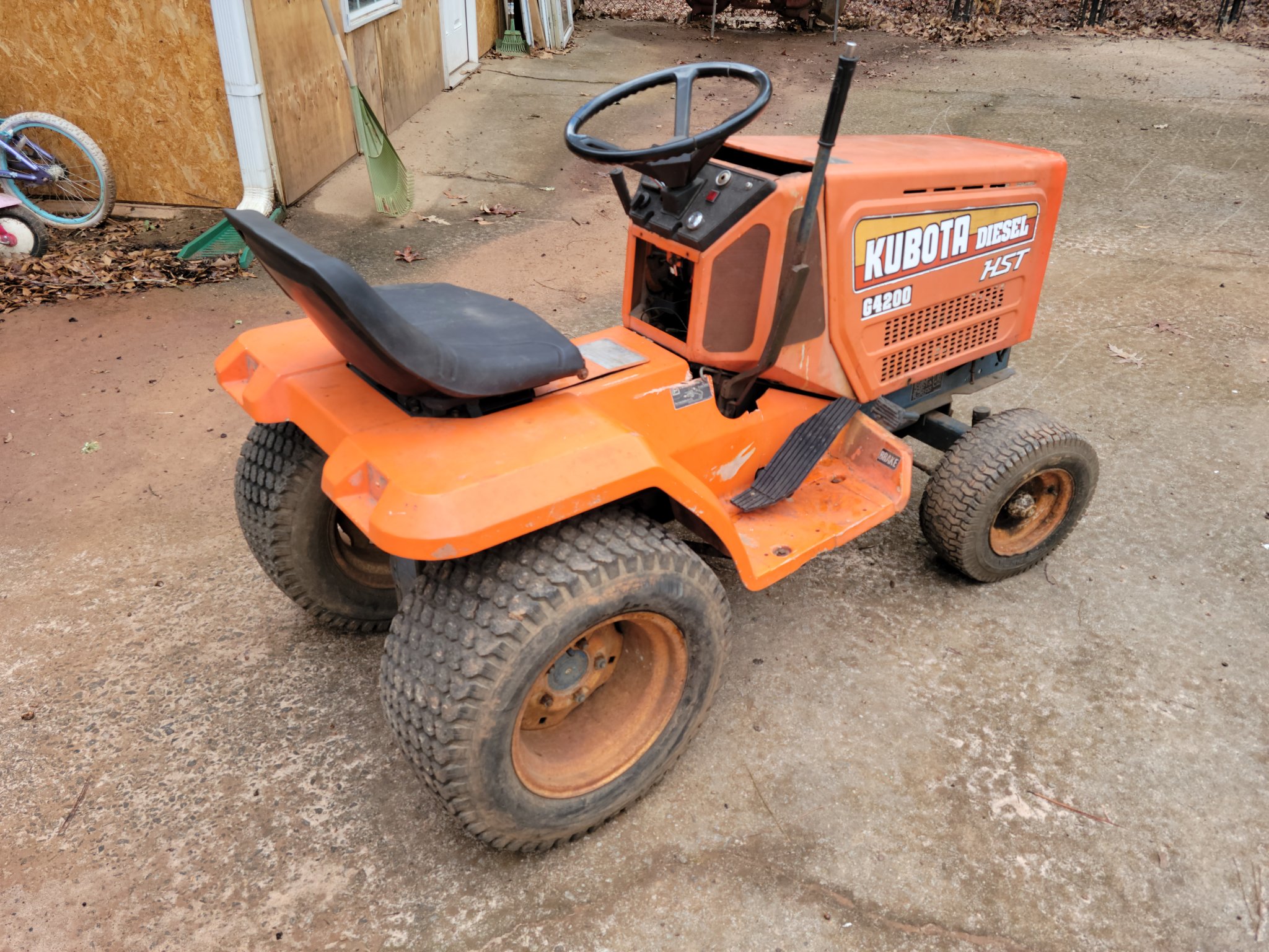

One 4200 I got the previous owner cut the front to get around the pedal and then bolted it back together with a sheet metal and bolts. It was ugly but it worked. I would only do that as a last resort. You can see from the picture that it's a vertical cut down to the pedal and then straight out. They had it put back together where the rubber was originally help down.
