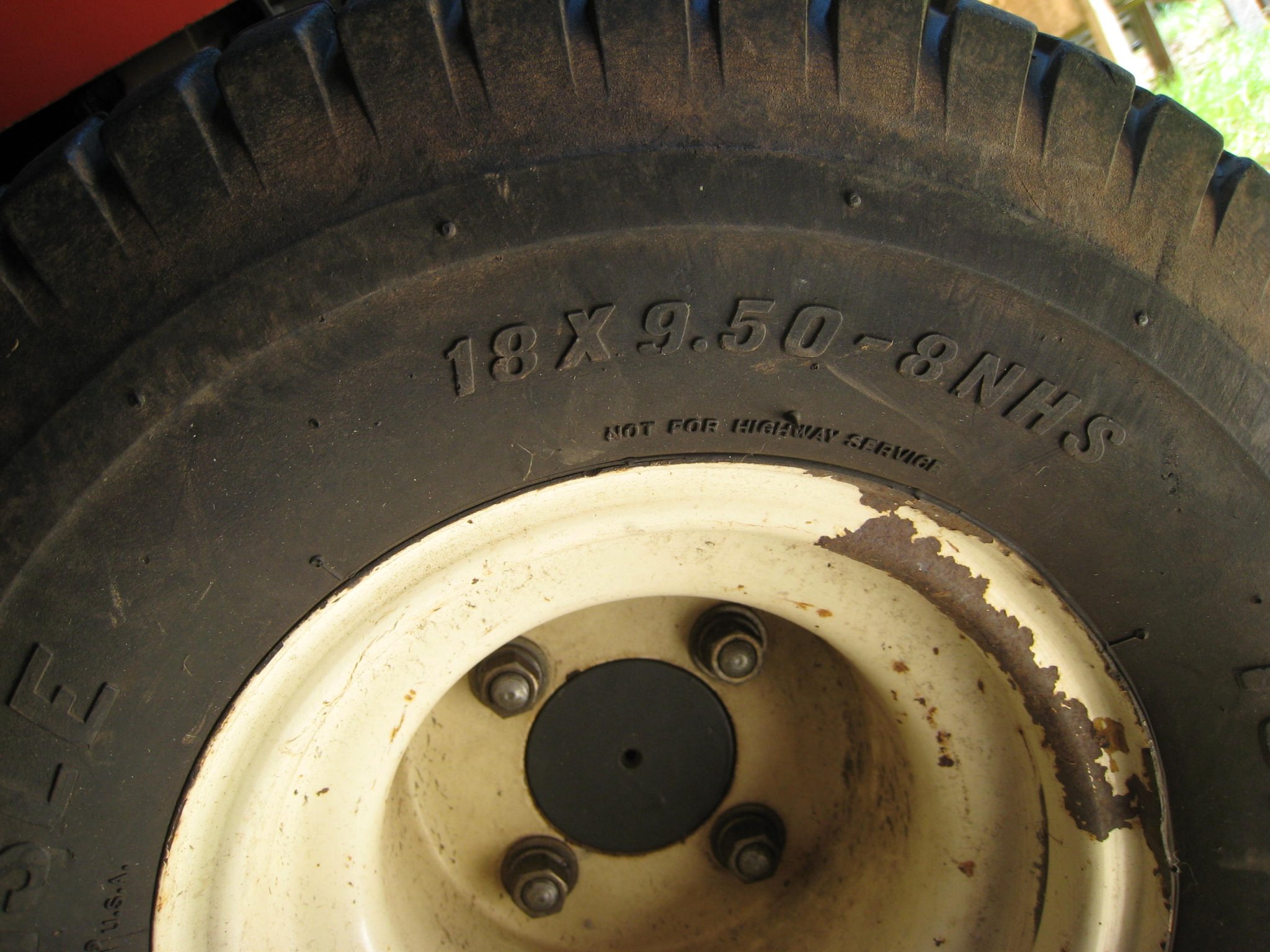

I have an F-2400 4wd mower.
Original tires are front 23 x 10.5 - 12, rear 16 x 6.5 - 8.
Proposed tires front 26 x 12 - 12, rear 18 x 9.5 - 8 using stock rims.
I want the stability of the wider tires.
I know the rear rims are 6" wide, not sure of the front.
Will this work or will narrow rims be a problem? Thanks for any help Laddie.

Sorry, I can not help you much but would suggest taking one of each rim as is to a couple of good tire shops and let them hopefully give you good advise.
They probably are at first inclined to try to sell you what they have on the shelve so you probably need to say you are in no hurry and are willing to wait for the proper tires to be shipped in.

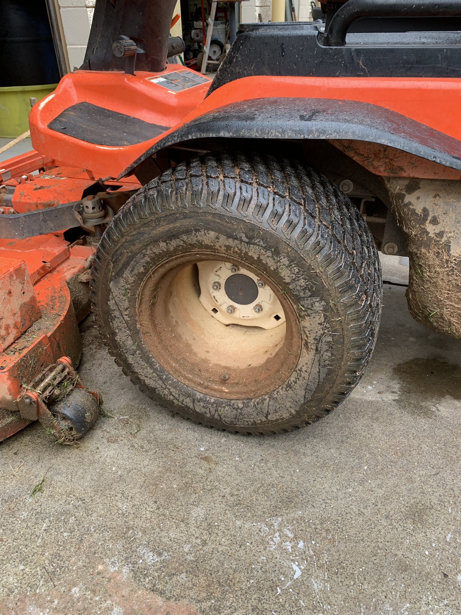

Here is what my F3060 has (Yes, my rims need cleaning up and repainting!):
Front: 24 x 13 - 12 Rear: 18 x 9.5 - 8
No idea what the rim sizes are, but according to my owners manual the tires are supposed to be:
Front 23 x 10.5 - 12 and Rear 18 x 7 - 8

F mowers at work, 2690 and 3680 are 24x12x12 front and 18x9.5x8 rear. And yea, they got the good out of the rears.
@laddie I don’t know if a 26x12x12 would fit. May be too tall.

Thanks, I just got this mower. Your rear tires look almost double wide to mine.
I think I will get 24 x 12 - 12 & 18 x 9.5 - 8.
I can't find 12 x 13 - 12 at a reasonable price.

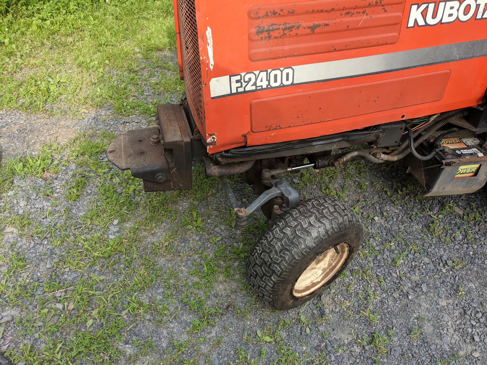

I had the new front tires 26 x 12 - 12 mounted.
I read in the manual the rims are reversible, I added 1 1/2" spacers.
Now the front tires are at least 9" wider stance than original.
The backs are 6" wider.
I also installed a Sun 210-f Lev-o-gage Inclinometer.
