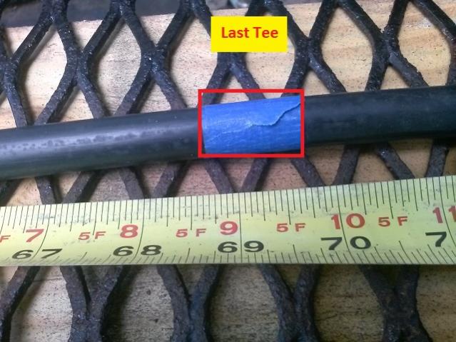

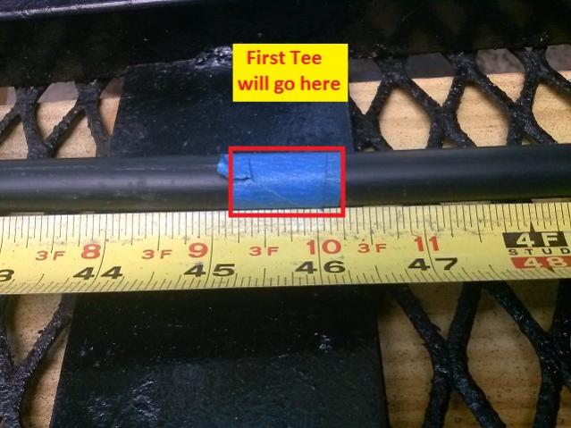

Use a garden or air hose, you can dress/tie it in real nice just like a hydraulic hose, then mark it with tape or a sharpie. Once your happy remove it, lay it out straight and measure.

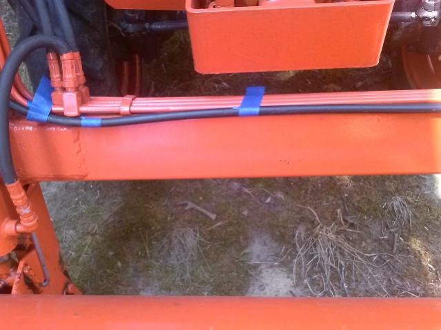

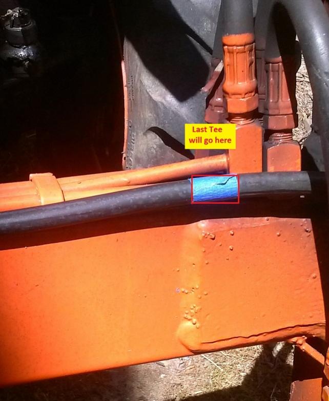

First off, I didn't want to waste the wire ties; I used tape (I think you kids call it "painter's tape"). Used it to mark the lengths, as well as to hold the hose in place.
I had some salvaged garden hose that was thin enough, but recalled a salvaged length of air hose (low pressure) that was more ideal for snaking and bending...
So, starting at the control block

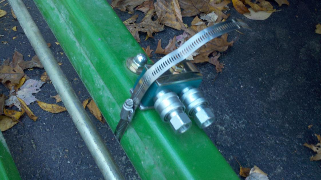

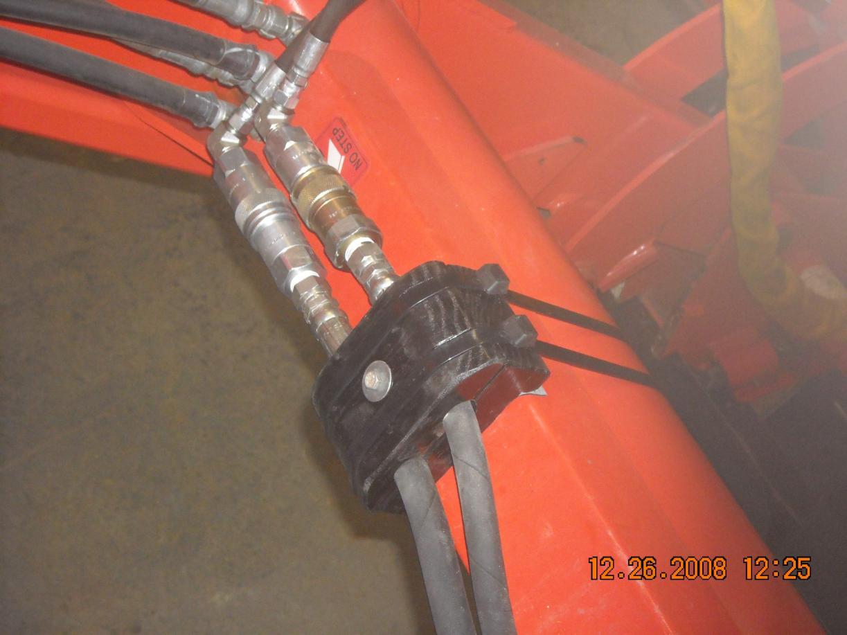

Generally, for the new circuit to operate a grapple or snowplow there is a "bulkhead" mounted on the front of the loader, either one of the arms or more commonly on the center of the torque tube. I'll attach a few pics to give you an idea. It does not need to be fancy, I've seen everything from bungee cords to custom CNC brackets used.
The simplest is the one with two 1/4" QD's clamped in a double tube clamp, and held on with a large hose/worm clamp. I have those parts in stock if you need them.
