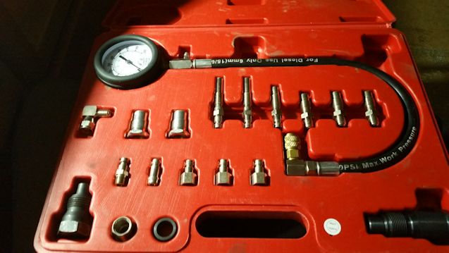

An update: I finally was able to fab up a fitting to check compression in the cylinders. Each was at around 180-200psi. With some oil added, one cylinder got up to a little over 300psi, but the other two didn't improve dramatically.
I was not able to pump air into the cylinders to try to figure out where it was leaking. The compression fitting I ordered (fits in glow plug port) has a schrader valve in it so air will only flow one way ("out" of the cylinder).
I drained the oil and didn't notice any fuel or water. I assume it would be readily apparent. ?? Also, the coolant looks nice and clean in the radiator.
So, perhaps it's rings, valves, or a bad head gasket. I have never torn down an engine of any kind so I'm admittedly ignorant. However, it's a spare machine that I have very little money in so if I make a mess I'm not really out much. :)
Thanks again, NIW, for your help. I'll start a new thread if I tear into the engine.
By the way, the compression tester fitting I ordered is a 8mm fitting to fit the glow plug hole. It has a quick-connect male end that is smaller than typical 1/4" air hose quick connects. I looked everywhere for an adapter and got nothing but blank stares. Can't even find one online. I think they're made to fit a Kubota compression gauge kit. I fabbed it up by heating the end of a piece of high pressure tubing and shoving the male quick-connect end into the tube; then used a small band clamp to seal it. It worked, but I'd like to find an adapter to be able to do it right. Any ideas?

30,180
6,350
Sounds like you got your adapter from a set like the one pictured below, I bought mine off Ebay, or Amazon.
And you can pull the schrader valve out with a simple tire valve stem tool. ;)
Before you go any further check the valves, I would loosen them up and get another compression reading on it, tight valves will blow the test.
For anyone needing one this is the right model that will fit the older Kubota engines both GP and Injector:
http://www.ebay.com/itm/0-1000-PSI-...:g:AdsAAOSwn8FXSIZi&item=151268583120&vxp=mtr
Mine:

The glow plugs are good. Not sure about valves, gap is good (. 007), but not sure what else to check on them.
NIW, if the kit you reference will work on a D722 engine I'll order one. It looks exactly like the Harbor Freight kit, but maybe it has different fittings.
Also, NIW, I adjusted the valves to. 007 with a valve tool. If I loosen them for another compression test how loose should I make them?

If you already have the right glow plug fitting it will work even if the other kit doesn't have the right one, which I think it does. ;)
I think you're almost past the point of any more tests, I would pull the engine and rebuild it, they are a walk in the park to rebuild. :D
