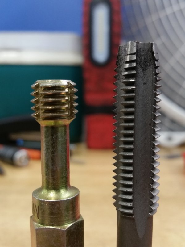

Chase both the bolt and hub threads with a correct size thread restorer, taps are for cutting threads.
This could be great advice! I never thought about it, but perhaps a thread restorer would push some metal back into position, whereas running a tap through the same threads might cut off distorted metal. Net result is a thread restorer may do a better job.
Note the difference:
I have "chased" so many buggered holes with both I have lost count and unless the thread fit is unusually demanding I don't think it really matters. Taps definitely do a better job of cleaning out rust and dirt. I have a much more extensive inventory of taps so that is what gets used most often,

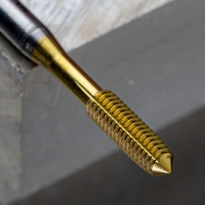

If you are a purist maybe a thread forming tap is the way to go. :rolleyes:
