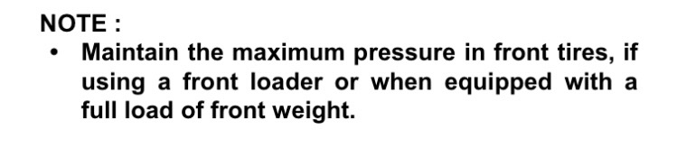

Hey. New to this and just got a snow pusher (48") for my BX1880. I have a weight box on the back with 300lbs in it. Wondering what the right tire pressure is. I have the turf tires for now, but I have a flat driveway. Thoughts?

Follow your owners manual.

Although the pusher weighs about 60 lbs. more than the stock bucket (~190 vs. 130) you are not "lifting" a full load with a pusher. The manual states max psi when using a loader with a bucket to account for lifting and/or transporting a fully loaded bucket. That said you can't go wrong at max psi but I wouldn't loose sleep over a couple psi deviation.

I doubt the weight of the snow pusher will make a big difference. I'd do a visual check by lowering the snow pusher to the ground to take the wight off the tires and see how they look, lift the snow pusher and take another look. If the tires are looking flat add air. I'd be sure to run close to the max tire pressure if you are using the loader for gravel or fill. I kept my pressure low for mowing, and did some gravel work without increasing the pressure and cracked the side wall of my turf tire which failed shortly thereafter. I'm more careful now about airing up when using the loader.
