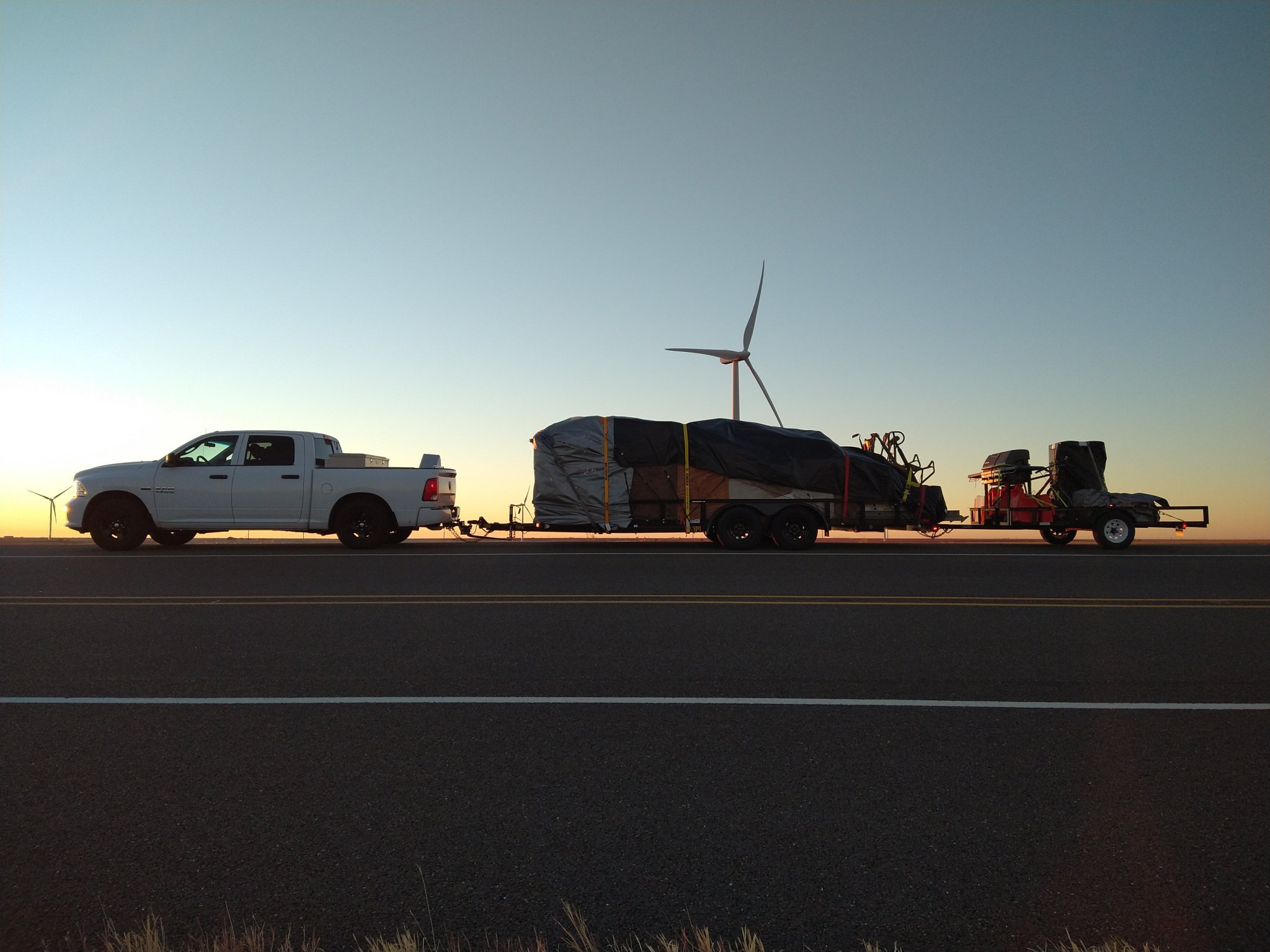

I never burnished the brakes on my 2022 Big Tex Trailer I bought new from the dealer in Tucson, AZ ... He never told I had to, never read anything about it either ... Works fine, if I forget to turn the controller down after I unload it, it will skid the brakes!
1200+ mile trip, way overloaded when I moved from AZ ...

Most trailers like mine are stacked and hauled on flatbeds ... Enclosed trailers, including small RV's are often hauled on a step deck, or car hauler type trailers, except 5th wheelers, and bigger bumper pull RV's ...
Nice to know it can haul a wind turbine!
Only if you got a Hemi! ;):rolleyes:
I will say that I now remember that while at the dealer, even at the highest setting it wouldn't skid the tires with the empty trailer, or even feel like they were working at all, I complained, and they told me to drive forward and backwards around the lot, applying the brake controller, they said they probably forgot to adjust them ... they got better in short time ... So maybe they needed to be burnished, or adjusted?

Is that auxiliary Prop Pulsion device lectric or fuel powered. I can see why you need it. Just never seen anything like it mounted on a trailer. :)
It's really just a big fan to keep my brakes cool while breaking them in, or otherwise called burnishing .. 😂
5,983
3,200
I should not divulge this inside information. It really is a top secret development. What appears to be a propulsion device is actually a wind powered generator. The pulling truck is an electric vehicle.
It is a prototype perpetual motion machine. The generator output actually produces more energy than the electric truck uses to pull it.
I believe Shawn is the next Elon Musk in the making...you heard it first here at OTT!
Edit: Do not be mislead by claims stating otherwise,
