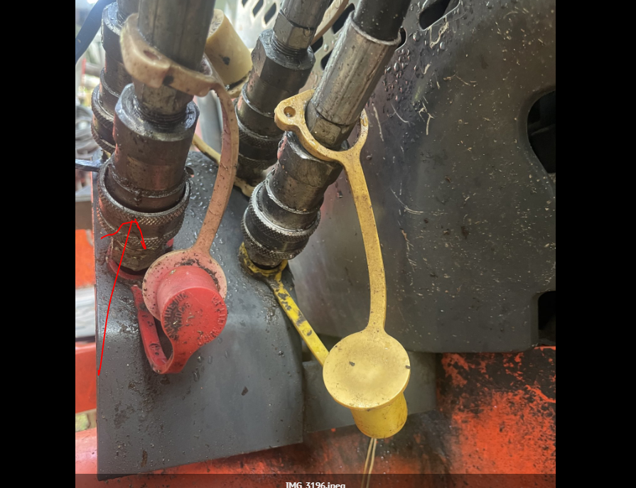

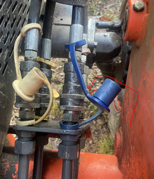

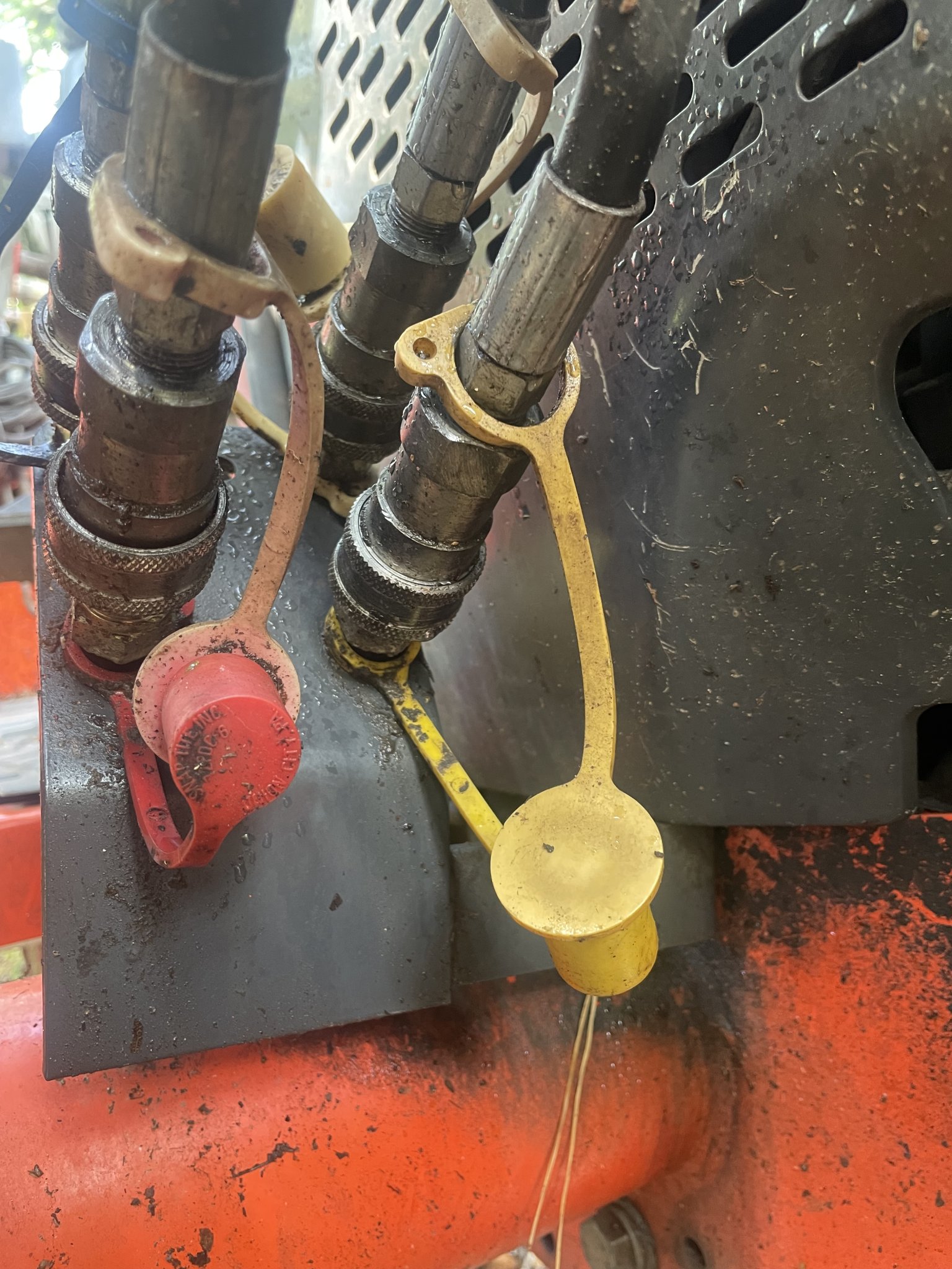

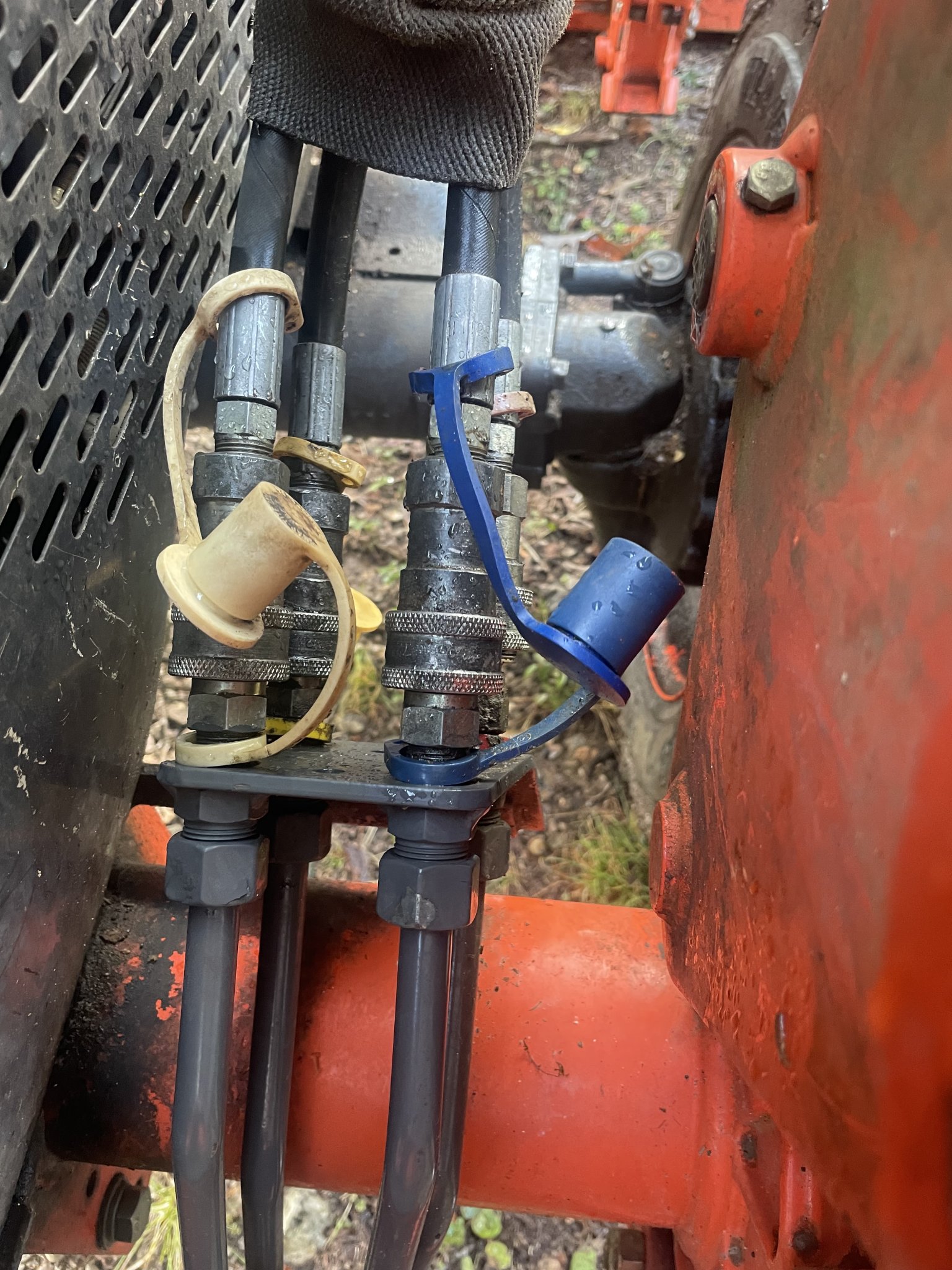

Numerous replies suggest that the lines are crossed up, or ports reversed. But I double checked those four loader fittings and they are fool proof with those color coded dust caps to insure the right connections. See photos.
Besides, if ports were crossed I would still have four functions just the stick motions would be directing the wrong loader functions. I only have two loader functions, not four.
I will try swapping some lines at the quick disconnect junctions to see what works and does not work.

The red quick disconnect is not seated!

You really need to read my post, your problem is you don't have one of the quick disconnects seated.
It's not connected that why it's not working!

OP, this is your problem. I noticed the red line isn’t seated properly, prior to reading NIW’s responses.
Had this happen once on my L3830 (the GL series just prior to yours).
Also, those quick couplings (female end) are pretty dirty. You probably ought to clean them up real good. Good chance there is some debris between the sliding sliding collars.

You nailed it! And you could see it in the photo.
I am so grateful. Thank you. Problem solved.

Apparently not.
And they aren’t clean either. At least not in the posted photos wherein it was apparent the red line wasn’t connected.
