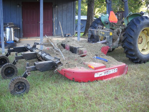

I got a bit rough backing my Bushhog 3008 and broke one of my rear wheels off.
Yup welded it back on and all is good.
