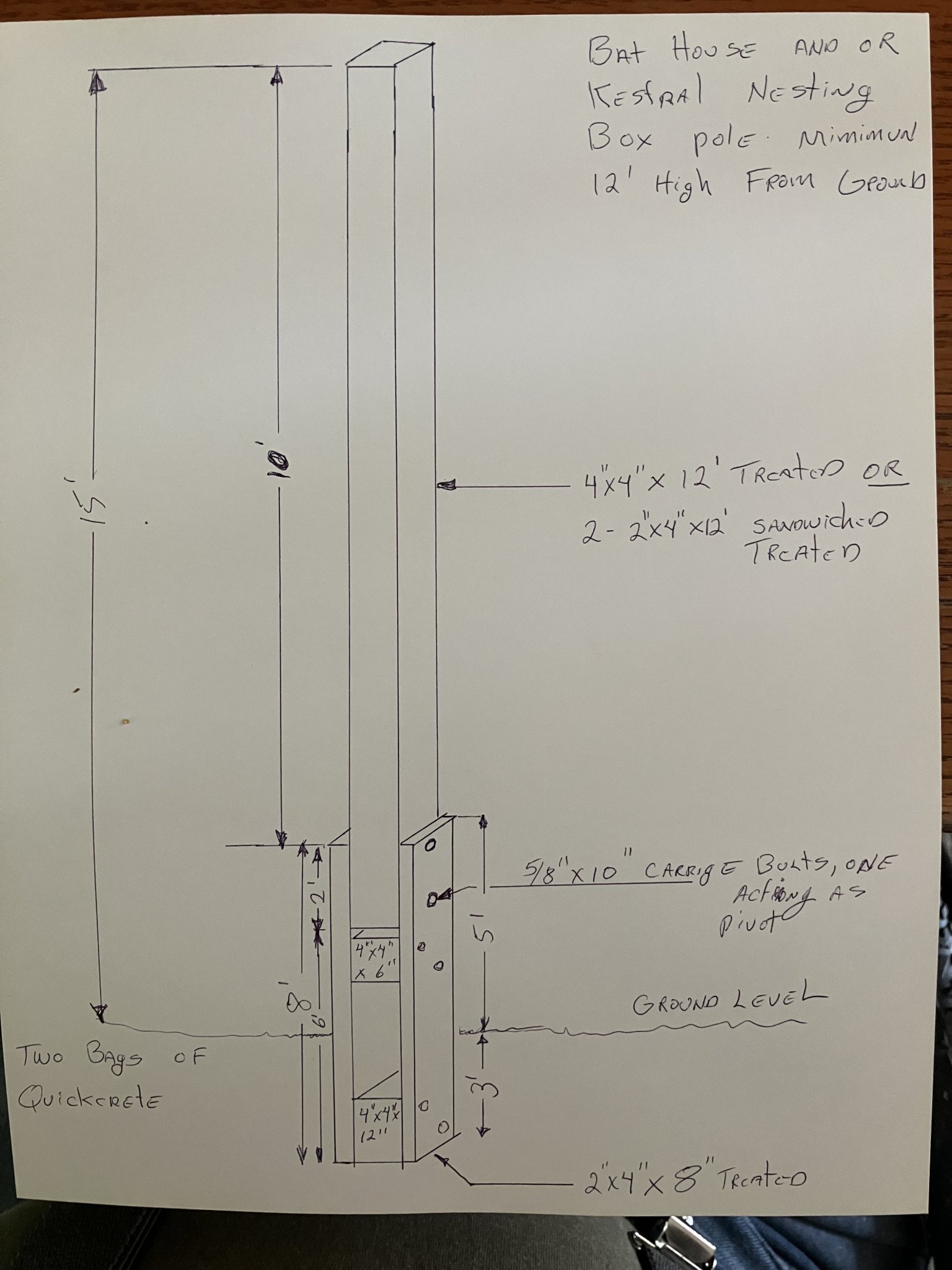

By the end of this summer I am required (program practices deadline) to place one bat house and one kestrel nesting box on my oak savanna project.
I would like critiques and suggestions on my initial plan of attack. Both the bat house and nesting box needs to be a minimum of 12 feet from ground level. The boxes themselves are relatively light weight but the bat box may have wind loads due to the vertical surface area.
The other major criteria is that I am able to "hinge" the pole down to ground level once a year and clean the house, nesting boxes. This is due to me not being able to climb a ladder and with minimum help lower and raise them back up . My plan is to remove one of the 5/8" carriage bolts and then pivot the pole down and vice versus going back up. With the pole up I would torque both bolts for clamping forces.
My soil is loamy sand , plan on a full 36" deep hole with two bags of quickcrete in each pole.
Keep in mind my first drawing is NOT to scale but the important dimensions should all be there.
All lumber will be pressure treated.
Depending on price of a 12' 4 x4 compared to two 2 x 4 x 12' would two 2 x 4's bolted or screwed together give me basically the same strength as a single 4x4? Wind side loading would be the largest forces I would guess.
Thanks in advance for any suggestions or critique's.

Nice design. I like it..
It's going to be heavy swinging it up or down. Lose control of it and the bat box will be destroyed. Or whomever whatever it falls on. Maybe a rope and pully to a nearby tree to ease it down?
Set it up to swing down on only one side.
I was thinking 4" ABS pipe instead of 4x4 due to weight but it will flex more.
Good luck Sir.

Great idea and yes , setting it up so it can only swing the one way will offer some extra safety when raising.
I might also consider increasing the "lap" joint to 3 foot. I can afford that and still make the minimum 12ft high requirement.
The other item I did not draw in but should be done is to bevel the top edges of the 2x4's for water to run off.

I’m far from qualified to offer a legitimate critique.
My only first-thought was 2’ and two fasteners might not be enough.
That wind load on a tall lever with an obvious fulcrum/pivot that close to the bottom bolt might be tough.
Physics says that’s a lot of force.
I’m just spitballing- 3 or 4 feet with 3+ bolts - one as your pivot?
Again- far from an informed opinion.
Looks like a great project!
Thank you for your input!
Yes, I think that 3 through bolts and 3 foot of overlap is good insurance. Very little time taking two bolts out versus one to make the pivot maneuver .

Thinking a bit out of the box, but could you put the pivot point higher, while leaving the pole length the same as your drawing, and then perhaps lag bolt some weight on the very bottom, like old brake rotors, or maybe better a barbell weight, which would add some weight to counter the weight of the pole/house above the pivot point, so swinging it down and putting it back up would require less effort? (Sorry for the long sentence)
The weight would also serve as a stop, when you were raising the pole back up, so it would not swing past vertical, and want to fall towards the opposite side.
Ideally, but perhaps not practical, enough weight could be added to make rotating the pole almost effortless. I am not suggesting that. Just something to counter the weight of the pole as you lower it, compared to having no counter weight at all.
Great idea and I had considered that as an option and could be added at a later date. Much like the counter balanced road and pedestrian barrier gates.

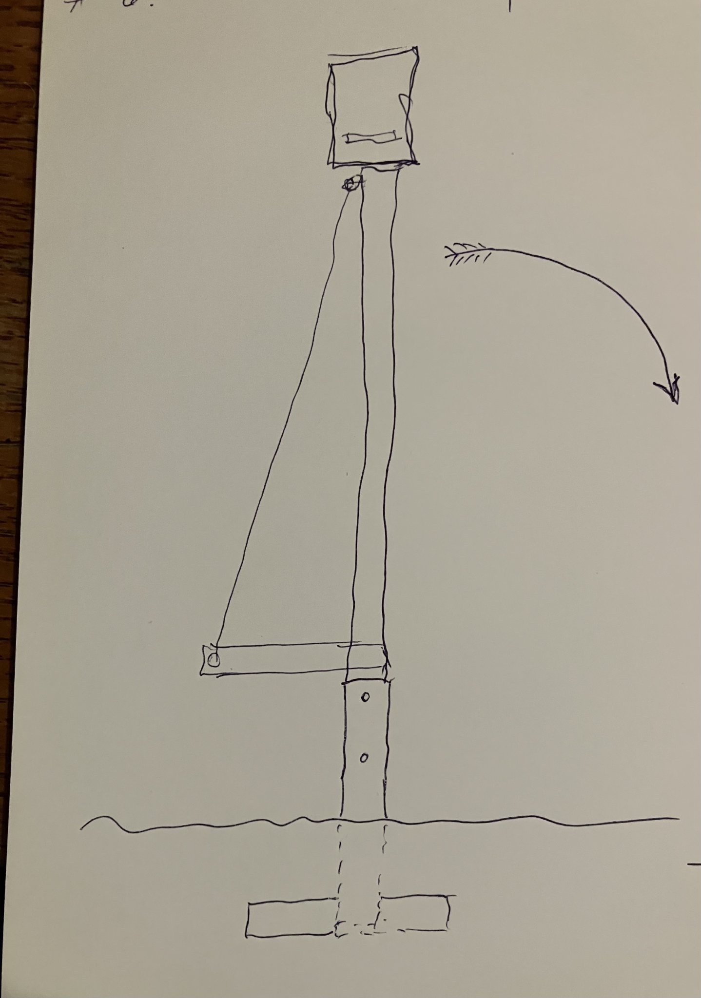

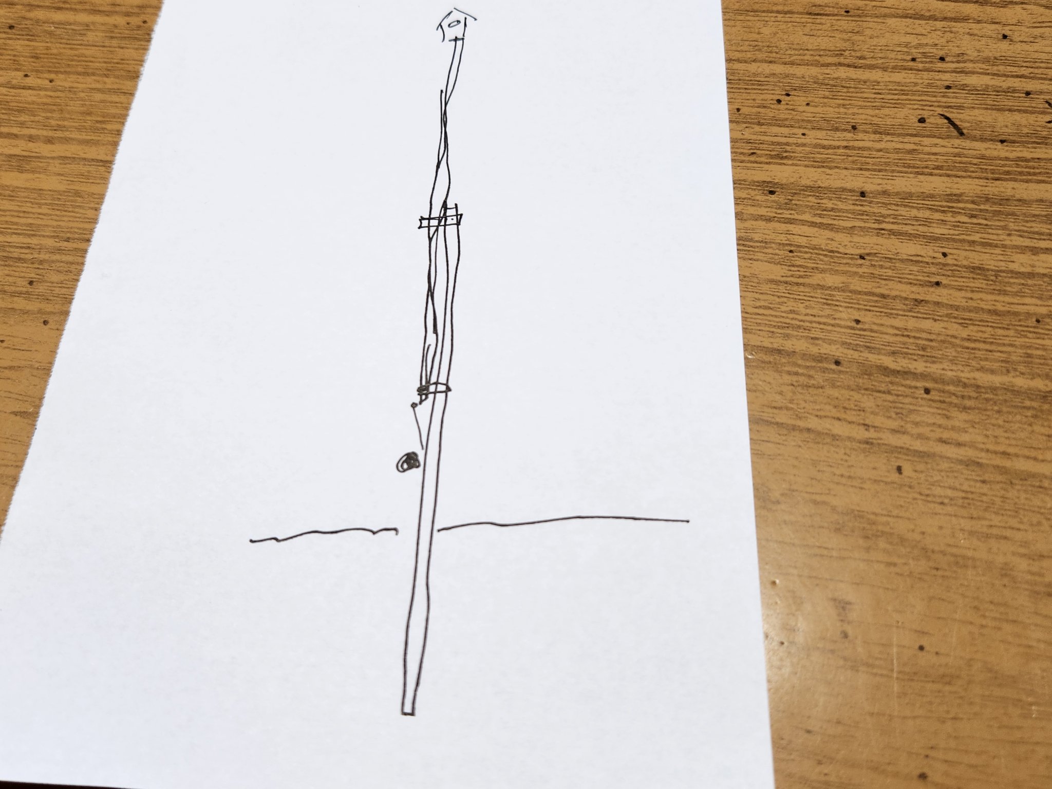

You might want to extend the length of the horizontal under ground pieces and dig slots on the hole. The extra weight of the earth on the extensions will make it less likely to turn over and pull out of the ground. (We screw 2 x 6 x 36 inch long to the bottom foot of the fence posts and bury that at the bottom of the hole to help the posts not wrench out of the ground from the force of the fence tension).
Also I have seen people attach a horizontal lever arm to the posts to lower and raise the post at the pivot point. There is usually a guy wire attached at the top of the posts (near the bat box) that is also attached to the horizontal lever arm to make a triangle shape. That is left on the post after it is up but the horizontal piece can be removed until the next time to clean the house.
I am not sure any of that makes sense in words, so I can make a sketch if needed.
I would also use 4x4 for both sides of the lower (underground) section. They will be rotting quickly enough that 2x won’t last that long.
Something like this? All good thoughts and suggestions, thanks!

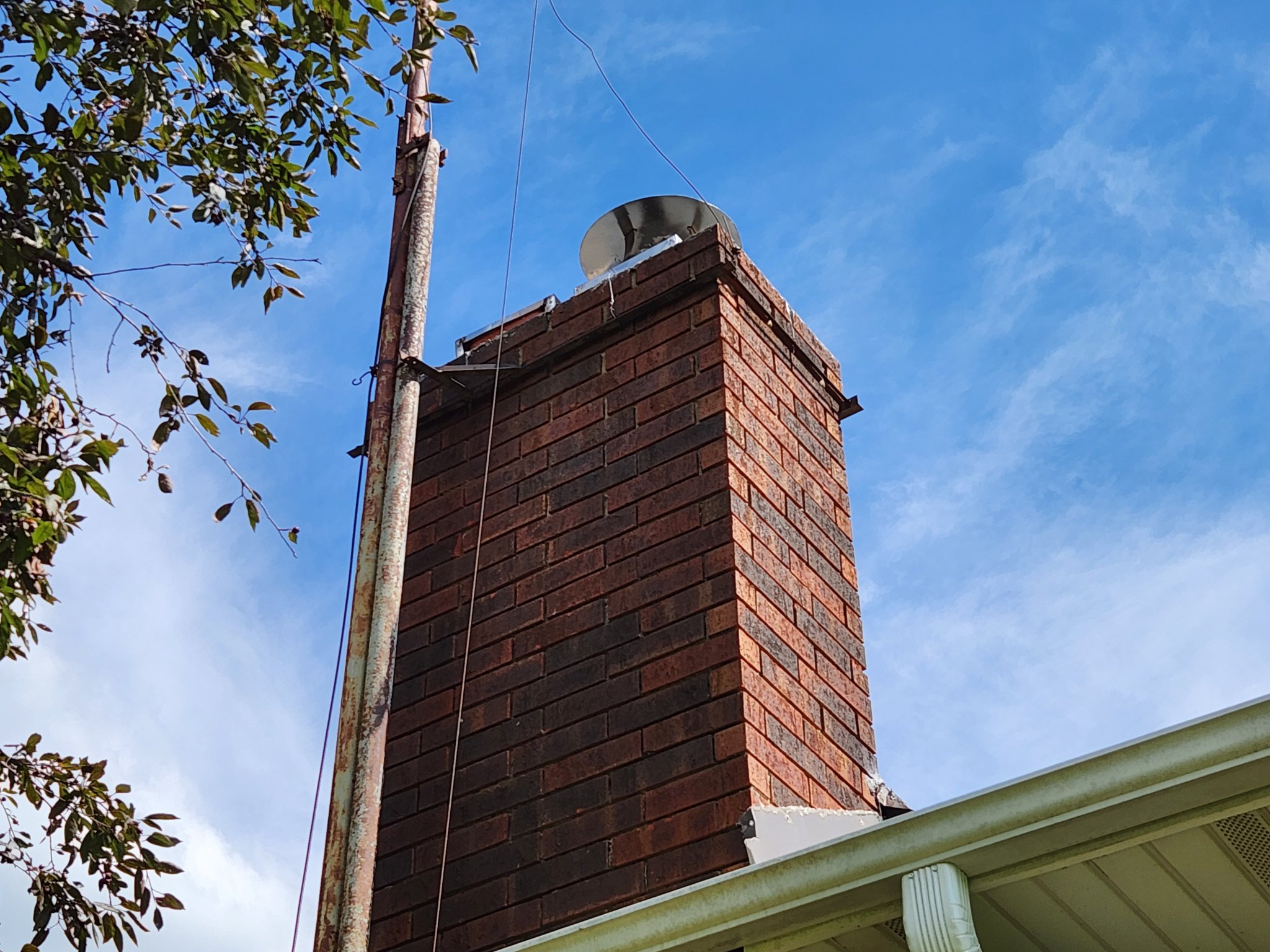

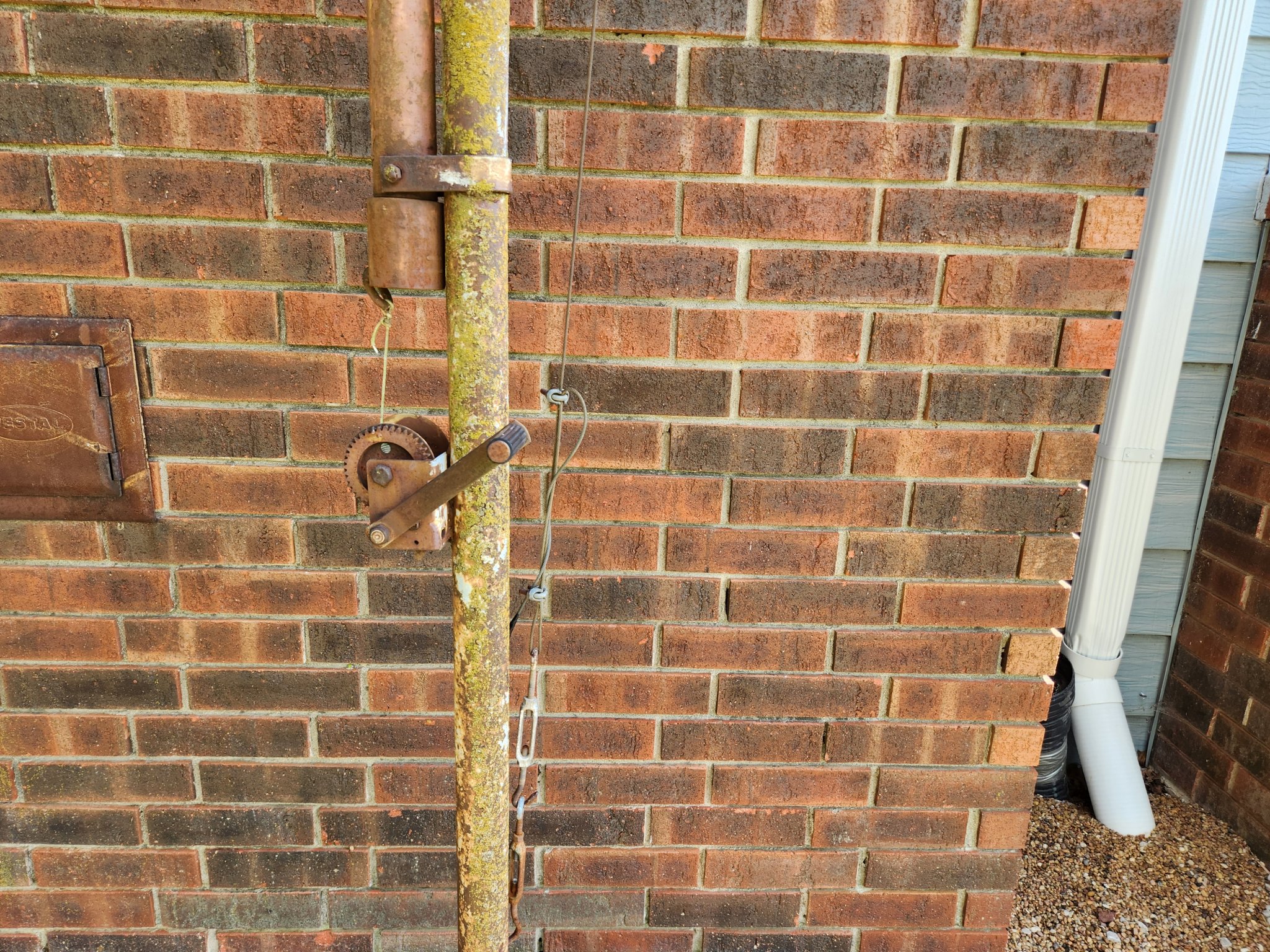

Ken, another idea for the tilting bird house. I used metal for a TV antenna years ago. It's simple. It stand 40' in the air. When I first made it I weighed the antenna I was going to attach then figured the balance point of the pipe above the hinge and made it all balance out. I used a boat winch to pull it up after it was let down, but the winch was not necessary because there was no weight to deal with. Here are some picture to explain the contraption. Obviously you make it any height desired.
6,365
2,015
Cleaver.
But I think you have guy wires to support the top?
