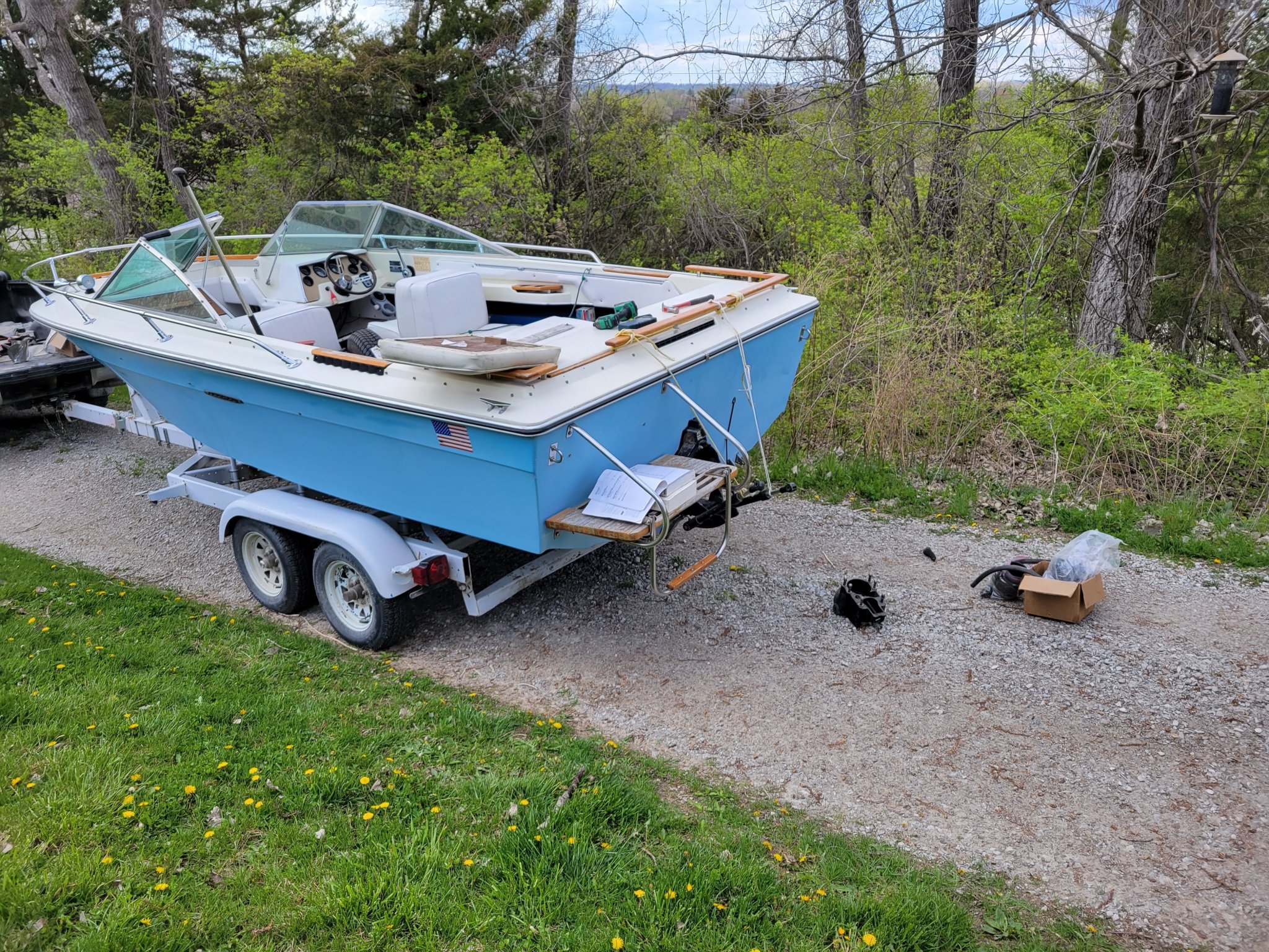

Last weekend I came across a 1979 Sea Ray SRV-195 for sale on the old interwebs. It came with the outdrive detached, bell housing removed, bellows removed, trim switch and sender cut, interior paneling and seats needing reassembled, and battery cables needing rerun. However, the price was cheap so we went and took a look and she has solid floors and transom and the Ford V8 ran better than a lot of the cars I hear on the road today. Here are some pics:

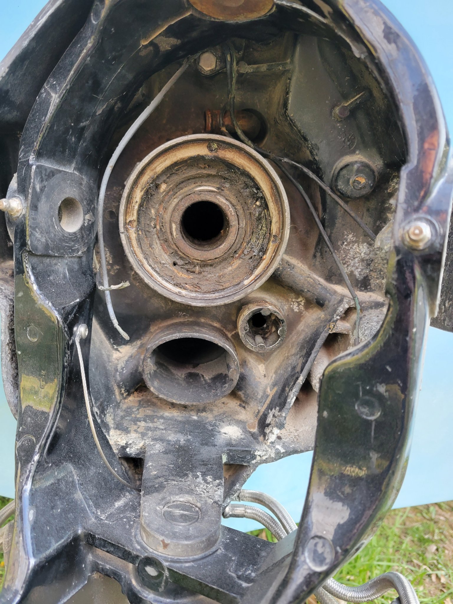

Now onto the fun part. The boat had the outdrive removed and bell housing removed in order to replace the bellows. Luckily the person who owned it before me thought ahead because the gimbal bearing: 20210421_180214.jpg

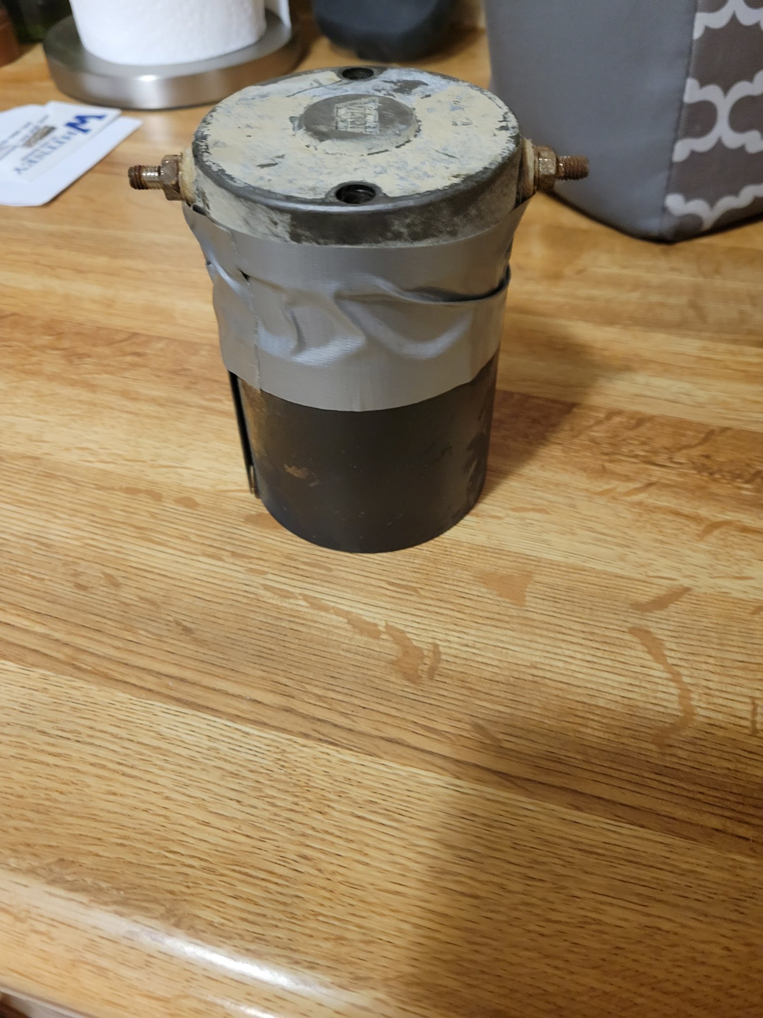

was pretty much toast and they included a new (in original packaging and everything) SEALED (WOOHOO) gimbal bearing came with the boat. So one trip to Autozone, a 120 dollar deposit, and loaned axle bearing puller later I had the crusty old one removed. Now I don't have $100 bucks lying around for a Mercury Marine Gimbal Bearing Seater. However, I do have some junk in my tiny "garage" that can't even fit a car wider than a jeep liberty in (see pic 1 on post 1). In said "garage" I have an old Warn winch that I dissembled for very good reasons and never reassembled or threw away for also very good reasons and found that the motor housing was almost the exact diameter of the middle of the outer bearing race. Add the cap that held the brushes and leads with a few wraps of duct tape and voila home made bearing driver:
