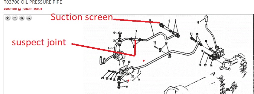

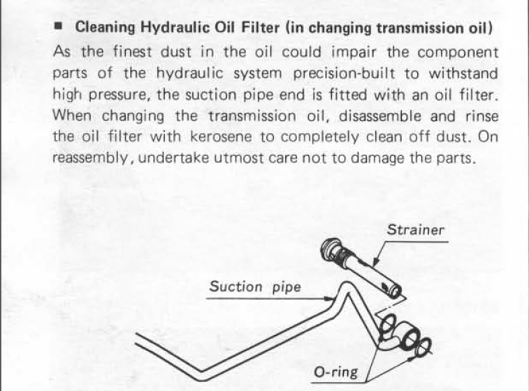

I was wondering if you figured out where the air leak was coming from with your B7100. Thanks
An air leak is always on the suction side of the pump.
Start with the suction screen at the side of the rear of the tractor and then follow the large metal tube up to the pump.
Any rubber hose and clamp junction in the line is suspect. Also any rubber seal or O ring.
