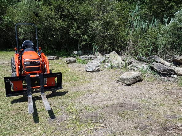

For reference here are the approximate weights of various diameter rocks assuming a density of 2.6 grams/cm^3.
Diameter (ft)___Weight (lbs)
1.0 _____________ 85.0
1.5 ____________ 286.8
2.0 ____________ 679.9
2.5 __________ 1,327.9
You can check the loader capacity to see if it will meet your expectations.

I believe that the B3000 is a heavier/larger framed tractor than the 2601. The BH77 backhoe would be a step up from the BH65. It has some longer reach and 180 degree swing (which the BH65 can't do).
Make sure to look at the loader specs. My guess is that the B3000 loader won't lift quite as much as the newer ones on the B2601. Just multiply the loader model number (LA4xxx) times 2.2. That should give you a rough estimate of what it's supposed to be able to lift at full height at the loader pins (so, in actuality it will be substantially less with whatever is in the bucket). I would think that the loader breakout force would be higher on the B3000 though.
