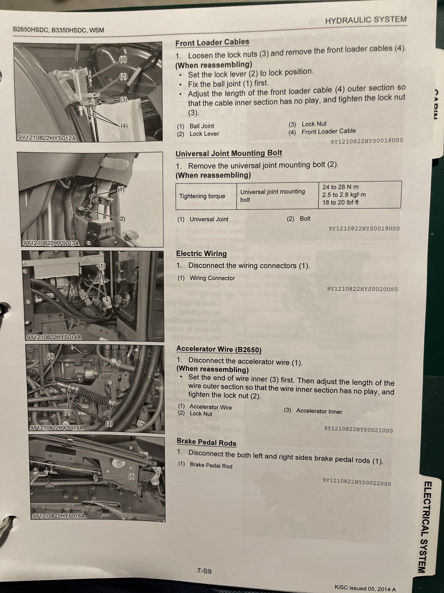

I have to replace the hydraulic cable on my B2650 when I do I want to make sure and do it correctly. This is the second cable I have had to replace. Is there someone who has done this before that could give me some tips or refence a book or video? Your help is greatly appreciated!
Lug66
M4D-071, Z422KWT
Jun 7, 2023
123
67
Midwest

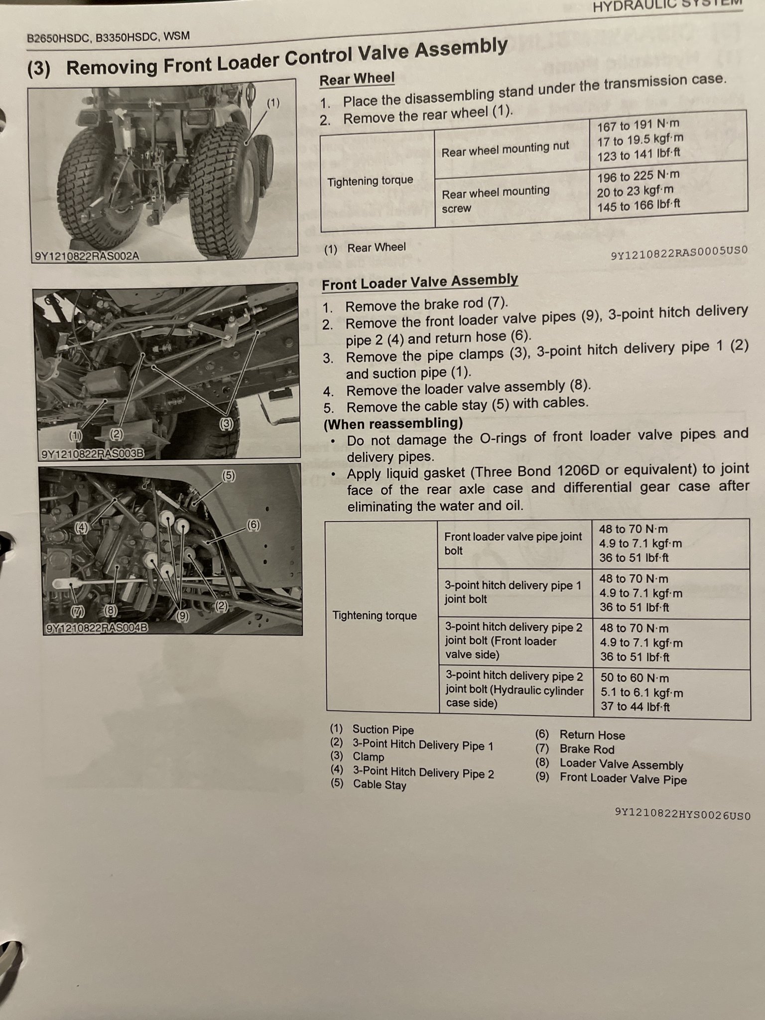

Is this the cable? The hydraulic section is pretty lame in the B2650 WSM.
