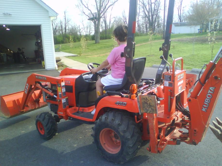

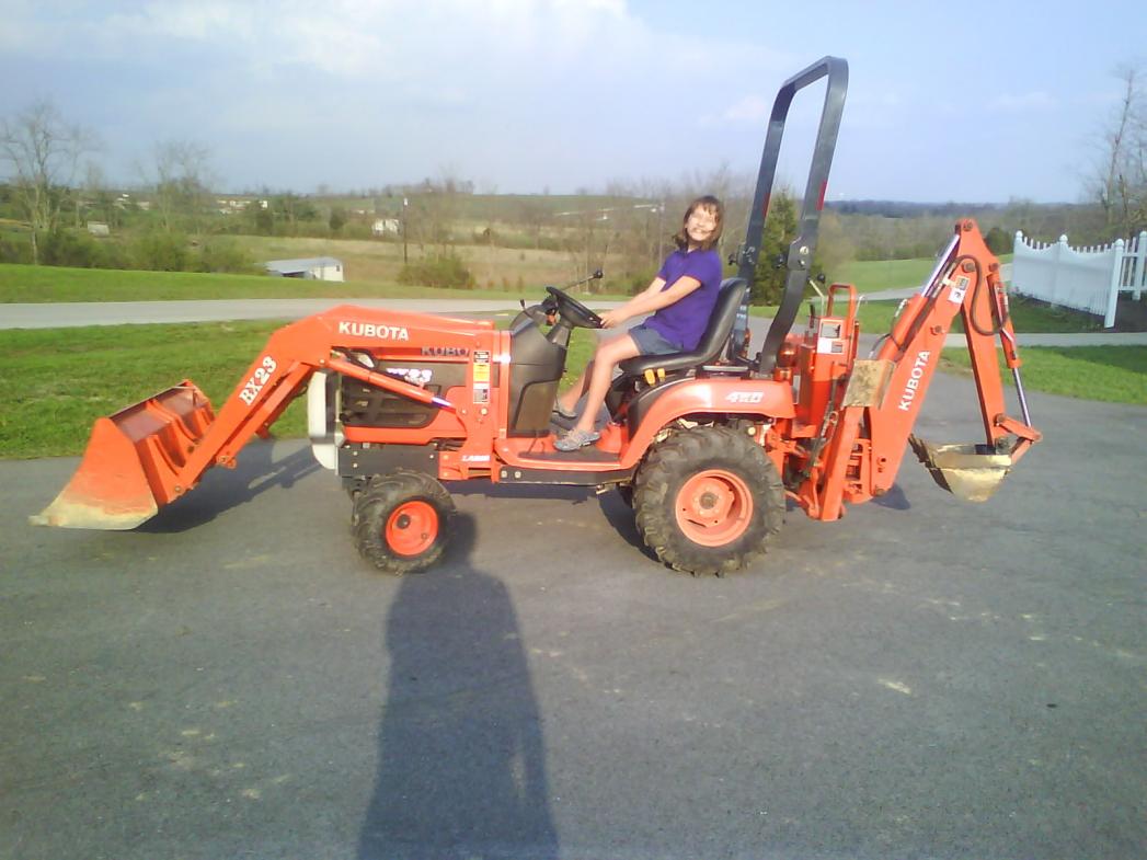

I know this doesn't help with your problem but I thought the timing of your problem and my similar problem was unique. I bought a 2004 BX23 this week and last night taught my twin 10 year old grand daughters how to drive it. They both had a problem in that when they would step on the HST pedal to go faster than a crawl the engine would quit. I was puzzled for a minute because in the little I had used the tractor this week I had not had a problem with it. It was then that I noticed they are so light in the seat that when they put more force on the pedal they got light enough in the seat for the kill switch to activate. Good luck on getting your problem solved.
