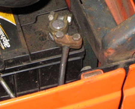

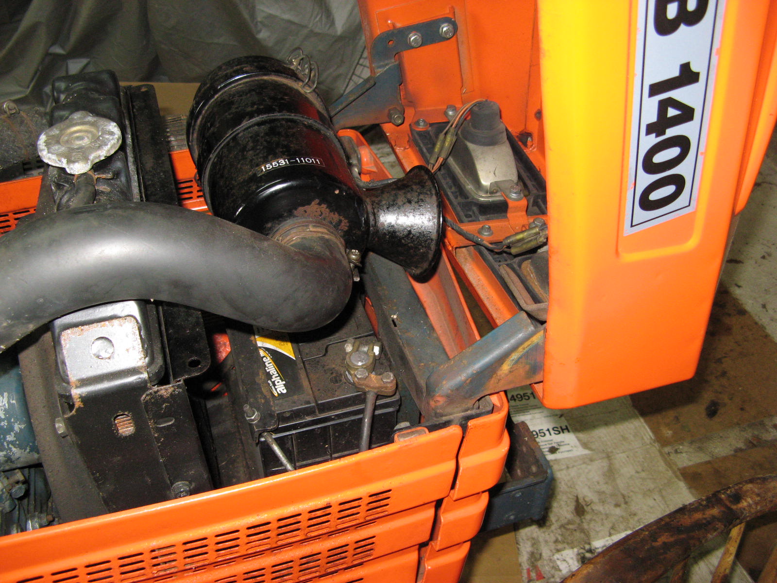

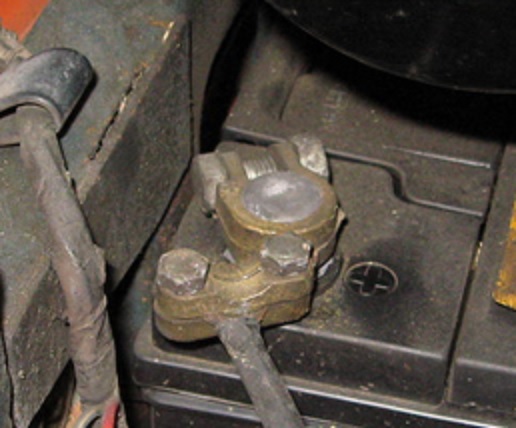

Hi Dave,
The battery is a type 048 which is 12v/45ah/360a CCA. Here is an example:
I can't test the battery and crank it at same time - I'll let you know when I get my buddy to give me a hand!
Photos below.
Many thanks!

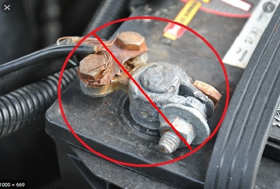

Using repair ends on battery cables is a sure fired way to get significant voltage drop over time and thus hard starting.
If you know how to do diagnosis measuring voltage drop then use them but for the average owner, replacing them with complete new cables usually solves lots of problems.
Here is a cable end from another owner with starting problems.

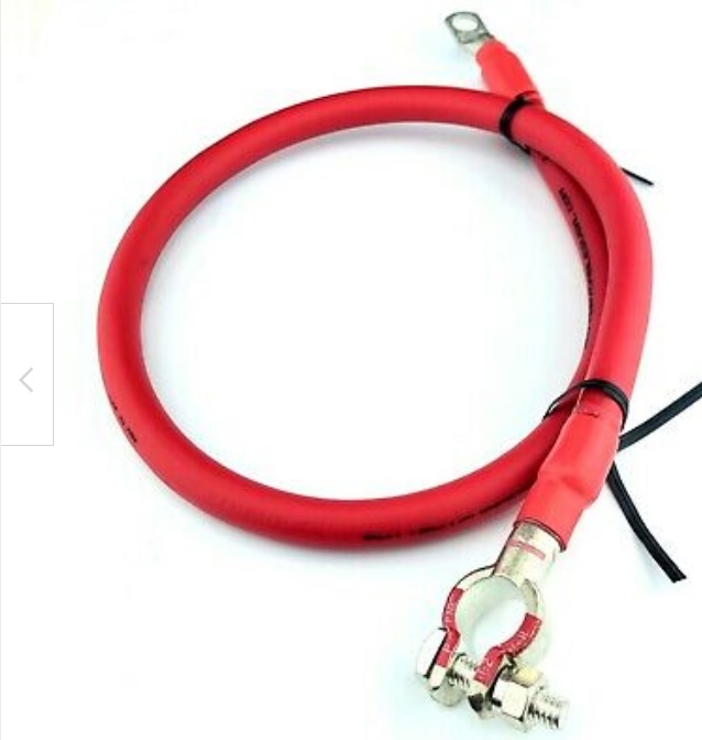

I am suggesting off the shelf cables with factory ends.
This is not an occasion where you want to go with what is minimally acceptable especially with an older tractor and starter.
Cables are sized for a 3% voltage drop which is fine with new equipment. When things are old and weak, every 0.1 volt drop becomes significant.
