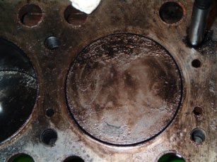

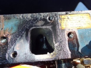

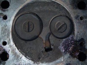

Here is where I currently am at on my L345DT TLB project. Symptoms: tractor is difficult to start at temps below 40F even with multiple extended glowplug activation (replaced all glowplugs) and an oil pan heater (the hose heater didn't work even though a multimeter indicated its should. However, when I got it out of the tractor it worked and I now suspect the previous owner had a 100% antifreeze solution). A dry compression test gave results running between 290-300 per cylinder. a wet compression test gave the same results. a leak down test averaged around 70% with most of the escaping air evident in the air intake and the exhaust.
When starting there is abundant black and white smoke until it fires up. After it starts there is NO noticable smoke out the exhaust and NO noticeable blow by at the oil fill port. My attempt to build a homemade blowby manometer according to internet instructions was unsuccessful, so I abandoned the project and moved on.
When I test drove the tractor (1300 hours) the previous owner had me kill it with the compression test. Operator manuals, as well as the decal below the decomp knob, say DON"T kill the engine with the decomp knob except for runaways or you are likely to damage the exhaust valves. I called the previous owner and he said for the year he owned the tractor he always killed it with the decomp knob.
Therefore, I decided to pull the head after requesting that my wife pray that it is the valves and not rings, please, purty please. Attached are some piss poor pictures (620x230? whose bright idea is that) I poured some water in the intake and exhaust ports and both exhaust and intake valves on several cylinders leaked, not a stream, but stead drops.
My thoughts: It is time for to have a valve job. No indication of a head gasket leak. Waiting on a cylinder bore gauge to arrive. I was surprised by the gunky deposits in the cylinders, around the valve edges, and mostly in the intake port side prior to the valves. I am wondering if the injectors are not functioning to spec and due to be replaced, i.e. dribbling fuel or bad pattern? I also am wondering if they are the primary cause of the gunky deposits, the black/white smoke while cranking starting, and the oily intake ports and valves???
I have not removed the injectors because I want to find a new ones prior to removing the old ones. The local kubota dealer does not have testing equipment nor do they send them out...they just replace them because cost wise it make the most sense. Any good sources for L345 injectors?
What do the wizards of smarts think about the pics and deposits. Especially note the intake valve on cylinder #4 is actually leaving an impression in the piston build up deposit ( and to a lesser extent on #1). Finally, I would note that when I changed fuel filter I was amazed at the sludge in the filter. I guessed it was most likely water from tanks condensation over a long time. I drained the tank, added new fuel with Power Service, new filter, and bled the system. Any comments?

With that valve imprint on the piston top, of pic#2, I would say at least, it needs the valve lash checked...:eek:

The cylinder walls are smooth with a little ring lip that I can feel only on one side of all four cylinders. I am waiting on an inexpensive cylinder bore gauge to measure the wear since I am at this point.

It definitely needs the head rebuilt!
The oily residue could be from fuel not being burnt well or sucking oil in the valve guides , or yes bad rings.
It needs new or rebuild the injectors (just replace them on a unit that old)!
It's possible that the cylinders are worn and it would be smart to pull it, sleeve it, and rebuild it, But I don't think it's 100% imperative to it operation.
Could you rebuild the head and still have a lower end problem, yes it's possible, but if the blow-by was low, had good oil pressure, and didn't have any knocks then your odds are good that the lower end has a lot of life left in it.

That looks like a lot of carbon build up so I'm not sure the unit is running properly or it just needs a good cleaning.
My guess is that the valve seats also have carbon build up and that is where your leaks are coming from. You can have a new valve job done but you might get the same results if you just took out each valve, cleaned it up and the seat up (inspecting each for damage of course) and re-installed.
When you kill the engine with decompression, the injectors still happily push fuel into the cylinder but there's no compression to ignite it so you get wet fuel around your piston, exhaust and possibly even intake valves. The next time you start it up (especially under cold conditions) that wet fuel no longer wants to ignite and you have a lot of unburned fuel that turns into carbon when you finally DO get it to ignite, thus the motor ends up looking and performing like you see.
Diesels need to be shut off by fuel starvation, not loss of compression. Doing it with compression loss once in a great while won't hurt the motor, but repeatedly will make a mess of it.
So, cleaning the valves, the pistons, and the fuel system might resolve your problems entirely. I'd also keep running a diesel additive for a while just to make sure it remains clean.

Carbon buildup, and using decompressor could possibly mean bent valves. Not 100% this would bend them, but whacking the carbon on piston cant be good under any conditions.

Well the head is off to the machine shop for a valve job. I took the injectors out and every one was black with soot. New injectors will be ordered tomorrow. Those injectors were in majorly tight, i.e. the worst one took a three foot cheater on a 1 1/16 box end after pulling the fuel return barbs off to get the box end over it. I just ordered a 27 mm flare nut crowfoot for installation and torqueing the new ones in. Inexpensive bore gauge on the way too.

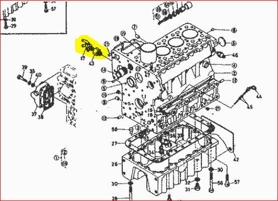

One thing I really would like to ask Mr. Wizard. I pulled the lower radiator hose off expecting to drain the block and replace the hose heater at the same time. Much to my chagrin when I pulled the head off there was still plenty of coolant left to spill all over the block and down in the pistons wells (thankfully 1 and 4 were TDC since I had barred #1 to TDC before removing the head) and a tad bit into the lifter cups. Hmmmm, I thought that wasn't a whole lot of coolant even for such a small engine, eh? Too late now. SO WHERE THE HECK DO YOU DRAIN THE BLOCK???
The design of the front gear case cover does allow it to trap water in the engine, hence the real need for a block drain.
Can I suggest spraying some WD40 on and around The block drain should be just under the Injection pump.

Thanks Wolfman. I saw that petcock just below the pump. I thought it must be to drain the pump because of the location. Since I have a healthy respect for doing anything that involves messing with the fuel pumps I didn't even crack it just to see.

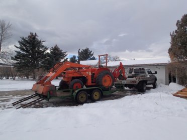

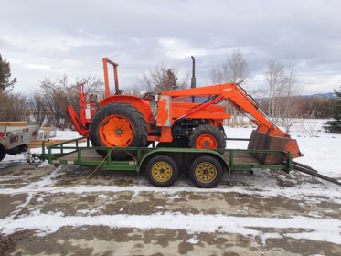

I thought I'd tag along a couple of pics of the beast I'm working on and why I so jacked about getting it up and running.

I do want to clarify that it's not the valve that is directly off the side of the injection pump, that valve is a fuel bleeder valve, the block drain is below that on the side of the block.

That is a nice looking unit, and it should serve you well! :cool:
