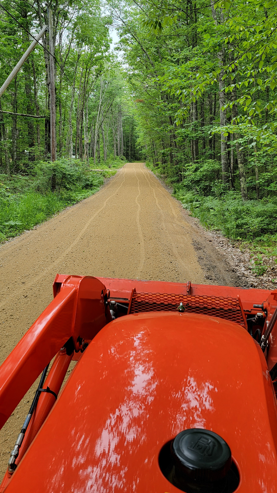

To the OP, spread it nice and even and make sure it is really smooth - lol. jk

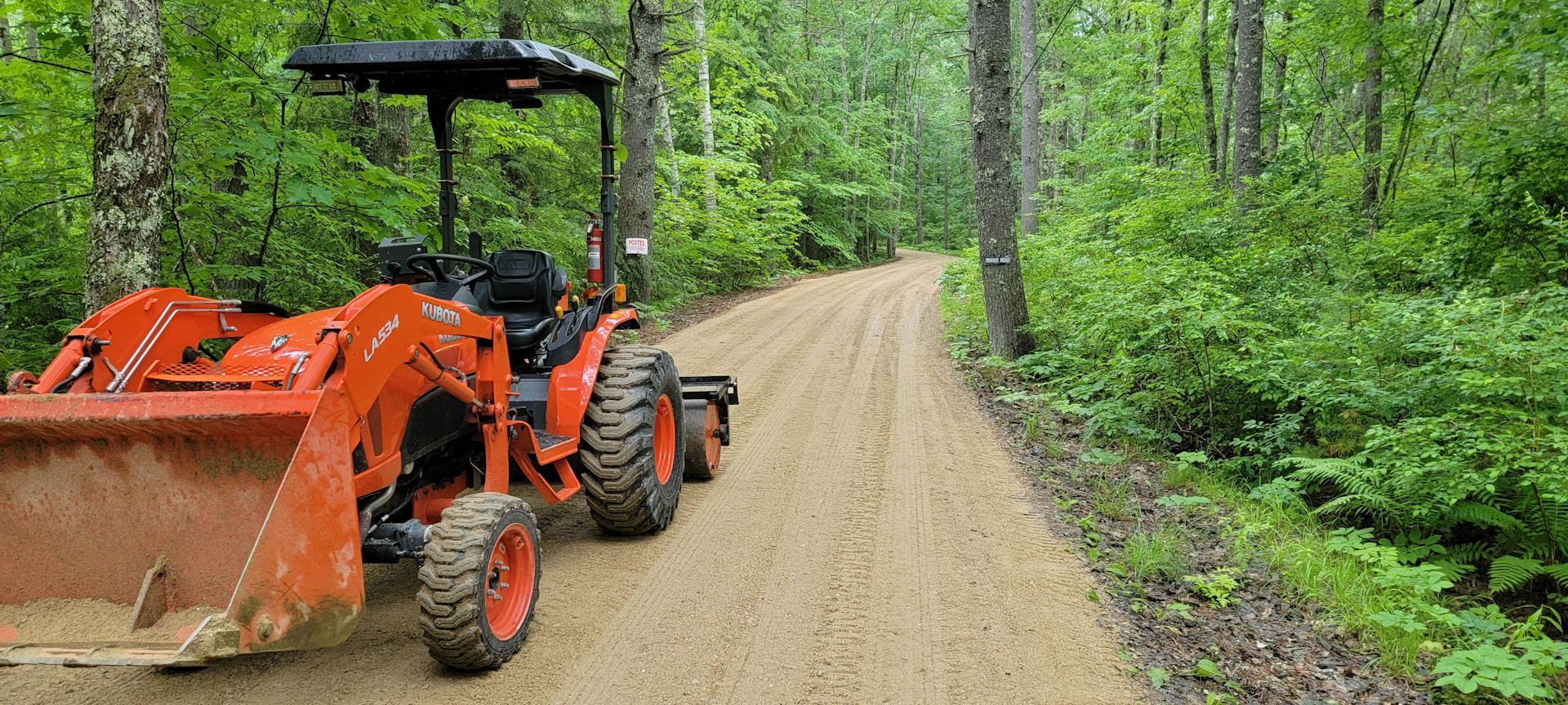

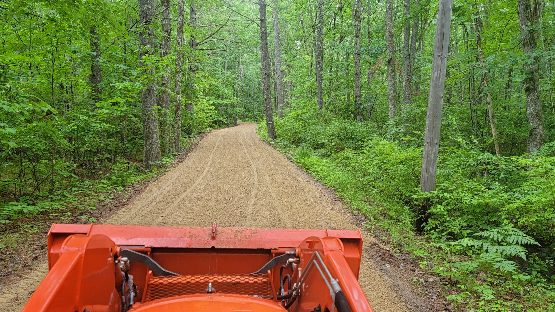

One tip I will add to the various others is when you are doing the final blade or rake always keep a bucket full of your topcoat that you can sprinkle out in front of you as you do the final grade. You will inevitably run into low spots or pot holes that continued to pack in that could use an additional sprinkle as you finish. This method also works great for down and dirty pothole repair.
Every job is different for me so sometimes I will travel to the end of the lane and then dump backwards, turn around and repeat (like the job below), sometimes I will spread directly from the pile backwards and then smooth from there, sometimes I will go forward past the pile and dump as I go. So I really can't say "do it like this" without seeing the road and loads. My default answer would be whatever is quickest and most efficient based on what you have.

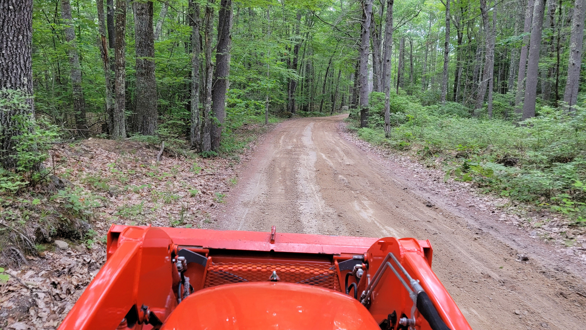

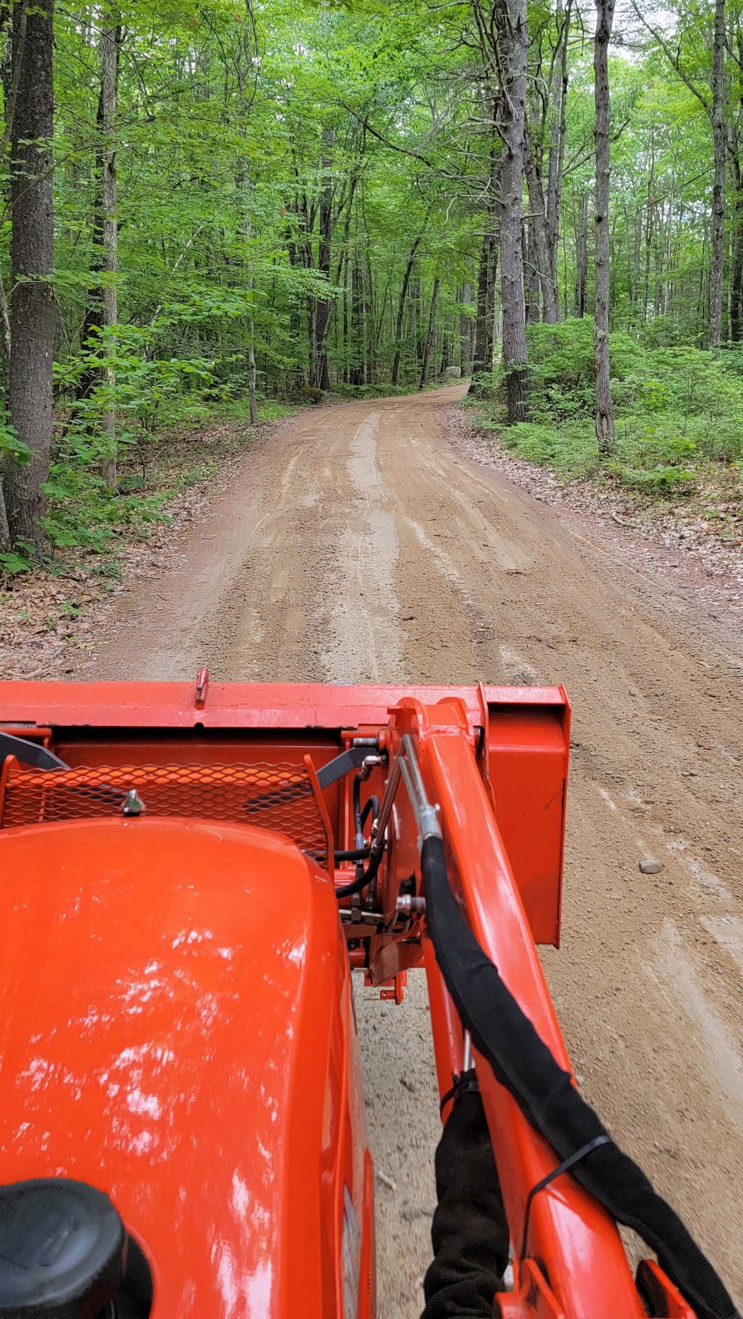

I did this grading job recently on a 3/4 mile private road that had 60yd (66 ton) of processed gravel to be spread in the bad areas. The truck driver would not broadcast spread the load so I had to bucket each load up to 500' away from each of the piles in both directions.
This was box, rake and roll. Box everything first, then spread the material, then rake and roll.

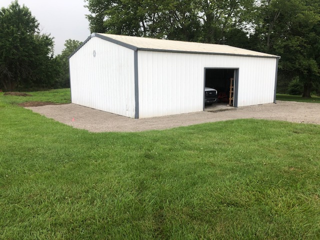

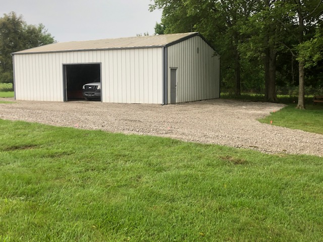

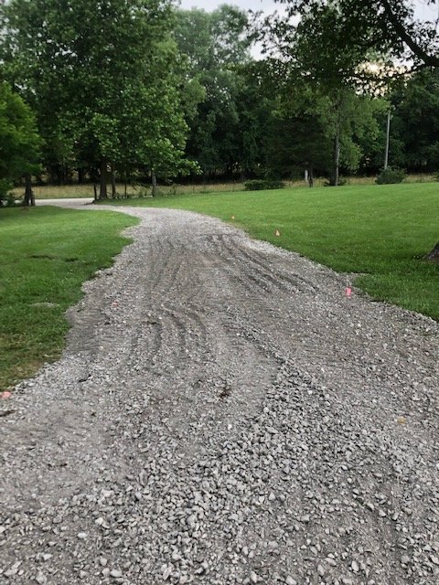

Well, here's what I have to show for my efforts.

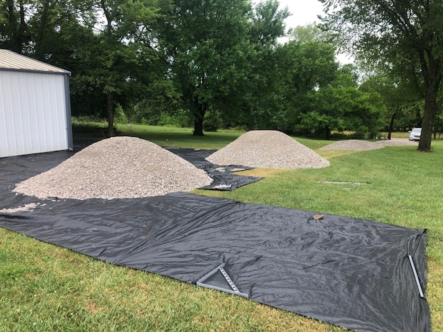

The soil around the building is pretty soft so I elected to use geotextile fabric. My lesson with it was was that it's fine if you're going to drive / dump / spread on it. I had trouble with it moving around underneath me as I worked the piles.... there, it was a hassle.
The entire project was done with my bucket and either back dragging or setting the angle and pushing the gravel around.
I have a blade for the 3 point but I could not figure out how to use it. It would be either too high and not moving material or when I mas moving some gravel and the tractor went over a bump I'd be digging way too deep. There must be a trick I don't know about.

I think you did just fine LarryBud :) I don't think I would have been as successful with just the front bucket.
DDCD
1964 MF135, L2501
May 8, 2021
160
179
Oklahoma
Looks good. It takes many hours to master a box blade. Even then I still get mad at it.
I like the fabric. I prefer geogrid myself. Fabric will keep it from pumping (soil) up into the road.
