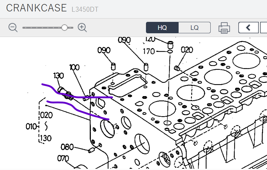

Kubota engines are very very exactly cast, machined and built.
During first assembly:
The distance between these two points (pic below) will tell you how thick the shim needs to be.
It has Zero to do with the height or position of the piston.
During field service work:
It too hard to get to or measure this dimension so they tell you how to do it via timing marks.
And the timing marks for this purpose do not have anything to do with the height of, or the position of the piston.
It has to do with the position of the fuel cam that pushes the injection pump.

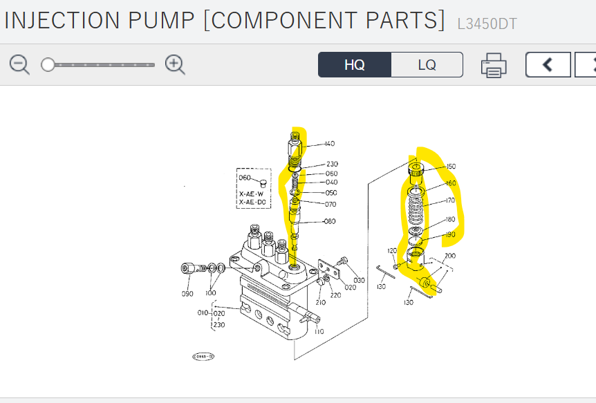

33,389
8,700
I don’t have a clue on how the injector pump switches between cylinders. Perhaps that will be my next question….🤣
Because there is one pump that runs one injector.
The yellow is a pump, the whole thing is a pump assembly.
