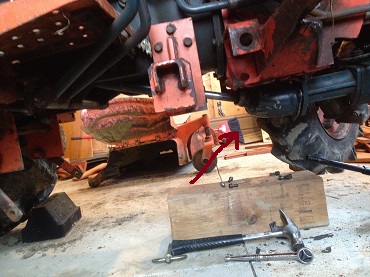

Hi All,
I am new with my recent purchase of a B7200 HST-D a couple months back. While using my tractor in snow and getting stuck, I realized my 4wd wasn't working. I noticed the drive shaft was engaging by the transmission but it was not engaging at the front axle. I pulled off the cover protecting the u-joint, connecting the drive shaft to the front axle. I notice the drive shaft splines were making no connection with the U-joint. It seems like the U-joint has lost its threading and the drive shaft can spin freely without engaging the U-joint. I have attached a picture for your reference. I am not very technical and not sure how to fix this. Do I need a new U-joint?

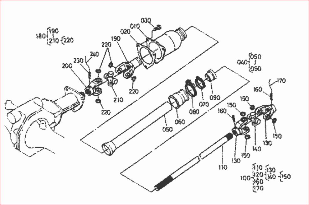

Not to be making the situation worse....but I think you will need more than that! :(
Wolfman will be here shortly and throw you some diagrams better to explain what is needed. I look at the second picture, why is the housing all beat to hell? Looks like that shaft spun in an orbit and thus has come completely out of the yoke!
To me this exactly what would happen if a 4WD system is operated on a hard surface or with incorrect tire ratios. Are your tires stock sizes by chance?

It seems the splined male shaft has slid out of the female end(yoke).how i would approach this is to remove the two parts and closely inspect for damage and what caused them to slip apart. I belive there is a locating pin that works itself out and allows free movement of shaft.
Not sure why the housing is all bent up to be honest. My only guess is they might have done it when I retrofitted a LA302 FEL onto the tractor.
The tires are stock with the original Ag tires and I believe I was moving mulch on a pact clay surface but not sure if that did it or was like that before.

That damaged sheet metal cover needs to be unbolted and moved to get at u joint yoke mounting hardware.as well the rear end of driveshaft needs to come off, then damage can be asessed.

Yep pull the cover to get to the goodies!
The reason the cover looks like that is from the drive shaft wobbling around beating the living crud out of it!

I started to disassembly and focused on the front axle u-joint. I got the u-joint apart and was able to break up the assembly and slip off the cover. Once apart, the drive shaft and the splines look fine.
In my mind that left the two yokes of the u-joint to be the potential issue. When removed the one connecting to the front axle housing looked fine with all the female splines in order. I have posted of picture of the good yoke.
The other yoke which connects to the drive shaft seems to be the issue. It only has the female splines at the far bottom (about 2mm of threading). My guess is that is not enough for the drive shaft to connect to and move. Closer inspection of this yoke and it seems like the threading has some how sheared off and resulting in a very thin diameter still remaining. I have included two pictures for your reference.
My guess is I need to order a new yoke for that half of the u-joint? Your continued advise is appreciated. Thanks again!

Yep, fairly easy fix. Ya might want to run some counter weight on the 3 pt hitch
to take some weight off the front axle when the loader is on the tractor. :cool:

Looks like the bearings in the joint cross failed and it ate it's self up.
If the covers are worn or destroyed you will need to replace them as they are key to keeping things clean and running properly.;)
With a loader like that 500 to 1000#'s is about right.
I would also pull the whole driveshaft out and check the back parts completely too.
