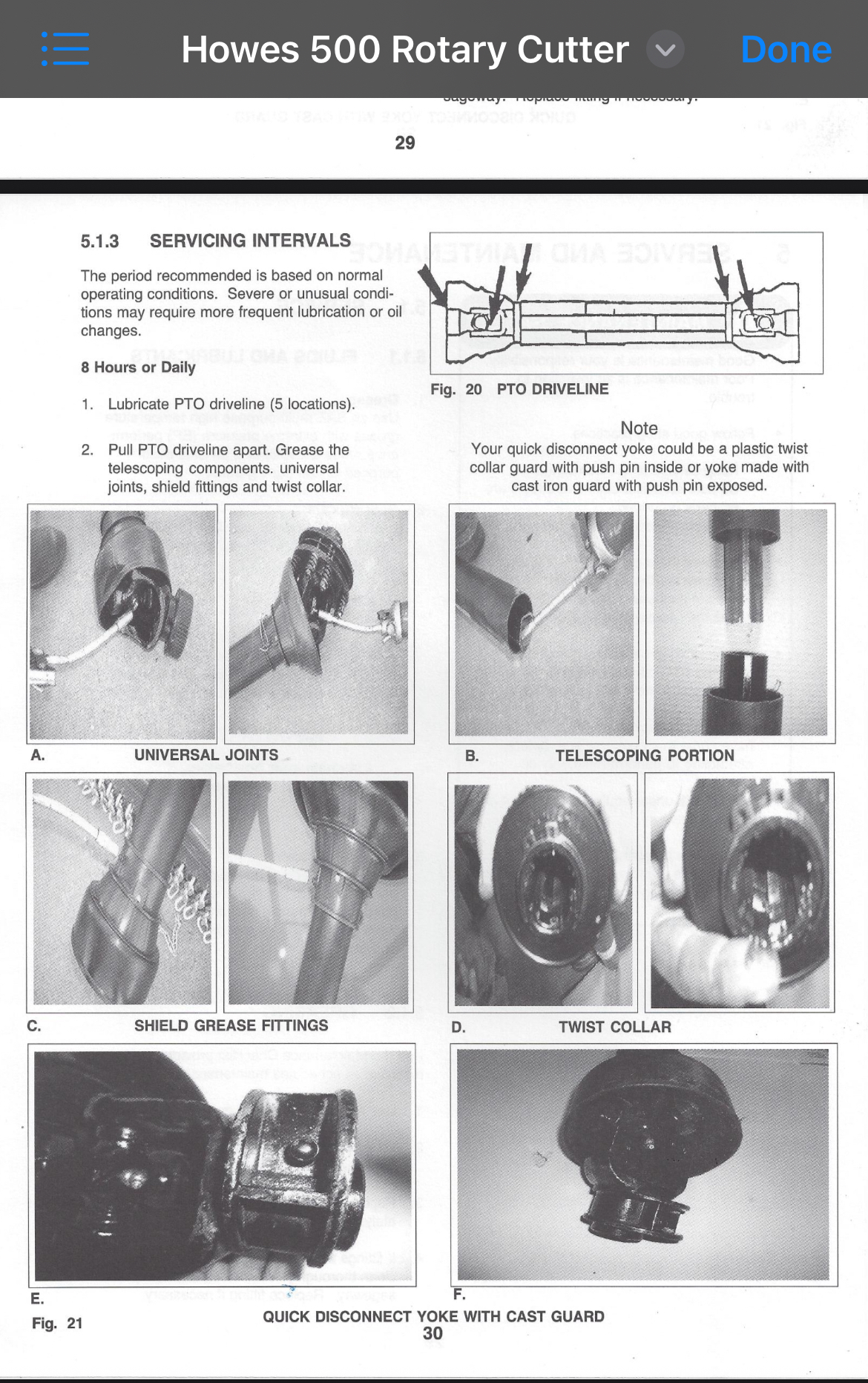

The below instruction in the owner manual for my bush hog is pretty typical from what I’ve seen.
So, every day of use, I’m supposed to remove the shaft (at least from the tractor end), displace the shielding on the gearbox end for access, grease the u-joints, pull the shaft in half to grease the slidy parts, and put it all back together.
I could probably do that on the bush hog without taking it off the tractor and someone long before me made it much easier by removing the bucket shaped shielding on the gearbox that covered the standard bell shaped shield on the PTO shaft. The winch, chipper, stump grinder, and generator; I’d have to at least disconnect the implement and pull the tractor away from it a bit to accomplish that. Realistically, I’d more likely have to drill some strategically placed holes in the shielding and use the grease gun with the flex hose to grease that often.
