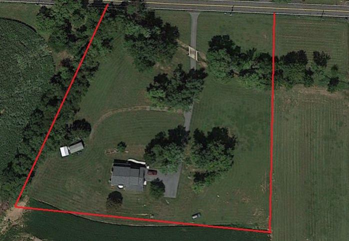

Currently around the hacienda, my primary task will be mowing with a brush hog and doing some stump and rock removal. So whatever size tractor I get will have a backhoe and a brush hog. I just wanted make sure I was safe when running the brush hog without the FEL on.
