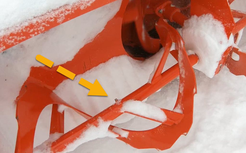

On the Kubota BX2822 snow blower attachment there are 2 Zerk fittings, one one the left and one on the right.
They are located on the main shaft of the auger. Each Zerk fitting is midway in on from the end on that shaft, so I'm wondering where does that grease go ? There are no moving parts for a good 18" or so on each side of each of those fittings. Is the entire shaft of the auger filled with grease ?

They grease the shaft to prevent the auger from seazing to the inner shaft. The outer auger is only attached to the inner by the shear bolts. Sheer bolts are ment to break if you hit something to prevent damage to the blower.

Your manual will say to grease it once a year. On my blower I grease it until I see new grease comming out the ends. By doing it this way it will remove any trapped water further preventing rust. I also wait until after I clean the blower in the spring before storage to grease both sides.
It only holds a couple ounces at most between the two shafts It wont take anywhere near a full tube of grease. In reality the grease does nothing but prevent rust until a shear pin breaks then it does provide some lubrication between the inner spinning shaft and outer auger.

That shaft looks square in the pictures? Is that just the lighting, or is it round on the ends where the shear bolts are?

My recommendation on shafts like that is to remove your sheer bolts/pin add some grease then spin them, and add grease until is comes out the ends. The put your sheer bolt/pin back in. Used to do that at least 1-2x a year or whenever I broke a sheer bolt/ pin. If a machine is purchased used, I find the recommended bolts for it and swap them out. Just in case the previous owner used something too hard. My new blower doesnt have those so no more worry about that. I just have 1 at the pto shaft and 1 at the chain drive.

But the main reason for grease in those zerks is to prevent water from finding it's way between the outer auger and inner shaft which is only attached by a shear bolt. Because of the "wet" snow blowing environment....water will find its way into those areas (voids)....and if not properly greased... it will rust out your shaft and auger from the inside. Worse...if enough rust forms it could prevent the shear bolt from doing its job and cause your worm gear (which spins the shaft) to get damaged.
Pushing new grease in there will prevent water from being able to do much rust damage. As someone else mentioned....apply Grease with the shear bolts off so you can rotate the auger around the shaft to make sure grease gets everywhere it needs to be. With my shear bolts out my auger has a little bit of left right play....so that is normal as well on some models (BX2816 in my case).
As a side note...the first time I greased my snowblower....it took a ton of pumps of grease and it was pretty hard to pump. After it is greased the first time.... it's easier to re grease it.

They usually have grease from the factory, and it will take possibly 3 or 4 pumps of grease for both sides. Just stop when you see it coming out of one end or the other. Usually, once a year is all that they need. If you ever have to take the impeller off, install a grease fitting in that shaft also. I don't know why the manufacturer doesn't do this originally.
