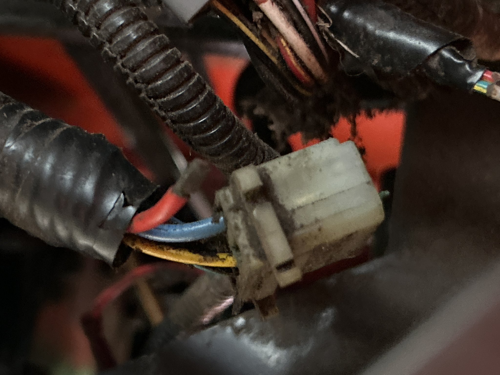

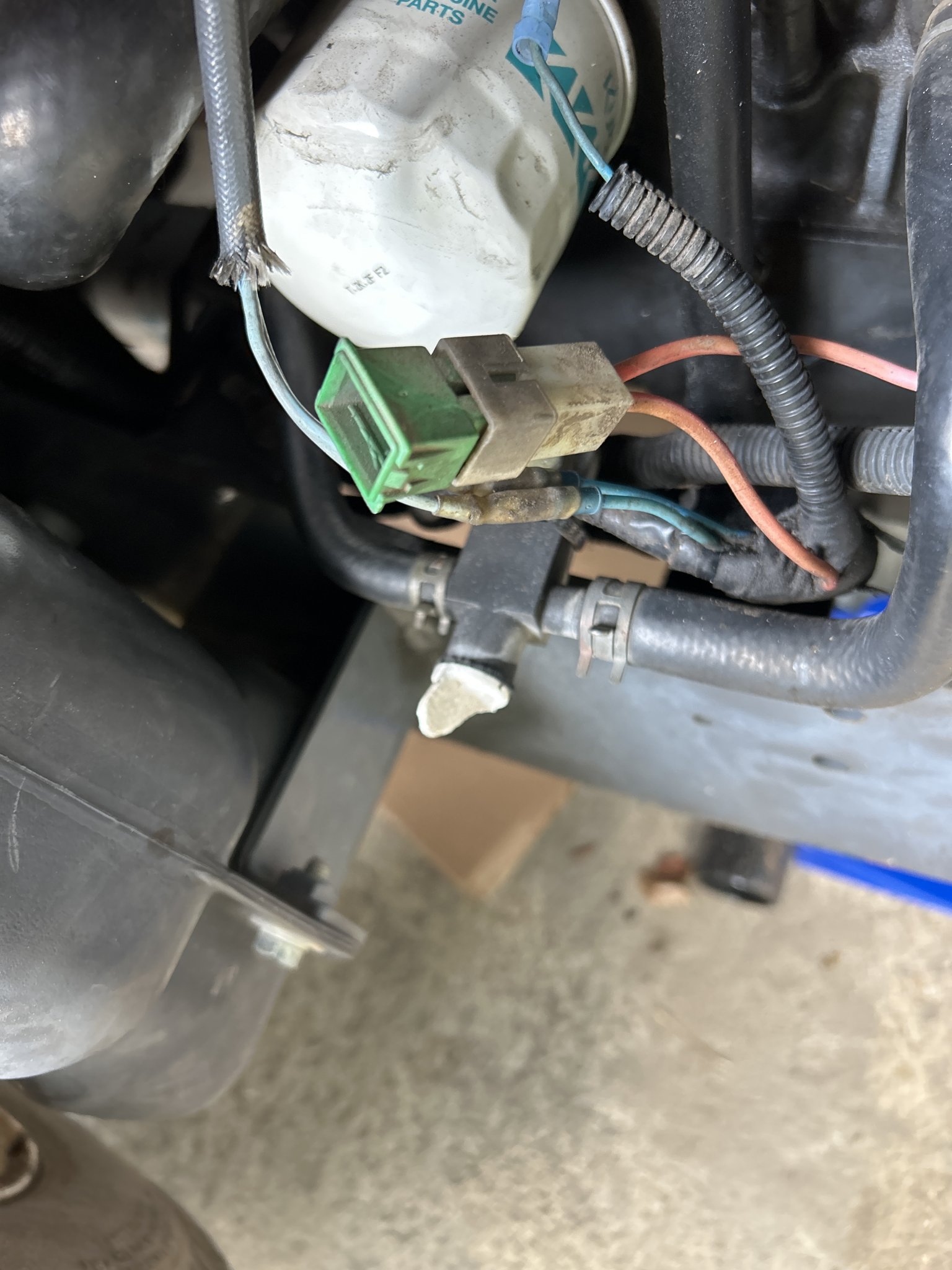

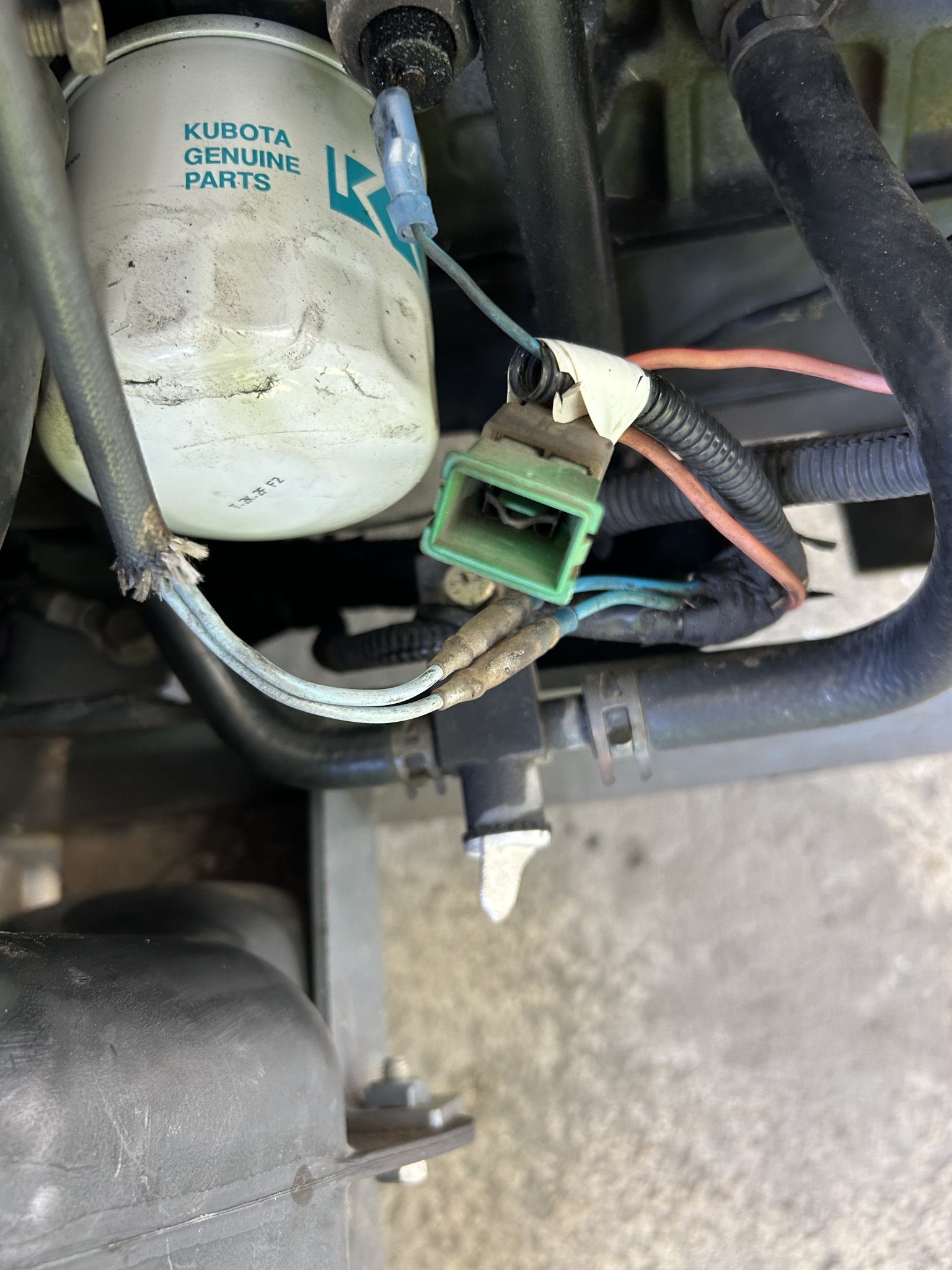

After looking more closely the slow blow fuse was in it but the end cap was knocked off of it. I ohmed the fuse and it was good. I may have found the issue, after looking around I found a loose wire on the regulator connector…..actually both sides of the connectors. Not worried about the regulator side, going to replace it, the machine side will be the fun one. Going to have to somehow repair it or replace it all together.
Any suggestions on the connector repair/replacement would be appreciated. Not sure how to remove the pins out of the connector.

If they're flat pins, usually a dental pick can depress the locking tab and you pull out the pin
If they're round pins, a brass tube of the right size, slid over the pin will depress it's locking tab, and pin will pull out.
Red wire is probably the +12 high current pin.
Now, whoever sells the regulator 'may' have the tractor side mating connector. If not, check the WSM for th chart of electrical connectors. It may have a 'cryptic' name/number for the connectors which is the mfr nd series of the connector. The BX23S WSM does...so hopefully the ZD28 WSM does.

I’ve poked, prodded, and pulled to no avail in getting the connector pins out. I’m afraid I’m going to damage the others if I keep going at it. I looked in the WSM but the only thing referenced is the entire wiring harness.
As much as I hate to I’m just going to butt splice and go around the connector with some a single I found at AutoZone….not OEM but it should work.
10,568
4,440
another option, cut the connector off, use 6 , female 1/4 spades. just be sure to get them in the correct spot !

So I got the new regulator installed today along with “patching” up the wiring connector with the bypass today. I feel good about the bypass wiring in the connector. This didn’t fix my charging voltage issue, still don’t have any voltage coming back around to the 40amp slow blow fuse which feeds the battery???
My next check will be the dynamo to ensure that I have voltage out of it feeding the regulator. From the research I’ve done on the dynamos they are pretty simple but haven’t seen anything in regard to “AC output” on them. Does anyone know what they should be putting out and a procedure for checking them?
