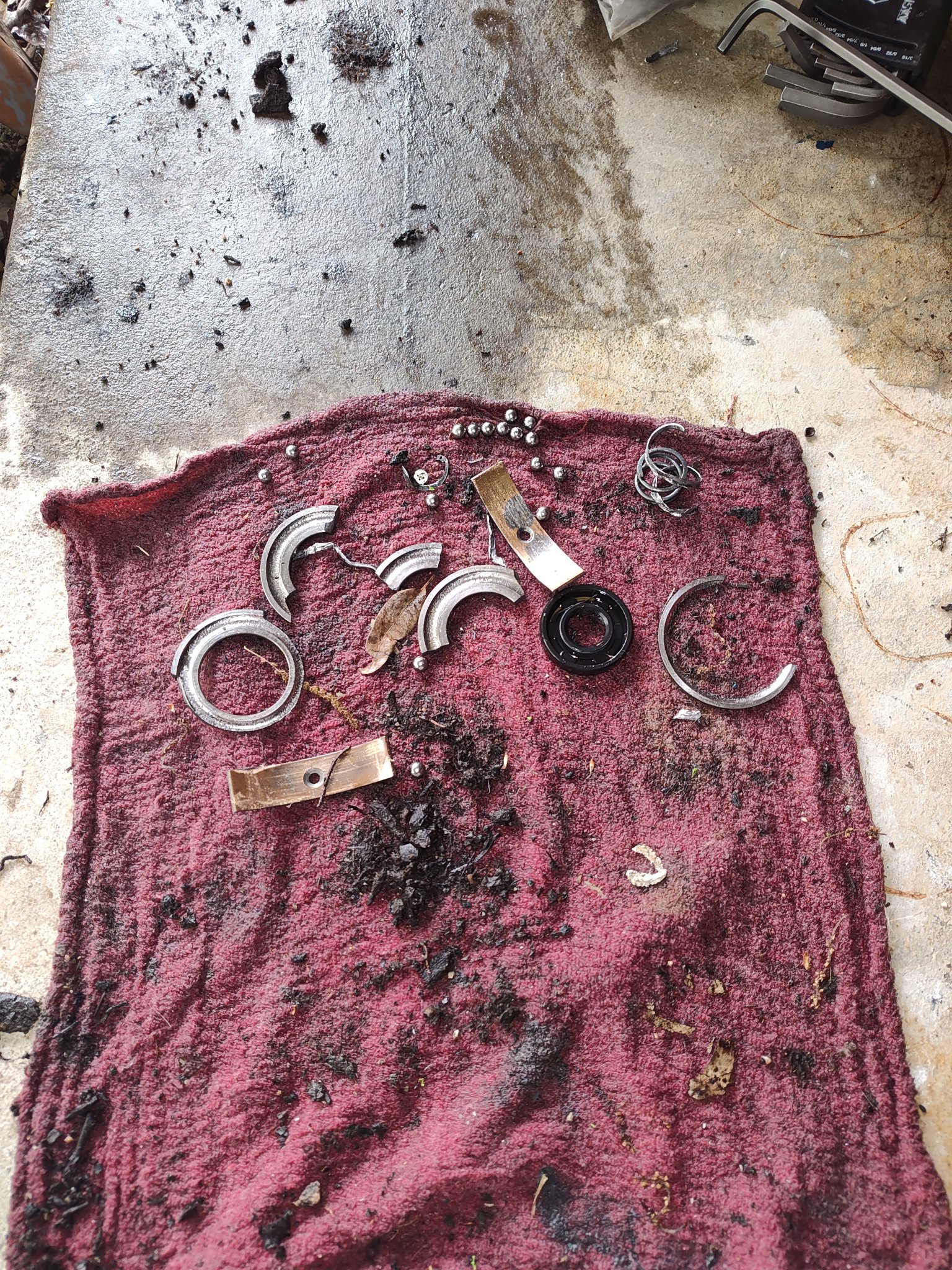

After disassembly I was greeted by the parts explosion below. It looks like the snap ring under the spring may have come loose and chewed up some parts. Luckily my pump, motor, and housing were not damaged. I had thought the only option was a total new hydro. But Messick's had all the parts in stock to repair and I only dropped $153. total to get back up and running. About two hours to rebuild the hydro and an hour to reassemble the mower.
