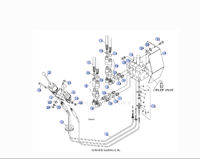

So showing my rookie understanding of the operation, you’re saying these are cables that operate the hydraulic valves and not fluid. So removing them to inspect and remove the water will not require draining fluid but probably entail lots of tedious small hardware/mechanical features? Or is it fairly simple process? I do have the drawings for the valve but never have taken any of it apart. Thanks for your knowledgable assessment!
31,695
7,488
Yes no fluid involved:
You can do a non disassembly troubleshooting of the cables if you have a heat gun to be able to heat the cable and see if full function returns.
