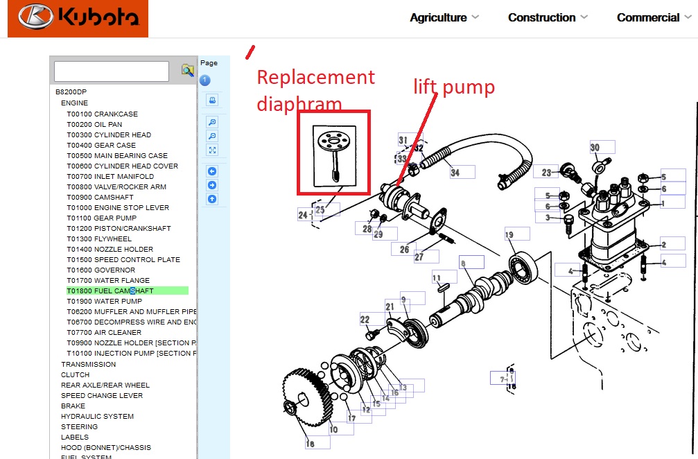

But, if its not coolant and its not hydraulic fluid and I didn't over fill it, that leaves diesel in the oil. How do I know if there's diesel in the oil and how do I go about finding that leak? ....searching OTT it looks like a leaking lift pump diaphragm could cause the issue. A new diaphragm from Messicks is $43 or a whole new pump from them is $170 and would be here who knows when. A whole new lift pump off amazon is $30 and would be here in two days. Any issue with trying out the Amazon pump?

The drained oil got dumped into the used oil bucket unfortunately and I'd like to avoid the time and hassle of sending a sample out and waiting for results.
Hopefully it will be easy to diagnose from here. If the oil continues to rise and the coolant and hydraulic fluids stay the same then it has to be the diesel if I didn't overfill the oil (I do dumb stuff like that on occasion). So I just ordered the cheap amazon pump because I need the tractor operational ASAP.
While I was surfing looking for answers, I saw these video's:
Maybe if the cheap amazon pump doesn't hold up I'll have to do something similar or pony up for the $170 OEM pump or $70 diaphragm.
