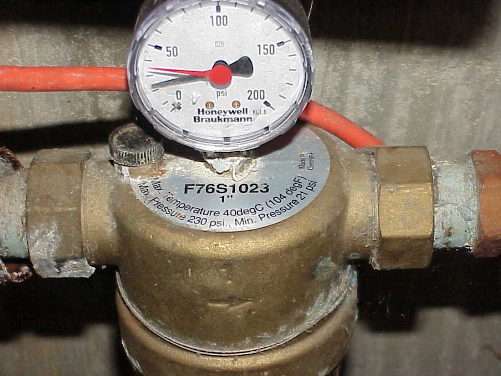

I installed a Braukmann sediment filter about 15 years ago and it is great at removing sediment from the water supply. I usually service it ever 3 or 4 months by shutting off the water pump power, unscrewing the plastic cartridge at the bottom of the filters metal top. I then bring it up to the kitchen faucet and empty out the sediment into a large pan, and fill the cartridge again with water from the faucet, and dump that into the pan. Then I disassemble the filter and flush the screen in the pan with the sediment and water until it is clean. Rinse the cartridge housing again and reassemble it and put it back together. There is a gauge at the top of the metal housing that you can set to the pressure of the water entering from the pump. I reset that to the current pump pressure and when I see that the pressure drops quite low I know that it is time to clean the filter again. When I first installed it there was so much sediment in the water that I was cleaning it every week. I changed the filter to a less micron setting and it reduced the amount of sediment that it was capturing. What gets past the filter is so little that I don't notice it except in the 1st floor toilet that collects the sediment in the tank. No sediment ever makes it to the second floor bathrooms. It is a Braukmann (3M company) model FS1023S1023. I bought mine off of eBay at the time.
Mine is a 1" model and the 3/4" model is Honeywell F76S1015, and the 1/2" is F76S1007 - Water Filter. Braukmann and Honeywell are both the same. Shop around for the best price. It is a once in a lifetime of your home purchase.
