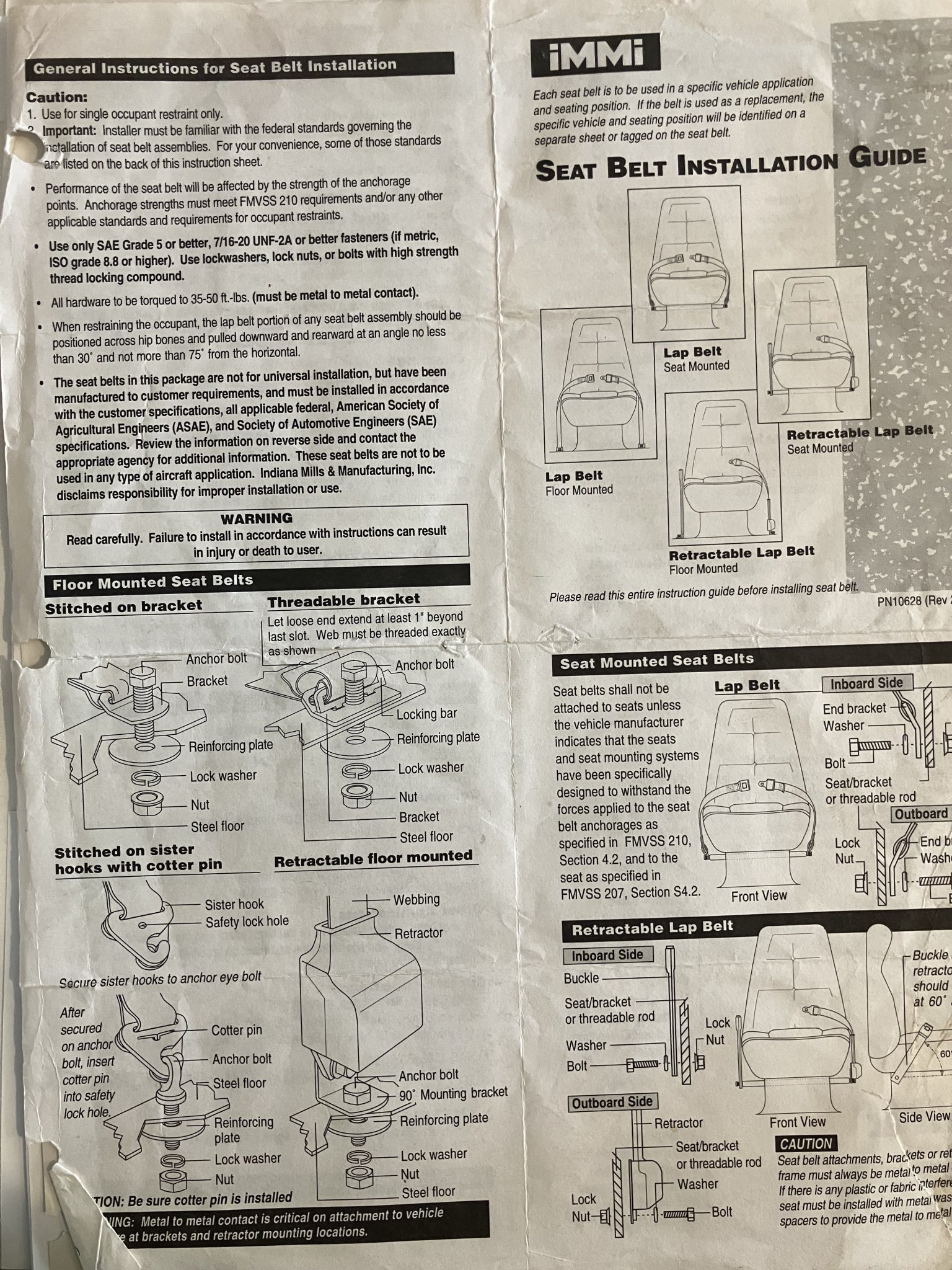

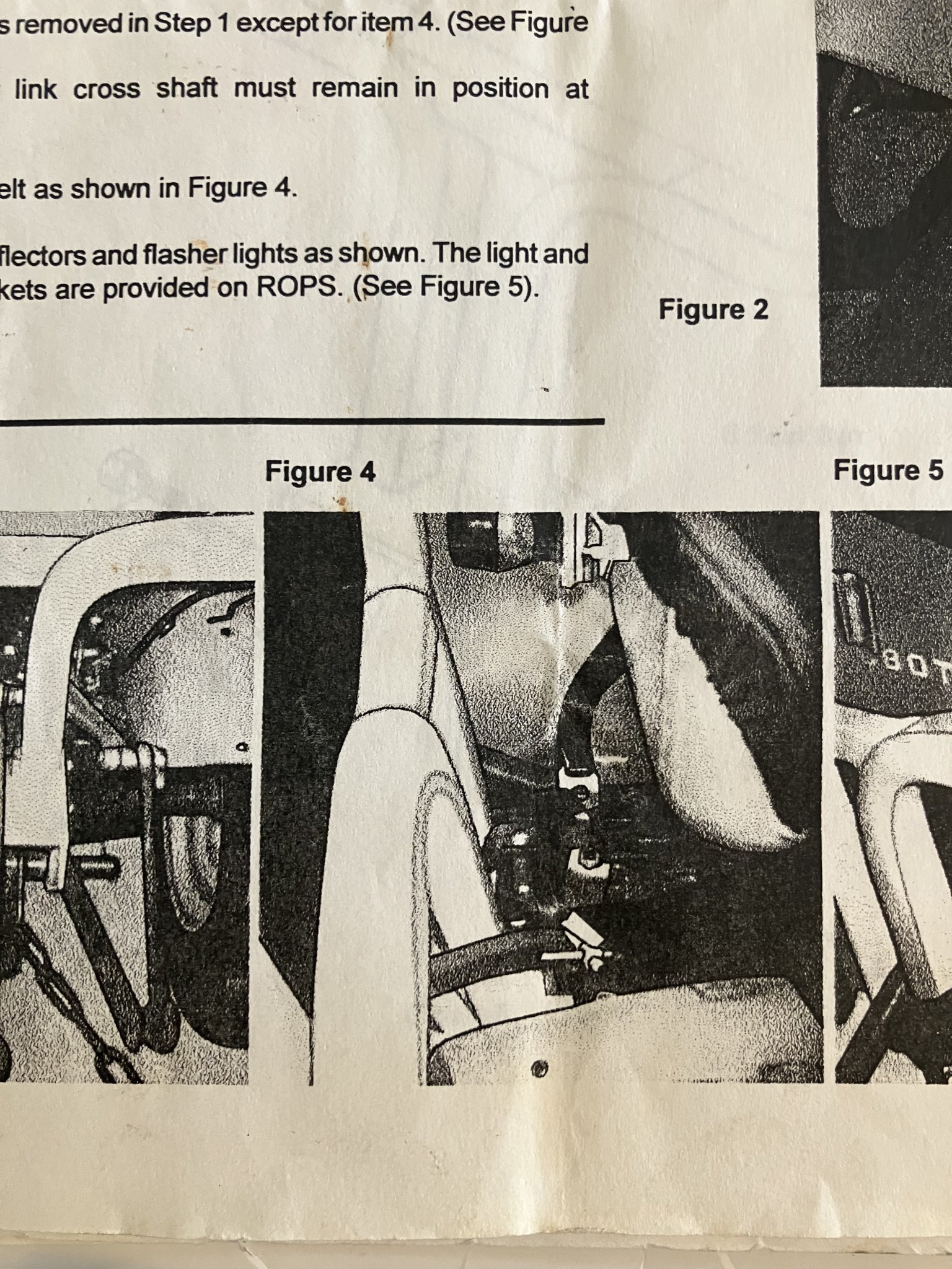

You may or not may have this information but I think ROPS and seat belts where installed at the dealer level on B7100's , at least in North America.
For information purposes I have the original instructions for the ROPS and belt installation, and a sheet from the belt supplier, which is very generic. While understanding your looking for a shoulder or 3pt belt I thought this maybe useful. I can take a good clear photo of my belt attachment points if needed.

View attachment 136005 View attachment 136006
Ken, Thanks very much. My 7100 has a new aftermarket seat that was installed when I bought it. No obvious Seatbelt attach points. I'm looking at your images and checking the actual tractor (right after the hailstorm stops ) :)

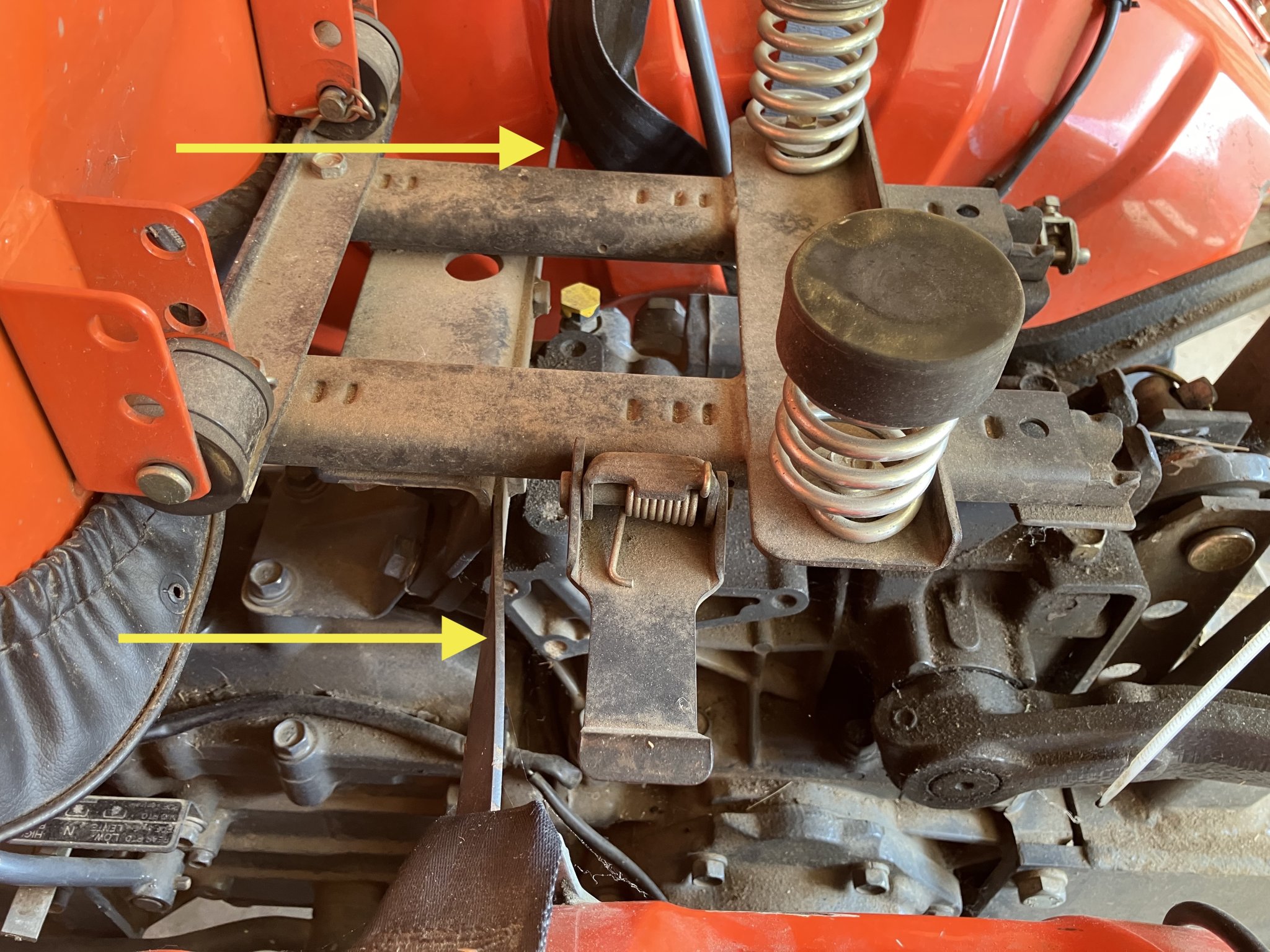

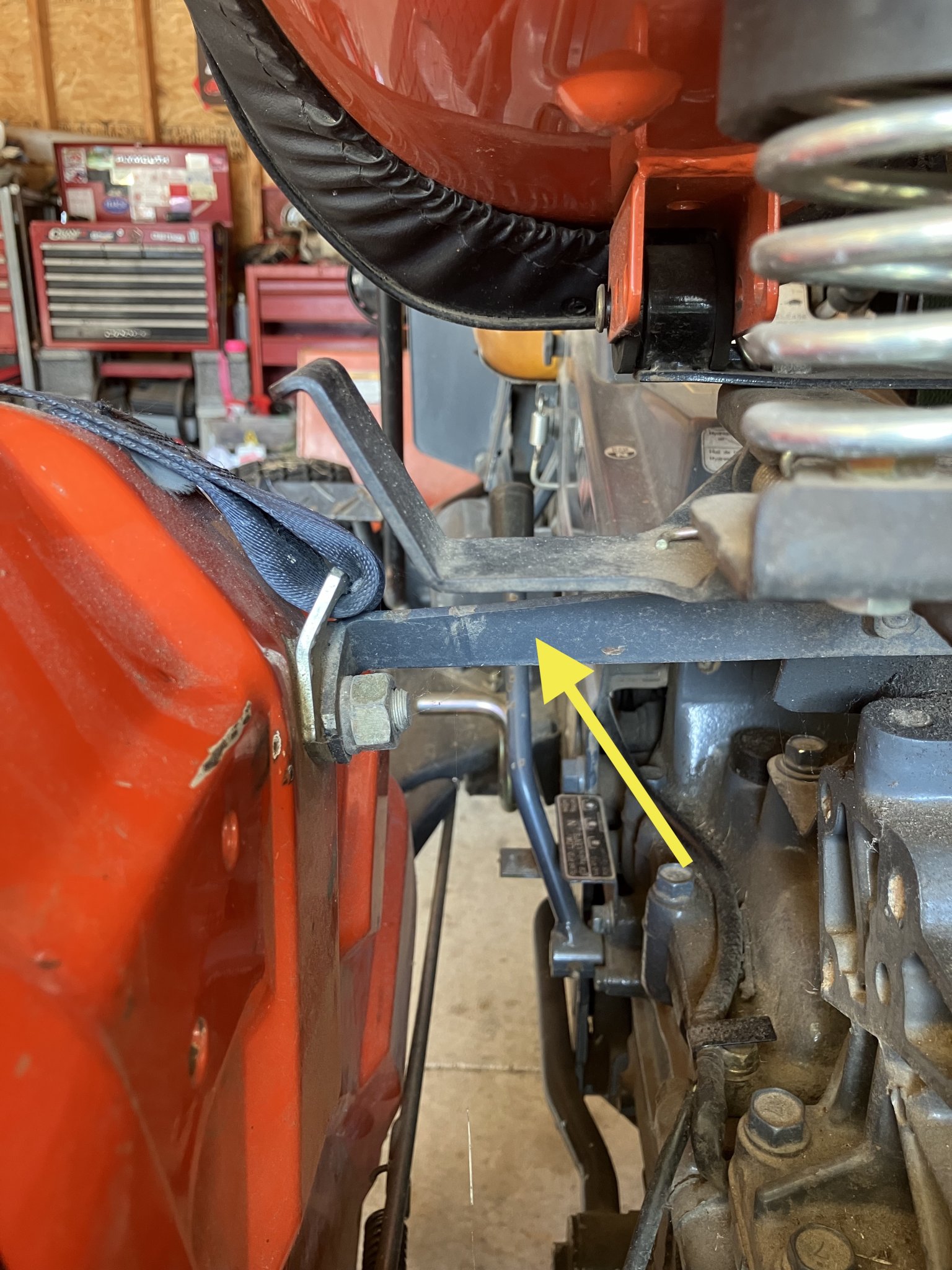

Terry,
I am headed out to my land to pick wild plums for jam making. As soon as I return this afternoon I will take some good quality pictures of the attachment points and hardware they used on mine.
