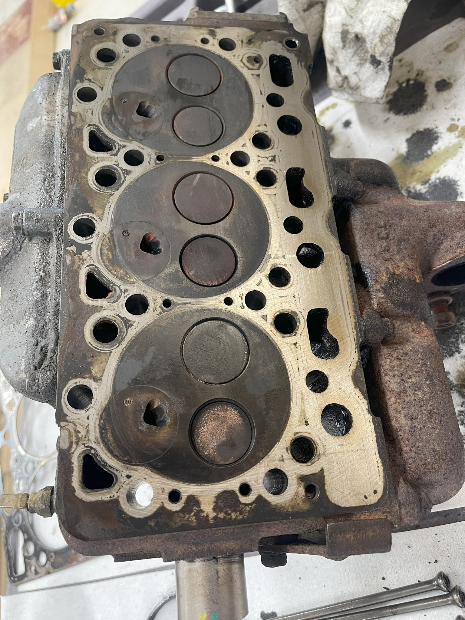

A little history on the machine. I got it not running, after pulling the valve cover I noticed the rocker arm for the rear cylinder was broken. I ordered a new rocker assembly off eBay, stuck it in, adjusted valves and it fired right up. Compression is decent at ~450 on all 3 cylinders. I ran it like this for a few months until it started spitting coolant out the overflow bottle, I figured it was a bad head gasket. I removed the head to find a bad head gasket, but also a recessed exhaust valve on the rear most cylinder, the same one that had broken the rocker arm, which makes sense now. My theory is that the valve seat recessed into the head, cause the valve stem to come up higher and snapped the rocker arm off.

P.S. you can see the recessed exhaust valve in the photo here.
