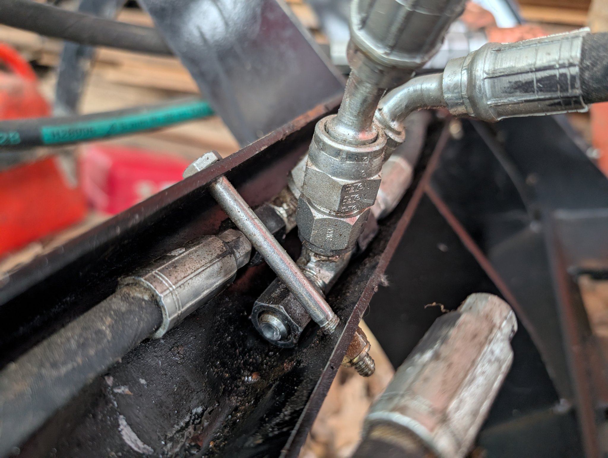

I have a SG0660 grapple that, due to some unfortunate actions during detachment (she says she's sorry) , a hydraulic hose and fitting have broken.
I have been on the Land's Pride site and found the parts....but there appears to be no way on that site to actually purchase them. Is there any other reliable source for Land's Pride parts?
Thanks.

Post pics of the carnage and we can help better!
Most NAPA's make hoses too.
Heh, ya, pics always make the story better. I added a pic of it to the initial post.
Basically, she undid the quick attach levers, but forgot to undo the hydraulic hoses.
After looking at it, I think the t-junction hydraulic fitting will be ok after i loosen the nut attached to it still...it's the hydraulic hose that goes to the left upper cylinder that has the end of its fitting snapped off into the junction.
I'll remove it tonight in prep for taking it into town tomorrow for a replacement.
