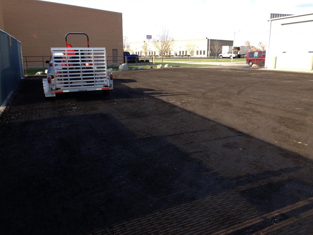

I have a BX2360, and have a a\Aluminum, single axle trailer, and pull it with my Ford Escape, and it hauls it like a dream. I have taken mine from Michigan to Illinois twice, no problem. One trip I had the loader, back blade, and snow blower on the trailer at one time.
It is a VanKam trailer made in Muskegon Michigan, I ordered the radial tires, that makes it pull better.
In my estimates, I am just under the plate, and trailer ratings.
This picture is just as I finished grading the lot at my industrial Bld.
