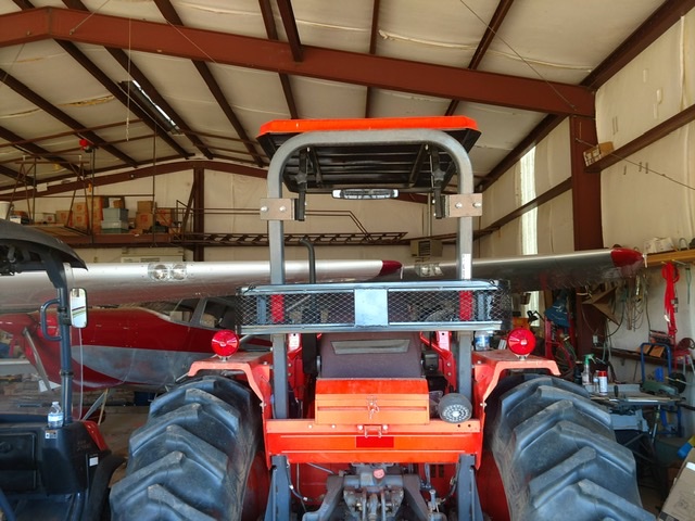

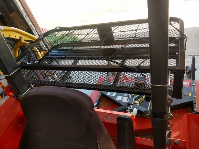

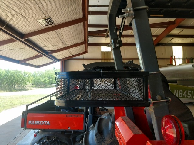

I simply took an ATV front rack and mounted it to my ROPS using (square-shaped) U-bolts

This is same as I have been considering to mount on our L2501 to haul chain saw, gas & oil, chain, etc. Any down side or problems you have found with your setup so far?
NOne at all…. and the basket prevents any items being thrown up by mowers, shredders, etc from getting to the operator.

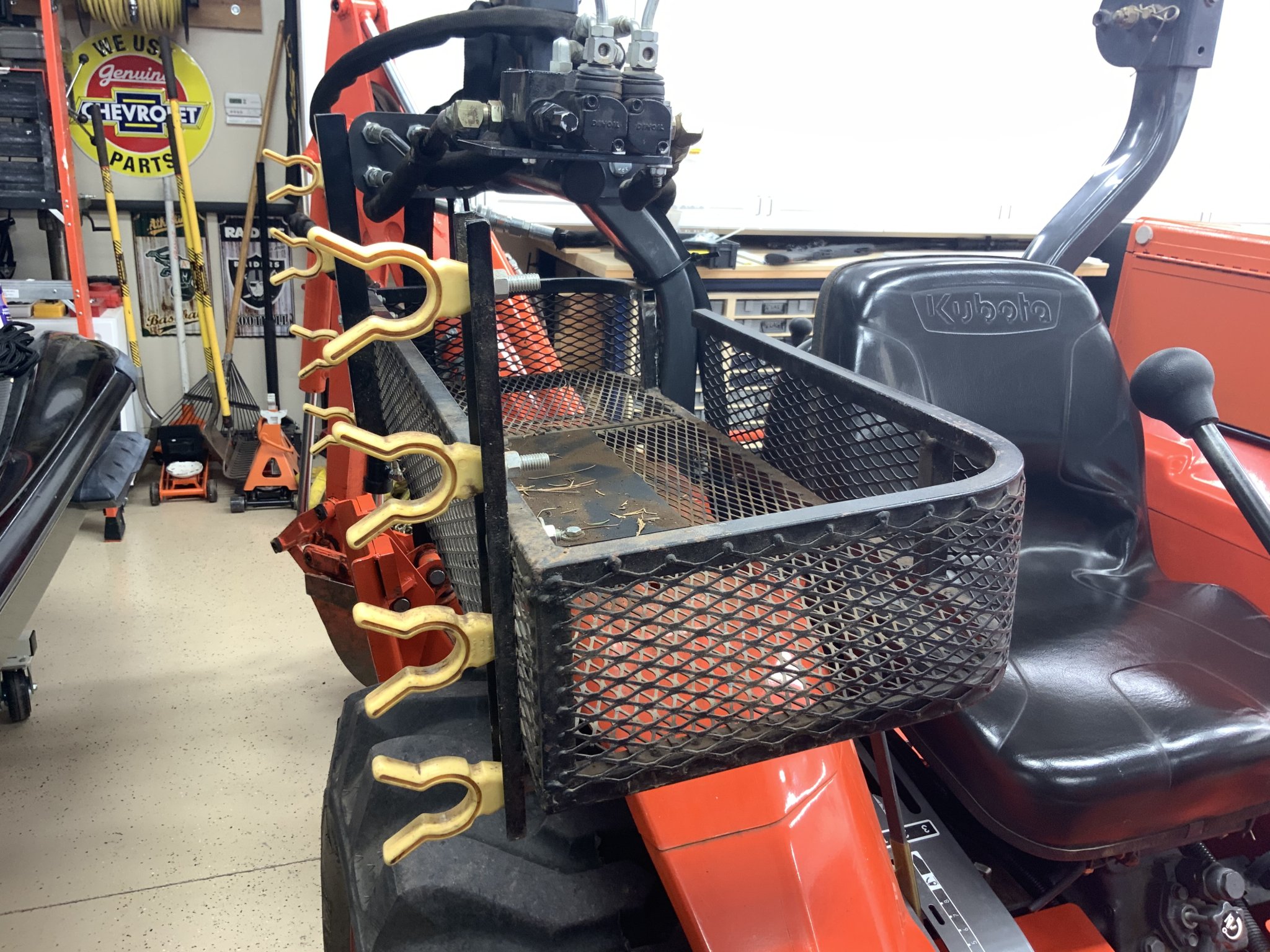

Here are mine.
Could you post a picture from the other side of your tractor with the shovels and such on it? There's alot going on there, and Im not sure Im seeing it clearly. Is there a basket mounted to the top of your fender with some vertical arms welded to that? Then it looks like your rear remotes are on a seperate bracket? Did you remove turn signals(if you had them)?
Thanks
I Made a custom basket that holds chain, gloves and stuff. The rack is welded to that.
