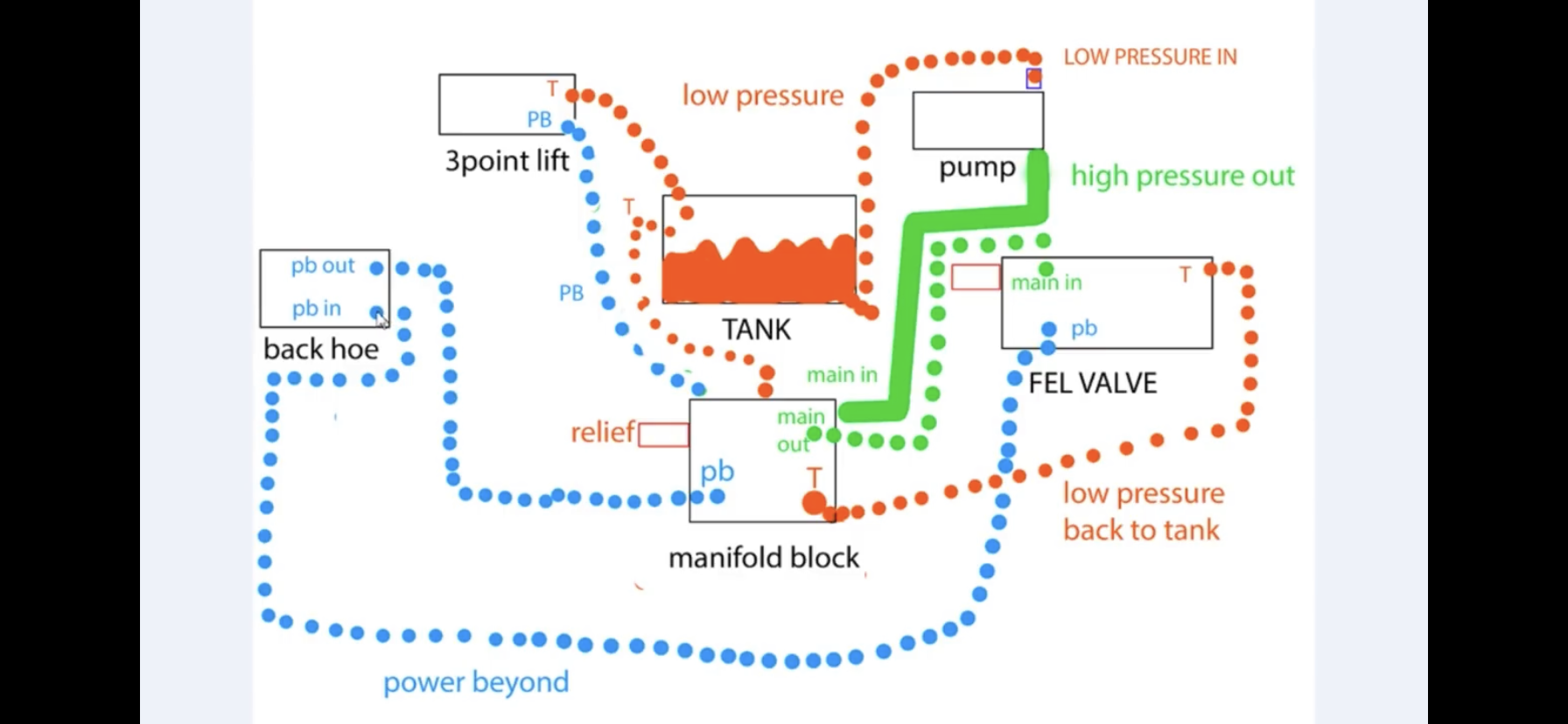

This is what I thought i could do.
Looks like I'm reviving a relatively old conversation, but I'm running into a similar situation with my Grand L and wondering if I could add the backhoe plumbing to run the spade (Vermeer TS3300 on the 3 point) or if I should go off of a rear remote. This is temporary until I get a skid steer in the next few years.

Backhoe stylw plumbing. It dies not have to be factory of pretty.
