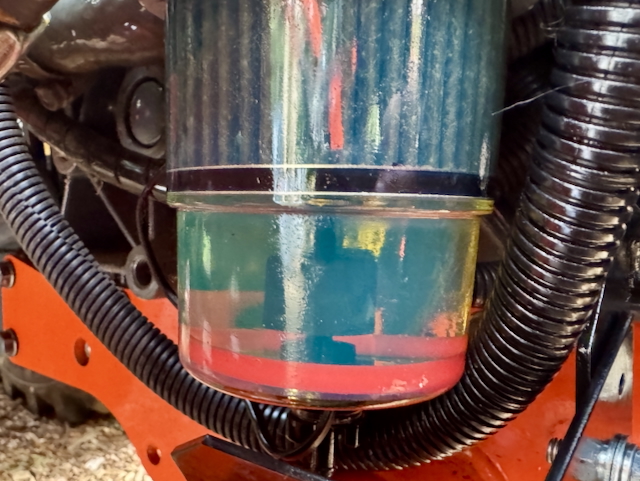

The water separator indicator on my LX3310 is floating at an angle (see pic). I've drained it several times and as the fuel fills up the cup it returns to an angle. My understanding is if there is water it should float level. The Water Separator warning light does not illuminate and the tractor runs fine. I've never seen it float before.

Bad ring, it has water or more likely and air bubble trapped in it.

Thank you and I'm pretty sure you're right. I took my excavator water separator off and put the fuel that was in the tractor water separator into it. The ring did not float.

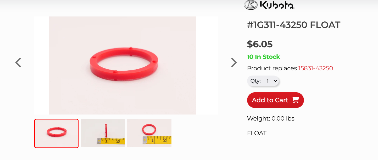

Will you be able to get a new ring? I looked at Kubota parts and didn’t see it in the components section which seemed odd to me.

#50 is actually this float
They do not list the ring separately?

New float arrived. Not as thick as the one the tractor came with. I put the new one in with the existing fuel and it behaves properly.
