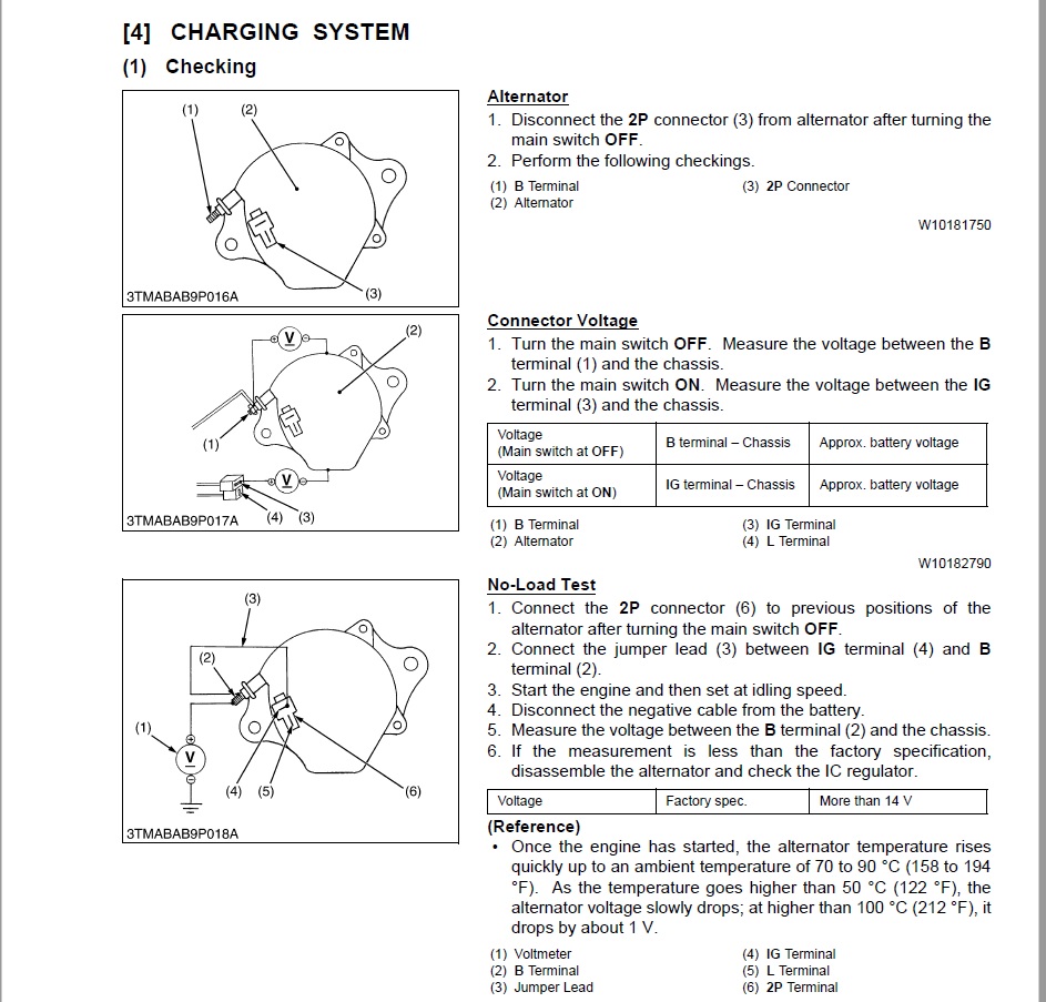

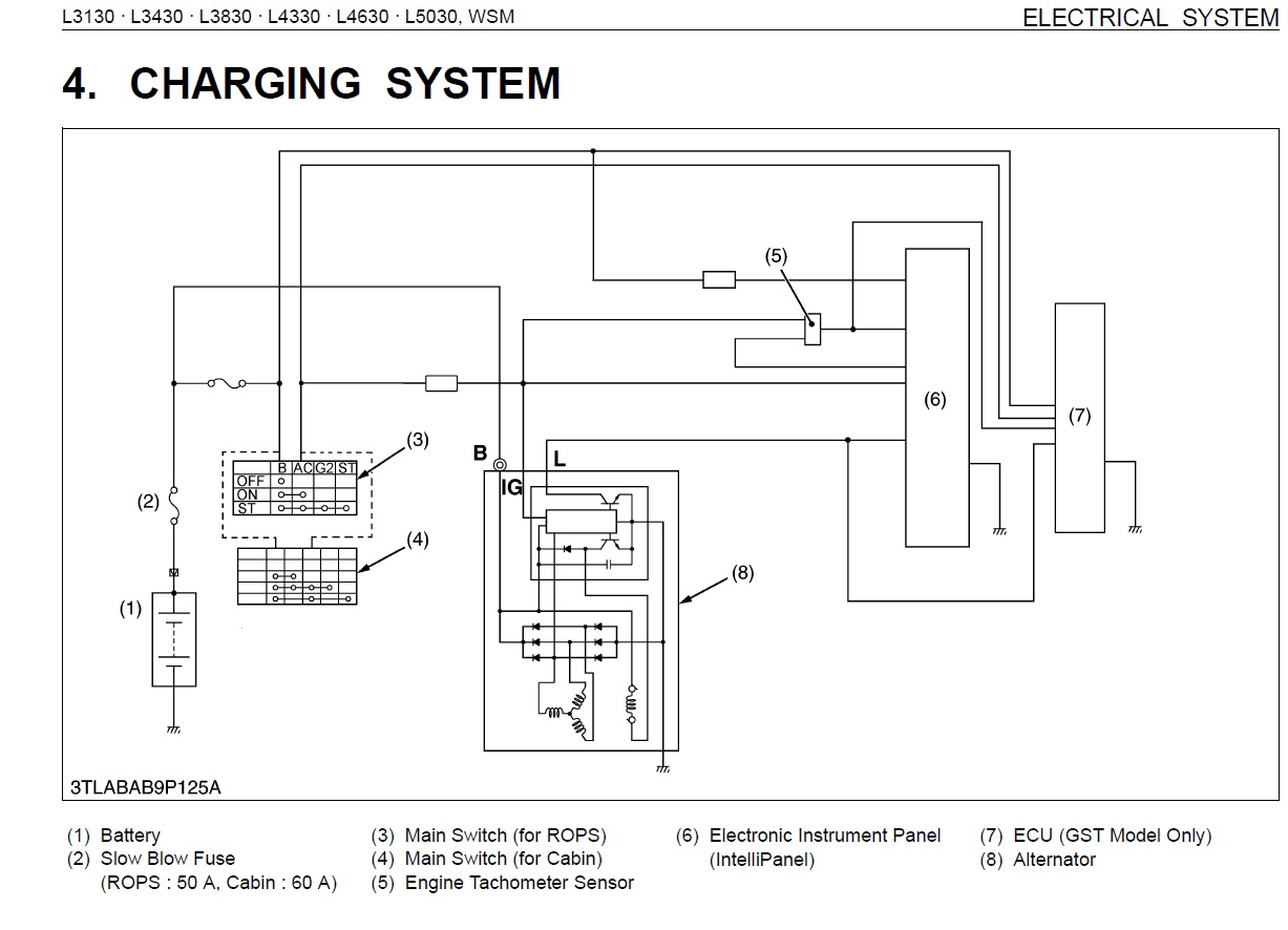

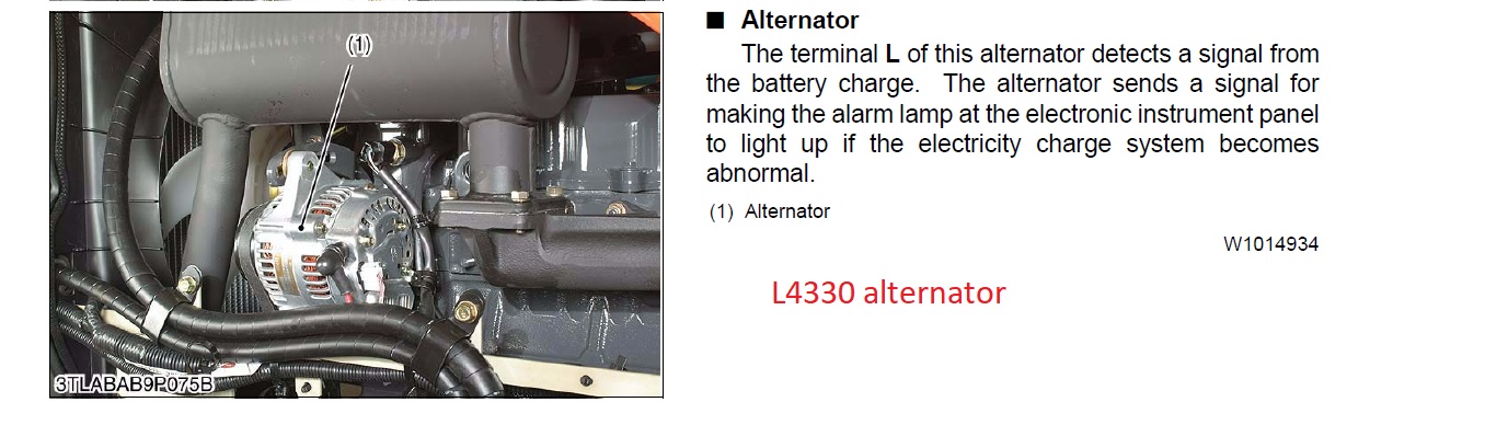

Read the reference material I have attached for your charging system.
Regulator is internal to the alternator.
