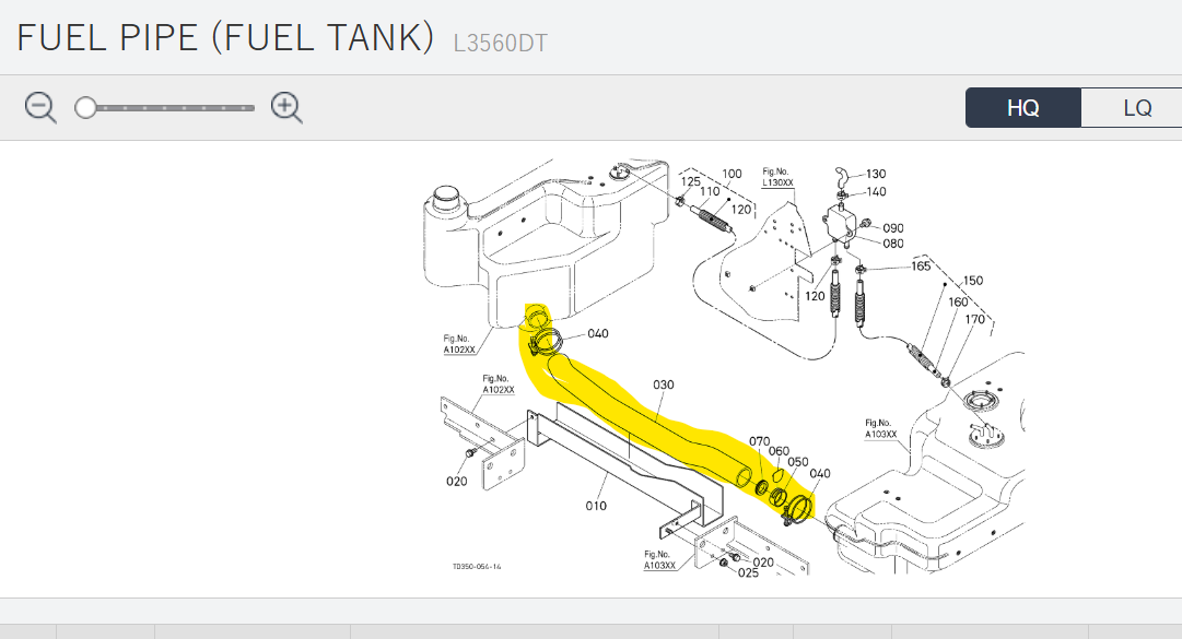

First time poster here. I have a 2020 L3560 with 200hrs. Occasionally the machine starves for fuel (seems to happen more with <1/4 tank). It tries to run but dies. Ive replaced the fuel filters and emptied my separator without luck.
The only thing that works is loosening the fuel cap and taking the line off the separator and blowing air back into the line until I can hear bubbling in the tank. From there it may run for a week or a hour. Not sure if there is a filter/sock in the tank, but that seems to be where my clog is. Curious if I should drain/flush the tank (not sure if there is even a drain plug). Also, not sure if my “clog” would even loosen up by pouring in fresh diesel/re-draining.
Im trying to avoid taking it to the dealer to drop the tank, etc. All suggestions would be greatly appreciated!

Something is blocking the fuel pick up line in the tank. You have a couple of choices depending on your ability to tackle the repair yourself or pay the dealer a lot of $$$$ to fix the problem (notice the 4 dollar signs!). This is what I would do if it were my tractor, but not being familiar with your tractor, I don't know if this will work.

Sure sound to me like you have found the problem.
If it were me, I would take the tank off and clean it out real well.
I would probably replace the fuel line from tank to filter, just to eliminate the possibility of it being the problem from "breaking down" (cheap insurance)
